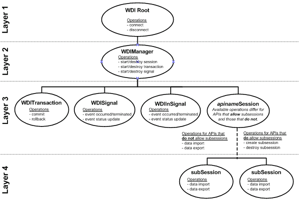

Unlike traditional APIs, the MetaSolv Solution APIs are not packaged as object code or libraries. Instead, the API is delivered as a set of CORBA Interface Definition Language (IDL) files that are installed when the MetaSolv Solution Application Server is installed. CORBA implementation vendors supply IDL compilers that use these IDL files to generate language bindings for the desired implementation language (for example, Java or C++) and platform (for example, Windows NT or Oracle Solaris).
Figure 2-1 shows the API object architecture, which follows a layered, hierarchical approach. The interfaces at each layer support operations that yield object references to interfaces in the immediate subordinate layer (if any).
Figure 2-1 MetaSolv Solution API Design Architecture
The highest layer contains the Root interface, WDIRoot, which manages connections from client applications.
The second layer contains the Manager interface, WDIManager, that provides operations for session, transaction and signal management.
The third layer contains the various session interfaces. Typically, the operations that an external application is interested in are in the session interfaces. For example, operations that allow data export or import. However, some APIs are designed with a fourth layer. In these APIs, the session interface in the third layer provides operations that yield object references to interfaces in the fourth layer.

Table 2-6 Outbound Gateway Event Operations Required For All APIs
Interface Operations Remarks
WDIRoot connect A client requests to establish a connection.
WDIRoot disconnect MetaSolv Solution requests to destroy the connection.
WDIManager startSignal MetaSolv Solution indicates start of signal. Your application generates a WDIEvent instance.
WDIManager destroySignal MetaSolv Solution indicates end of signal.
WDISignal eventOccurred MetaSolv Solution indicates the occurrence of an event within the Work Management subsystem and passes the data payload.
WDISignal eventTerminated MetaSolv Solution indicates the user opted to bypass processing for this event. This indicates that your application is to stop processing this event.

Inbound Signals
MetaSolv Solution enables you to define gateway events as inbound. Inbound signals are the means by which the status of such gateway events may be updated by your application. In contrast to the implementation for outbound signals, where your application is a CORBA server, the implementation for handling inbound signals follows the CORBA client pattern.
The data payload carried by inbound signals is defined in WDI.IDL, reproduced as follows.
struct WDIInEvent
    string gatewayName;
    string eventName;
    long   documentNumber;
    long   servItemID;
    char   updateMany;
    string userID;
The signaling operations are defined in the WDIInSignal interface in WDI.IDL, reproduced as follows.
interface WDIInSignal
    WDIStatus eventInProgress(in WDITransaction aWDITransaction,
        in WDIInEvent aWDIInEvent);
    WDIStatus   eventCompleted(in WDITransaction aWDITransaction,
WDIStatus   eventErrored(in WDITransaction aWDITransaction,
        in WDIInEvent aWDIInEvent, in WDIErrSeq aWDIErrSeq);
Your implementation for handling inbound signals is no different from the invocation of a synchronous operation on the MetaSolv Solution Application Server.
