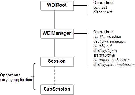

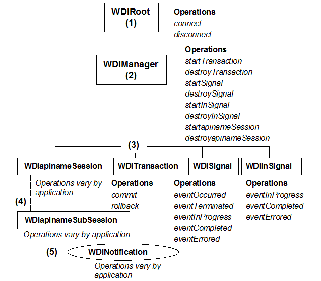

Common IDL Architecture Interfaces
Figure 3-1 shows the common interfaces of the Oracle Communications MetaSolv Solution APIs.
Figure 3-1 Common IDL Architecture Interfaces
Table 3-1 lists the keys for common IDL architecture interfaces.
Table 3-1 Keys for Common IDL Architecture Interfaces
Key Architecture Description
(1) At the highest level is the WDIRoot interface, which enables connection management. The WDIRoot layer provides services that are used throughout the architecture and serve as the connection factory. See WDIRoot Interface for more information.
(2) The second level is the WDIManager interface, which enables session, signal, and transaction management. The WDIManager object reference is obtained from a successful connect to the WDIRoot. The connection operation of the WDIRoot object returns an object reference to a WDIManager. WDIManager provides services to start and destroy transaction objects, signal objects, and session objects.
(3) The third level contains the session, signal, and transaction interfaces, whose object references are obtained from the WDIManager interface. See Figure 3-4 for more information.
(4) The optional fourth level contains the more granular subSession object whose object reference is obtained from the parent session interface. Refer to the sample flows presented in each API chapter for examples.
(5) The API architecture defines a callback mechanism that is exposed by the WDINotification interface.
The session or subSession enables access to business application operations. These operations are detailed business objects that vary by the business functions exposed.
MetaSolv Solution APIs do not necessarily require every interface defined in this document.

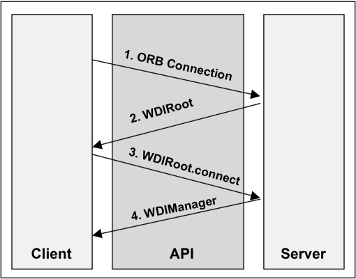

Connection to the Root Object
Figure 3-3 illustrates the connection process.
Table 3-2 lists the operations exposed by the WDIRoot interface.
Table 3-2 WDIRoot Interface Operations
Operation Name Description
connect Returns a reference to WDIManager
disconnect Terminates the connection

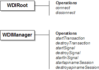

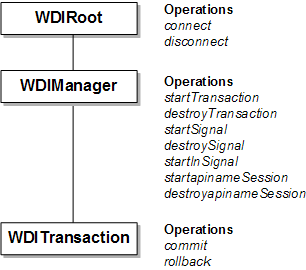

WDIManager Interface
The object reference to the WDIManager is obtained by initiating the connect operation of the WDIRoot interface, as shown in Figure 3-4.
Figure 3-4 WDIManager Interface
Table 3-3 lists the operations exposed by the WDIManager interface.
Table 3-3 WDIManager Interface Operations
Operation Description
startapinameSession Obtains the object reference of the apinameSession where apiname designates the specific API.
destroyapinameSession Terminates the established session.
startTransaction
Establishes a database connection using this process:
The Start operation makes the connection and establishes a database transaction object.
The API returns a handle for that connection to the initiating process. The term, handle, is synonymous with a WDITransaction object reference.
destroyTransaction Invalidates a database transaction object. Any pending changes are lost when this function is called if it was not preceded by a commit.
startSignal Obtains the WDISignal object reference.
destroySignal Terminates the Signal.
startInSignal Obtains the WDI Insignal object reference.
destroyInSignal Terminates the Insignal.
Some APIs do not define startSignal, destroySignal, startInSignal, destroyInSignal, startTransaction, or destroyTransaction. For details about a specific API, see the chapter of this guide that describes that API.
API Session Interfaces (Session Processing)
The object reference to the apinameSession is obtained by initiating the startapinameSession operation of the WDIManager, as shown in Figure 3-5.
Figure 3-5 Basic Session Interface
Operations in sessions and sub sessions vary according to the API.
WDITransaction Interface (Database Transactions)
The object reference to the WDITransaction is obtained by initiating the startTransaction operation of the WDIManager interface. Third-parties can use the API to coordinate the database transactions because no assumed paths or commit points are built into the API. Commit and rollback are operations of the WDITransaction interface.
Figure 3-6 shows the WDITransaction interface.
Figure 3-6 WDITransaction Interface
The commit operation uses a database handle and saves any pending changes to the database. Once a commit has occurred, all database updates are applied to the database. After a commit, the transaction object is still valid and can continue to be used.
The rollback operation uses a database handle and rolls back any pending changes to the database. Once a rollback has occurred, any pending database changes are discarded. After a rollback, the transaction object is no longer valid and cannot be used for further operations.
In APIs that use the commit and rollback operations, your application must specifically call commit and rollback. However, some APIs do not use the WDITransaction interface. In these cases, MetaSolv Solution is responsible for database transaction management.

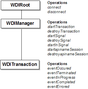

WDISignal Interface (Outbound Signal Processing)
The object reference to the WDISignal is obtained by initiating the startSignal operation of the WDIManager interface.
If the signal is a gateway event signal, certain key data as defined in the WDIEvent structure (in the IDL) is passed. If the signal is an application event signal, the data to be passed varies, depending on the application.
The third party is responsible for implementing the eventOccurred and eventTerminated operations of the WDISignal interface. MetaSolv Solution is responsible for implementing the remaining operations of the WDISignal interface.
Figure 3-7 shows the WDISignal interfaces.
Figure 3-7 WDISignal Interfaces
Table 3-4 lists the operations exposed by the WDISignal interface.
Table 3-4 WDISignal Interface Operations
eventOccurred MetaSolv Solution initiates a signal indicating that a gateway event of interest to the third-party software has occurred.
eventTerminated MetaSolv Solution terminates an event to notify the third-party application that MetaSolv Solution is no longer interested in completing the event and is no longer interested in receiving status updates for the event.
eventInProgress The third-party application sets the status of the gateway event to In Progress when it has received and begun processing the signal.
eventCompleted The third-party application sets the status of a gateway event to Completed when it has successfully finished processing the event.
eventErrored The third-party application sets the status of the gateway event to Error when an error has occurred while processing the event. This operation also provides a mechanism for error information to be communicated to the API.

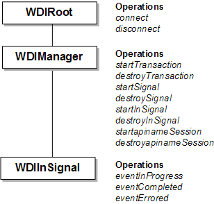

WDIInSignal Interface (Inbound Signal Processing)
The object reference to the WDIInSignal is obtained by initiating the startInSignal operation of the WDIManager interface. The WDIInSignal interface allows the third-party application to update statuses of unsolicited or inbound gateway events in the Work Management subsystem. This is illustrated in Figure 3-7.
Figure 3-8 WDIInSignal Interfaces
Table 3-5 lists the operations exposed by the WDIInSignal interface.
Table 3-5 WDIInSignal Interface Operations
eventInProgress The third-party application sets the status of a gateway event to In Progress when it has started processing an event.
eventCompleted The third-party application sets the status of a gateway event to Completed when it has successfully finished processing an event.
eventErrored The third-party application sets the status of a gateway event to Error when an error has occurred while processing an event.

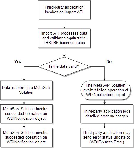

The WDINotification interface has operations defined indicating the success or failure of an invoked operation. The parameters of the WDINotification interface include a reference (which varies by application) and an error structure where appropriate. The third-party application is responsible for implementing the operations in the WDINotification interface.
If an error is encountered during the processing of an API object implementation, a callback is performed to the third-party application indicating that the operation has failed and why the operation failed. The reasons for the failure are communicated by an error structure (WDIErrSeq), which may contain multiple, detailed error messages. Different errors can be encountered while attempting to process a given request, as shown in Figure 3-9.
Figure 3-9 Sample Flow for Successful and Error Conditions
Displaying errors is the responsibility of the third-party application because the third-party application functionality and error processing differs among software package. The API provides a mechanism for errors to be communicated back to the Work Management subsystem through the eventErrored operation of the WDISignal interface. MetaSolv Solution invokes the failed operation of the WDINotification interface.
The third-party application is responsible for logging the errors and making them available to the user. Typically, this means the data displays to the user. The third-party application may optionally communicate this error information back to MetaSolv Solution through the error status update for an event.
