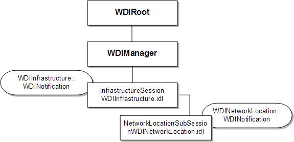

Infrastructure Interface
Figure 4-1 shows the relationship of the interfaces within the Infrastructure API.
Figure 4-1 Infrastructure API Interfaces
WDIManager

NetworkLocationSubSession
The NetworkLocationSubSession is a subsession in the Infrastructure API that manages network location database transactions in the Infrastructure subsystem.
The NetworkLocationSubSession includes the following functionality described in detail in later sections:
  • Associate and disassociate location relationships with a network location
  • Associate and disassociate network areas from an end-user location
  • Associate and disassociate tandem types from a network location
  • Disassociate Secondary LSO's from an end-user location.
  • Query, create, update and delete end-user locations
  • Query, create, update and delete network locations
  • Query network areas
The NetworkLocationSubSession interacts solely with the Infrastructure server which is responsible for commit and rollback functionality. The WDITransaction parameter is not a part of any operation used within this API. Prior operations that used the WDITransaction parameter are deprecated and replaced with new versioned operations.
