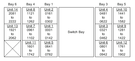

Sequential Port Address Numbering
You can define a sequential numbering scheme for mounting positions on an equipment specification in order to number ports sequentially across cards in a shelf. You can use this automated numbering method, instead of hard and soft node address overrides, when working with multiple shelves of a DCS system where sequential numbering is applied to all ports of a given rate code. As with hard and soft node address overrides, the sequential numbering scheme you define replaces the concatenated node address.
Each shelf using sequential numbering is identified by a unique combination of unit number, unit extension, and network element location ID. The unit number identifies a piece or multiple pieces of equipment that contain cards. Every unit associated with a network element has a unique unit number and unit extension identifier. If the unit contains one shelf, that shelf has a unique unit number and a unit extension of zero.
For example, each of the 16 shelves in a Lucent DACSII Capacity Expansion Frame has a unique unit number between one and 16 and has a unit extension of zero. If the unit contains a group of shelves, each shelf in the group has the same unit number with a unique unit extension. Therefore, each of the four ATM shelves in a Lucent DACSII Single Bay has the same unit number with a unique unit extension. The first shelf is unit number one, unit extension one. The second shelf is unit number one, unit extension two, and so on.
The numbering sequence for card ports installed in a shelf's mounting positions is independent of the bay in which the unit is installed and independent of the order in which the units are installed. Thus, you can install Unit 5 in Bay 1 before you install Unit 4 in Bay 3 without affecting the numbering of the ports. Figure 5-1 illustrates sequential numbering of port addresses for DSPU cards in a Lucent DACSII.
Figure 5-1 Example of Sequential Numbering of Port Addresses
The sequential numbering scheme for a DCS shelf is defined on the equipment specification. You can create a variety of sequential numbering schemes, including straight sequential (with or without channel assignments) and sequential with augmentation. Upon installation of the shelf, you can disable numbering for selected ports by checking the Disable PA check box in the MetaSolv Solution Equipment window - Mounting Positions tab to create a sequential with skipped numbers scheme. Once the shelf is installed and a unit number and unit extension are defined, you cannot edit the sequential numbering scheme unless you uninstall the shelf. If a shelf is installed without a unit number and unit extension, and you add a numbering scheme to the equipment specification, the numbering scheme is not copied to the installed shelf unless you assign a unit number and unit extension and associate the shelf with a network element.

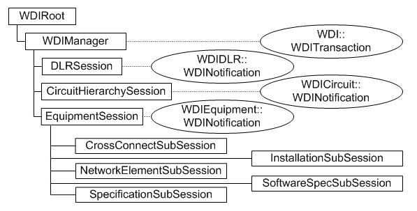

ICM API Interfaces
Figure 5-2 shows the relationships of the modules and interfaces in the ICM API.
WDIManager Interface
Table 5-1 lists the operations available in the WDIManager interface of the WDIDLR.idl file.
Table 5-1 WDIManager Interface Operations

EquipmentSession Interface Operations
Table 5-3 lists the operations available in the EquipmentSession interface of the WDIEquipment.idl file.
Table 5-3 EquipmentSession WDINotification Operations
Operation Description
destroyCrossConnectSubSession Terminates the CrossConnectSubSession.
destroyInstallationSubSession Terminates the InstallationSubSession.
destroyNetworkElementSubSession Terminates the NetworkElementSubSession.
destroySoftwareSpecSubSession Terminates the SoftwareSpecSubSession.
destroySpecificationSubSession Terminates the SpecificationSubSession.
startCrossConnectSubSession Obtains the CrossConnectSubSession object reference.
startInstallationSubSession Obtains the InstallSubSession object reference.
startNetworkElementSubSession Obtains the NetworkElementSubSession object reference.
startSoftwareSpecSubSession Obtains the SoftwareSpecSubSession object reference.
startSpecificationSubSession Obtains the SpecificationSubSession object reference.

CrossConnectSubSession Interface Operations
The CrossConnectSubSession interface exposes operations for installing and querying on hardwired and software cross connects. Table 5-7 lists the operations and their corresponding WDINotification operations available in the CrossConnectSubSession interface of the WDICircuit.idl file. These operations reproduce the same type of functionality as the corresponding function of MetaSolv Solution. All failed operations in the CrossConnectSubSession interface are reported through the generic operationFailed notification.

Any given piece of equipment can have four different type of port addresses:
  • Port Addresses (PA)
  • Enabled Port Addresses (EPA)
  • Port Address Placeholders (PAPH)
  • Virtual Enabled Port Addresses (VEPA)
In the CrossConnectSubSession, each of those four types of port addresses is considered a section. Hard-wired cross connections are made only for the ports belonging to a section at a time. The ICM API requires that all ports in the sequence be of the same type: PA, EPA, VEPA, or PAPH. Each section can repeat more than once, but intermingling of ports from different sections is not allowed. However, the FROM side port address type can be different from the TO side port address type.
For example, for two sets of starting port address numbers for cross connection on the FROM side, you specify [32, 20] and [102, 50]. For the corresponding TO side port addresses for connection, you specify [76, 20] and [210, 50]. The cross-connection process builds a FROM side list of 20 assignable ports for cross-connection starting from port 32, in ascending port order sequence, then builds a TO side list of 20 assignable ports starting from port number 76. Once both the FROM and TO lists are ready, the ICM API attempts the requested cross-connects.
Formats for Specifying FROM Side Port Addresses
FROM port addresses for hardwired cross-connects are specified in one of three formats. The FROM and TO side formats are independent, and any format on the FROM side can be combined with format case on the TO side.
  • All ports format
    The request is for cross-connecting all the ports on the FROM side equipment, starting from the first port on the FROM side. In this case the PortAddrSeqFrom has no entry.
  • Specified range format
    The request is for cross-connecting a range of ports on the FROM side equipment. In this case, PortAddrSeqFrom has the range of ports for cross-connection. portAddrSeqStart contains the value of first port address of the range. nbrOfPorts specifies the number of ports to be cross-connected, starting from the port identified in portAddrSeqStart. For example, to cross-connect 100 ports from port number 132, specify [132,100]. To cross-connect an additional range of 50 ports starting from port number 760, follow the entry of [132,100] with a second entry of [760, 50].
    In the example, if you specify 0 (zero) as the brOfPorts, that is, you specify [132,0], the operation connects all ports starting with port number 132.
    The range of specified ports cannot span across sections. To illustrate this using the preceding preceding example, assume that port number 132 is an Enabled Port Address (EPA). If port number 150 is NOT an EPA, the API gives a validation error. For all ports in a range to be cross-connected, all of the ports must be in the same section.
  • Specified list of ports format
    The request is for cross-connecting a list of ports on the FROM side equipment. This situation can be treated as a special situation of the specified range format. In this case, the PortAddrSeqFrom has the list of ports for cross-connection. Each portAddrSeqStart contains the value of the port address to be cross-connected and the nbrOfPorts has a value of 1.

NetworkElementSubSession Interface Operations
Table 5-8 lists the operations and their corresponding WDINotification operations available in the NetworkElementSubSession interface of the WDIEquipment.idl file. These operations reproduce the same type of functionality as the corresponding function of MetaSolv Solution. All failed operations in the NetworkElementSubSession interface are reported through the generic operationFailed notification.

DLRSession Interface Operations
Table 5-9 lists the operations available in the DLRSession interface of the WDIDLR.idl file. These operations reproduce the same type of functionality as the corresponding function of MetaSolv Solution.
