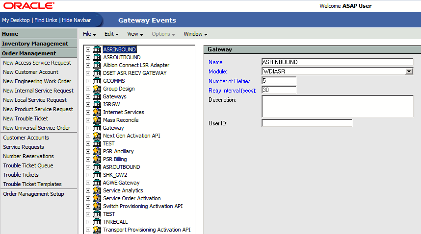

Defining a Gateway
The way you define a gateway in MSS enables you to trigger events from the middle-tier server and define multiple bind locations.
Figure C-1 shows the Gateway Events window.
Figure C-1 Gateway Events Window
The Gateway Events window contains the following fields:
  • Number of Retries: When a standard gateway event is in Sending status, the middle-tier event server attempts to trigger the event to the third-party application. If the event cannot trigger, a retry process is started. This field indicates how many times a triggering event is retried before the event is marked in error. The default is five.
  • Retry Interval (secs): This field indicates the delay before trying to resend an event. This time interval is designed to enable the third-party application time to recover. The default is 30 seconds.
  • User ID: This field is required to connect to the third-party application. This field allows one user ID for all connections to the third-party application. This User ID field was added because the middle-tier event server does not have the user ID and password of the user who initiated the event or the definition of every MetaSolv Solution user in the third-party application. The only impact to third-party applications is if they used this user ID for identification of the person initiating the event, this user ID needs to change to the user ID contained within the WDIEvent occurred structure sent with the event (see below). This user ID contains the identification of the actual user who initiated the event. See the code sample below:

    During the upgrade new data is created and the values are used as defaults. If the defaults need to change, each gateway can be edited using the Gateway Events window. The defaults are:
    • Number of Retries: 5
    • Retry Interval (secs): 30
    • UserID: Default

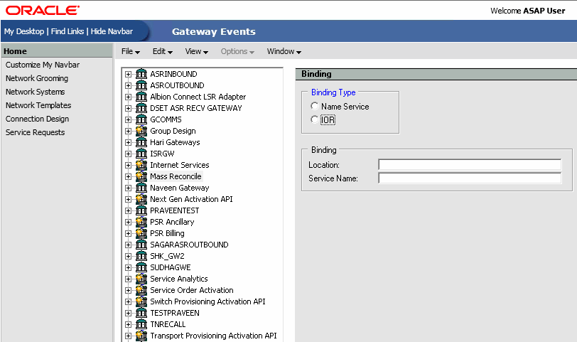

The second change made to gateway maintenance is to enable the definition of multiple binding locations and type of binding to use for each gateway binding location. The type of binding allows the identification of the connection to that gateway. The options are IOR and NameService. Another change is functionality that allows gateways to have multiple bind locations defined. This enables the MetaSolv Solution event architecture to try different locations if it cannot bind to a server. Figure C-2 illustrates binding options:
Figure C-2 MetaSolv Solution Gateway Binding Window
The treeview on the left now has the binding information defined. The multi-color lightning bolt represents a binding option. For each binding option, detail information is captured. This is shown on the right side of the window. The following list details the information:
  • Binding Type: Indicates what binding mechanism to use for this binding location. The options are IOR and NameService.
  • Binding Location: Indicates the path to locate the IOR for binding. This path is used for IOR and NameService binding. This can be expressed as a standard windows path (C:\ior\files) or a URL (http://srvg/ns.ior).
  • Binding Service Name: This field indicates the name of the service to request to obtain the WDIRoot reference if using NameService binding.
When multiple binding locations are defined, the bind process attempts to connect them in the order defined in the tree view on the left. Each bind location can use a different binding approach.
