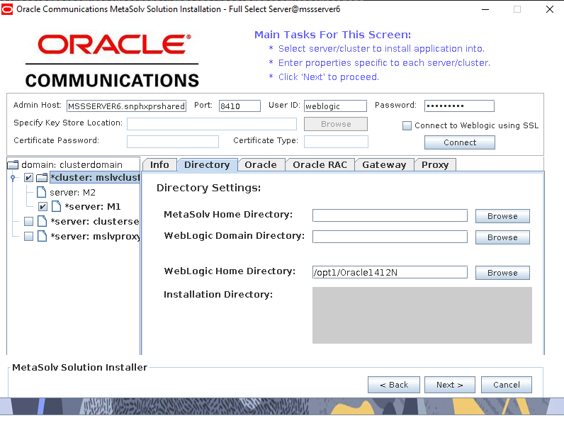

7 Installing and Deploying MetaSolv Solution on a Clustered Server
This chapter describes how to perform a full installation of the Oracle Communications MetaSolv Solution (MSS) 8.0, if you are a new customer or upgrading from a pre-6.3 release, and explains how to set up the MSS application server for clustered server installations. The chapter covers the Oracle WebLogic Server domain configuration and the installation and deployment of the MSS application server.
About Clustered Server Installation
A clustered server installation (also called an administration server with cluster-managed servers installation) is one in which one or more WebLogic Server instances are managed by a separate administration server. In this arrangement, clustering the managed servers in WebLogic allows the servers to work together as one unit, rather than several independent processing units. This is the configuration Oracle recommends because it provides protection in the event a server fails.
This section describes how to:
  • Create a WebLogic domain for clustered servers
  • Install MSS
  • Deploy MSS to the cluster
Figure 7-1 shows the detailed process for a clustered server installation.
Figure 7-1 Installing a Cluster-Managed Server
Description of Figure 7-1 follows
Description of "Figure 7-1 Installing a Cluster-Managed Server"

  5. Do the following:
    1. In the Admin Host field, enter the host name or the IP address of the administration server.
      If you are using an SSL cluster, enter the host name in the Admin Host field.
      If you are creating an IPv6 domain, you must specify the IPv6 address in the Admin Host field.
      (Optional) If you are creating the cluster in an IPv6 domain in a dual-stack machine, ensure that you specify the IPv6 address and the system name in the etc/hosts file, as follows:
      IPv6address		   ipv6machine@example.com	  ipv6machine
      The MetaSolv Solution installer does not support the use of virtual IP address during installation. If you specify a virtual IP address during installation, the installer does not display the following:
      • The check box to select the server you want MSS installed on.

  6. Click Connect.
    The installer queries the Admin Host machine and returns with values you entered during the configuration of the WebLogic domain. This process can take a few moments.
    If the domain does not have a JAX-WS template applied, then the following message is displayed:
    Please update the domain with the required JAX-WS Extension template and restart the installation.
    Exit the installer and upgrade the domain by applying the WebLogic Advanced Web Services for JAX-WS Extension template and optionally the WebLogic JAX-WS SOAP/JMS Extension template. Retry the installation again after selecting the appropriate template(s):
    • WebLogic Advanced Web Services for JAX-WS Extension Template (Required)
    • WebLogic JAX-WS SOAP/JMS Extension Template (Optional)
    The Oracle Communications MetaSolv Solution Installation window appears with the domain and any servers in the domain appearing in the left pane.
  7. In the tree view on the left, select the check box next to the server you want MSS installed on.
    Tabs appear in the right pane for information to be entered for the selected cluster.
  8. Complete domain information by selecting and completing the following tabs:
    1. Click the Directory tab and type the path and name of the MetaSolv home directory, WebLogic Domain directory, and WebLogic Home directory or click Browse to search for the directories.

    5. Click the Info tab to see a summary of the selected server's properties.
  9. When all tabs have correct information for the single server, click Next.
    The Installation Summary window appears.
  10. After checking the information in the summary for accuracy, click Install.
