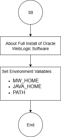

Figure 5-1 shows the steps involved in installing Oracle WebLogic software on a machine that will host MSS. The figure describes step 3B in Figure 1-1.

Figure 5-1 Installing Oracle WebLogic Software on an Application Server Machine
Description of Figure 5-1 follows
Description of "Figure 5-1 Installing Oracle WebLogic Software on an Application Server Machine"

Setting the MW_HOME Environment Variable
Once you have installed WebLogic Server on a machine, add the environment variable for MW_HOME that points to the WebLogic directory.
For example:
For UNIX/Linux:
MW_HOME=/Oracle/Middleware/Oracle_Home
For Windows:
MW_HOME=C:\Oracle\Middleware\Oracle_Home
This step is mandatory and you must set the environment variable MW_HOME before the installation process of MSS.

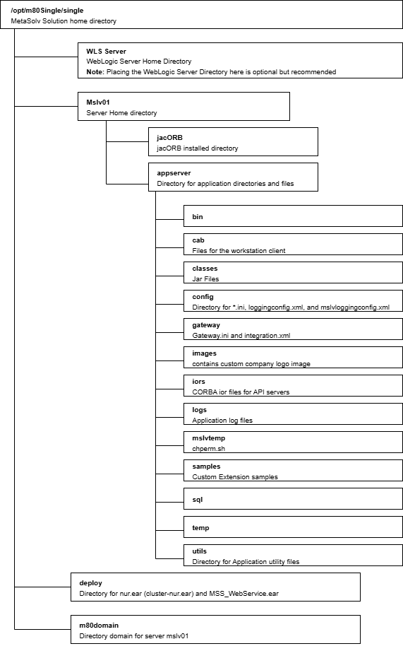

Directory Structure
MSS requires each server directory and its WebLogic domain directory to be placed in the MSLV_Home directory. This directory is a location on the server under which the MSS software will be installed.
In the example shown in Figure 5-2, the following structure exists:
  • MetaSolv home (MSLV_Home) directory: /opt/m80Single/single
  • Server directory: /opt/m80Single/single/mslv01
  • Server domain directory: /opt/m80Single/single/mslv_domain
Figure 5-2 shows an example of a typical MSS directory structure.
Figure 5-2 Example of an MSS Directory Structure
Description of Figure 5-2 follows
Description of "Figure 5-2 Example of an MSS Directory Structure"
