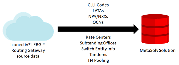

The Location and Routing Gateway collects and imports only the LERGTM Routing Guide information that you specify. For example, you can select specific states, and query by NPA/NXX or CLLI code for the records you want to load.
Figure 6-1 shows the LERGTM Routing Guide information that the Location and Routing Gateway can import to MetaSolv Solution.
Figure 6-1 The Location & Routing Gateway Flow
Description of Figure 6-1 follows
Description of "Figure 6-1 The Location & Routing Gateway Flow"
