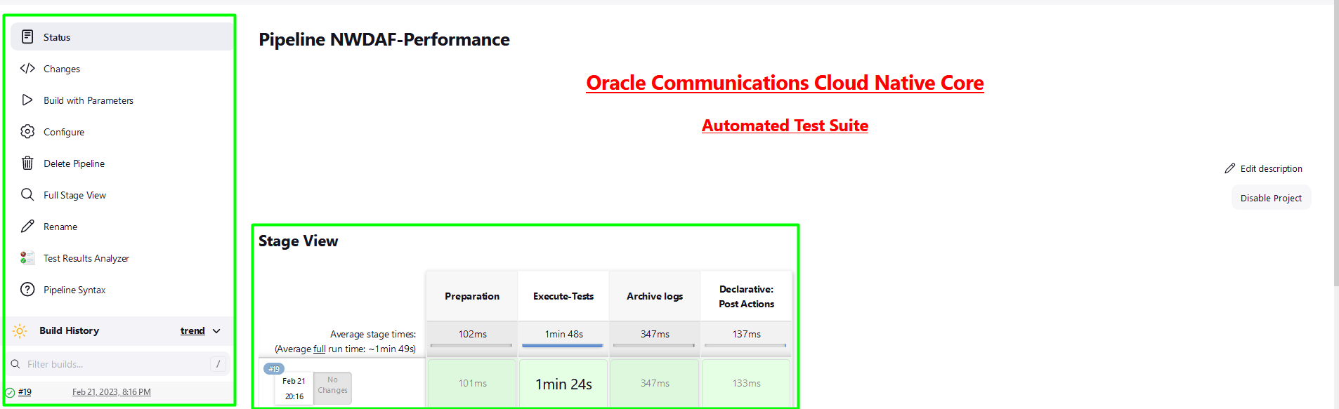

  1. Select the pipeline you want to run the test cases on, click NWDAF-NewFeatures in the Name column. The following screen appears:
    Figure 4-3 Pipeline Configuration
    In the above screen:
    • Click Configure to configure the NWDAF pipeline.
    • Click Build History box to view all the previous pipeline executions, and the Console Output of each execution.
    • The Full Stage View represents the previously run pipelines for reference.
    • The Test Results Analyzer is the plugin integrated into the OCNWDAF-ATS. This option can be used to display the build-wise history of all the executions. It will provide a graphical representation of the past execution together.

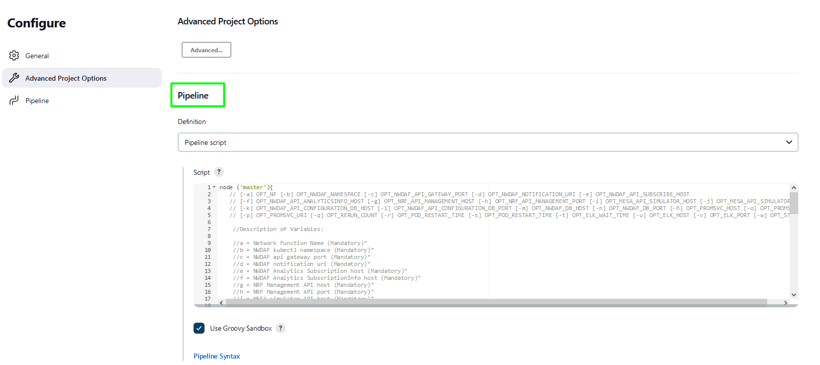

  2. Click Configure to configure the environment parameters of the pipeline. User must wait for the page to load completely. Once the page loads completely, move to the Pipeline section:
    Make sure that the following page loads completely before you perform any action on it. Also, do not modify any configuration other than shown below.
    Figure 4-4 Configure Pipeline
    Configure Pipeline
    Remove the existing default content of the pipeline script.
  3. Depending on the pipeline you want to configure, use the respective script. The following scripts are available at: /var/lib/jenkins/ocnwdaf_tests/pipeline_scripts:
    • NewFeatures_Pipeline_script.txt
    • Regression_Pipeline_script.txt
    • Performance_Pipeline_script.txt
  4. Update the script of the pipeline you want to configure, and update the parameters according to the ATS and NWDAF environment you want to test.

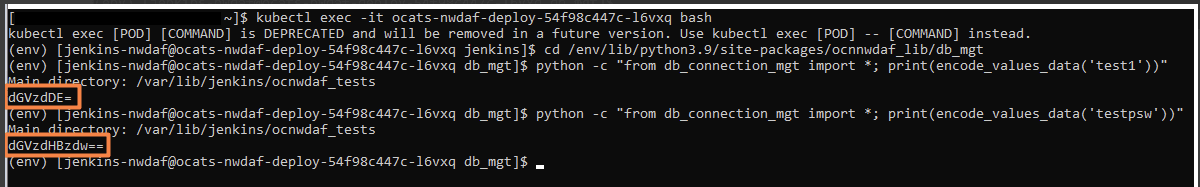

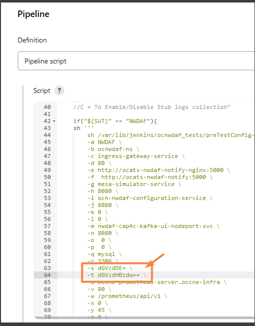

  6. Update the -s db_user_id and -t db_user_psw variables with the current data base user credentials, follow the steps listed below:
    1. Provide the userid and password of the database to be encrypted. Navigate to ocats-nwdaf-deploy pod and run the command:
      kubectl exec -it <pod_name> -n <namespace_name> bash
      For example:
      kubectl exec -it ocats-nwdaf-deploy-54f98c447c-l6vxq -n ocnwdaf-ns bash
    2. From the console, run the following command:
      cd /env/lib/python3.9/site-packages/ocnnwdaf_lib/db_mgt
    3. To update the user id run the following command from the console:
      python -c "from db_connection_mgt import *; print(encode_values_data('<user>'))"
    4. To update the password run the following command from the console:
      python -c "from db_connection_mgt import *; print(encode_values_data('<password>'))"
    5. Copy and paste the encrypted user id and password into the pipeline script located in the bottom of the page.
      For example:
      Figure 4-8 Sample Output
      Sample Output
      Figure 4-9 Pipeline Script
      Pipeline Script

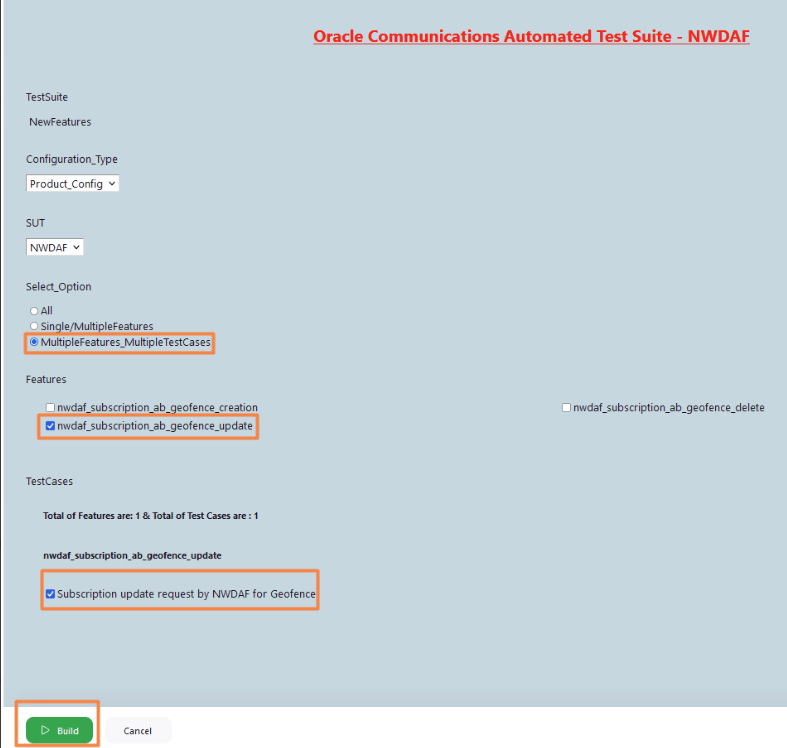

Run the NWDAF ATS test scrips
  1. To run the test cases, click Build with Parameters.
  2. The TestSuite multi-option page is displayed, ensure the SUT value is NWDAF.
    Figure 4-10 TestSuite Page
    TestSuite Page

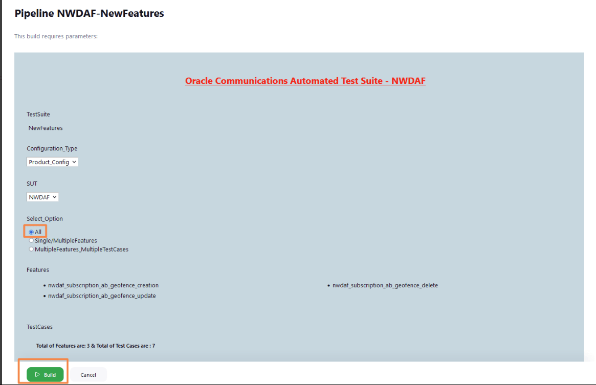

  3. To run all scripts available, select All and click Build.

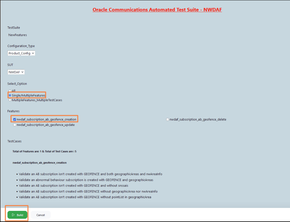

  4. To run scripts on a specific feature, select Single/MultipleFeatures option and select the Feature you want to run the test on and click Build.
    Figure 4-11 Single/Multiple Features
  5. To run scripts on a specific test scenario, select MultipleFeatures_MultipleTestCases option and select the Feature and the TestCases you want to run the test on and click Build.
    Figure 4-12 Multiple Features and Testcases

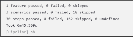

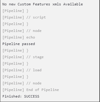

  6. The Build History menu displays the list of running jobs, select the latest job displayed in the list.
  7. Click the Console Output option for this job. The jobs progress can be visualized in the log. The job progress also displays results for test cases and pipelines completed.
    For example:
    Figure 4-13 Sample Output
    Sample Output
    Figure 4-14 Sample Output
    Sample Output

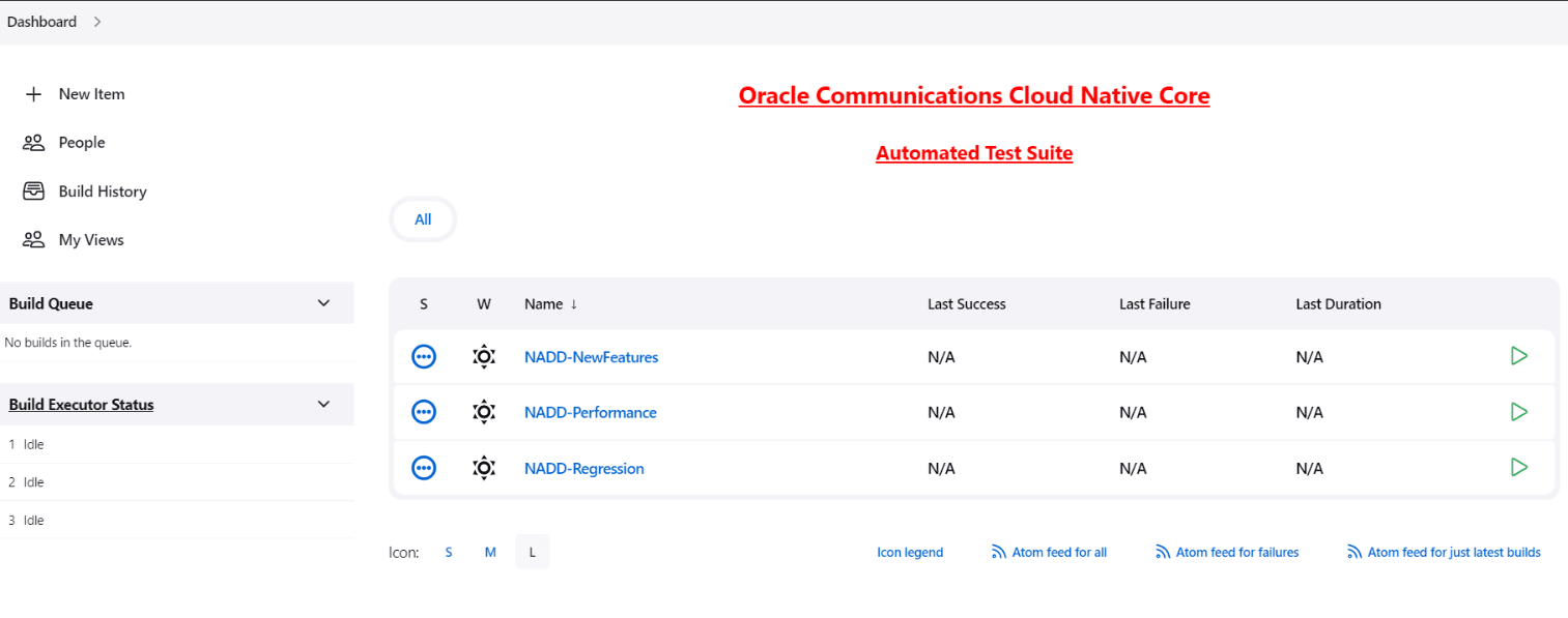

    OCNADD ATS has three pre-configured pipelines.
    • OCNADD-NewFeatures: This pipeline has all the test cases delivered as part of OCNADD ATS - 23.3.0.
    • OCNADD-Performance: This pipeline is not operational as of now. It is reserved for future releases of ATS.
    • OCNADD-Regression: This pipeline is not operational as of now. It is reserved for future releases of ATS.

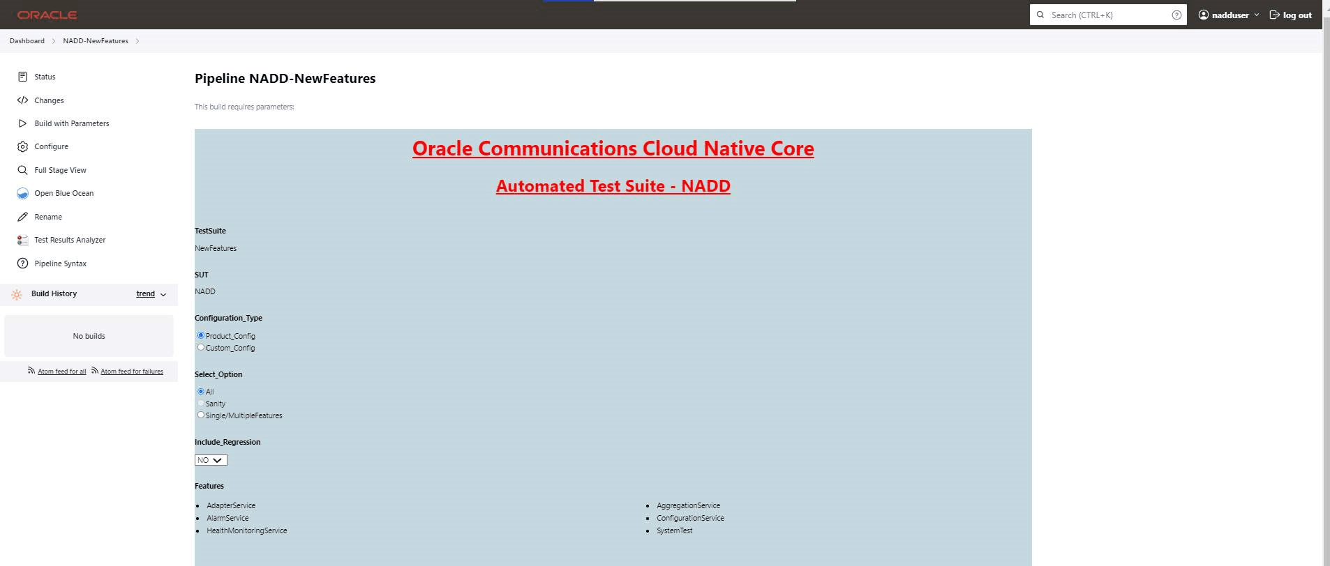

4.2.3 OCNADD-NewFeatures Pipeline
This is a pre-configured pipeline where users can run all the OCNADD new test cases. To configure its parameters, which is a one time activity, perform the following steps:
  1. Click OCNADD-NewFeatures in the Name column. The following screen appears:
    Figure 4-17 Configuring OCNADD-New Features

  2. Click Configure. Once the page loads completely, click the Pipeline tab:
    Make sure that the Configure page loads completely before you perform any action on it. Also, do not modify any configuration other than shown below.
    The Pipeline section of the configuration page appears as follows:
    Figure 4-18 Pipeline Section
    Pipeline Section
    Important:
    Remove the existing default content of the pipeline script and copy the following script content.
    The content of the pipeline script is as follows:

        //NF : Name of the NF
        //NAMESPACE : Namespace name
        //VERSION : API Version
        //DB_HOST : DB Host IP
        //DB_USER : DB User Name
        //DB_PASSWORD : DB Password
        //ALARM_DB_NAME : Alarm Service DB Name
        //HEALTH_MONITORING_DB_NAME : Health Monitoring Service DB Name
        //CONFIG_DB_NAME : Configuration Service DB Name
        //ALARM_API_ROOT : Alarm Service API Root
        //HEALTH_MONITORING_API_ROOT : Health Monitoring Service API Root
        //CONFIG_SVC_API_ROOT : Configuration Service API Root
        //UIROUTER_API_ROOT : UI Router API Root
        //ADMIN_API_ROOT : Admin Service API Root
        //THIRD_PARTY_CONSUMER_API_ROOT : Third Pary Consumer API Root
        //BACKUP_RESTORE_IMG_PATH : Repository path for Backup restore image
        //ALERT_MANAGER_URI : Alert Manager API Root
        //PROMETHEUS_URI : Prometheus URI
        //INTRA_TLS_ENABLED : IntraTLS Value true/false
        //RERUN_COUNT : ReRun Count for Failed Tests
        sh '''
            sh /var/lib/jenkins/ocnadd_tests/preTestConfig-NewFeatures-NADD.sh \
            -a NADD \
            -b v3 \
            -c <ocnadd-namespace> \
            -d <DB_HOST> \
            -e <DB_USER> \
            -f <DB_PASSWORD> \
            -g alarm_schema \
            -h healthdb_schema \
            -i configuration_schema \
            -j ocnaddalarm:9099 \
            -k ocnaddhealthmonitoring:12591 \
            -l ocnaddconfiguration:12590 \
            -m ocnaddbackendrouter:8988 \
            -n ocnaddadminservice:9181 \
            -o ocnaddthirdpartyconsumer:9094 \
            -p <repo-path>/ocdd.repo/ocnaddbackuprestore:<tag> \
            -q occne-kube-prom-stack-kube-alertmanager.occne-infra.svc.<domainName>:80/<clusterName> \
            -r <prometheusExternalIP>/<clusterName>/prometheus/api/v1/query \
            -s false \
            -t 0 \
        if(env.Include_Regression && "${Include_Regression}" == "YES"){
            sh '''sh /var/lib/jenkins/common_scripts/merge_jenkinsfile.sh'''
            load "/var/lib/jenkins/ocnadd_tests/jenkinsData/Jenkinsfile-NADD-Merged"
        else{
            load "/var/lib/jenkins/ocnadd_tests/jenkinsData/Jenkinsfile-NADD-NewFeatures"
    You can modify pipeline script parameters from "-b" to "-q" on the basis of your deployment environment, click on 'Save' after making the necessary changes.

Running OCNADD Test Cases
To run OCNADD test cases, perform the following steps:
  1. Click the Build with Parameters link available in the left navigation pane of the NADD-NewFeatures Pipeline screen. The following page appears:
    Figure 4-19 Pipeline NADD_NewFeatures
  2. Select Configuration_Type as Product_Config.
  3. Set Include_Regression to 'NO' from the drop-down list.
  4. In Select_Option:
    • Select All to run all the feature test cases and click the Build button to run the pipeline.
    • Choose Single/MultipleFeatures to run the specific feature test cases and click the Build button to run the pipeline.

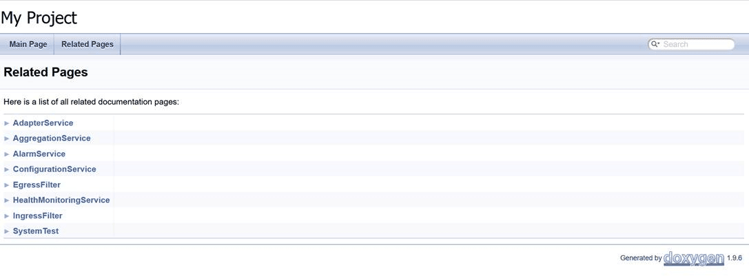

4.2.4 OCNADD-NewFeatures Documentation
The NADD-NewFeatures pipeline has a HTML report of all the feature files that can be tested as part of the OCNADD ATS release. Follow the procedure listed below to view all the OCNADD functionalities:
  1. On the Pipeline NADD-NewFeatures page click Documentation in the left navigation pane. All test cases provided as part of the OCNADD ATS release are displayed on the screen.
    • The Documentation option appears on the screen only if NADD-NewFeatures pipeline test cases are executed at least once.
    • Use the Firefox browser to open the Documentation, other browsers are not supported.
    Figure 4-20 Documentation
    Documentation
  2. Click any functionality to view its test cases and scenarios for each test case.
  3. To exit, click Back to NADD-NewFeatures on the top-left corner of the screen.
