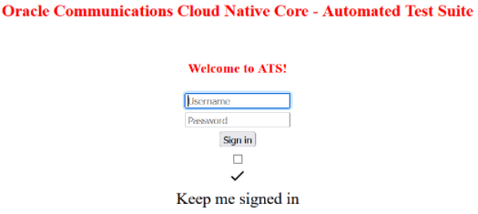

To log in to ATS, open a browser and provide the IP Address and port details as <Worker-Node-IP>:<Node-Port-of-ATS>.
If LoadBalancer IP is provided, then give <LoadBalancer IP>:8080
Figure 4-1 ATS Login
ATS Login
To run ATS:
  1. Enter the login credentials. Click Sign in. The following screen appears.

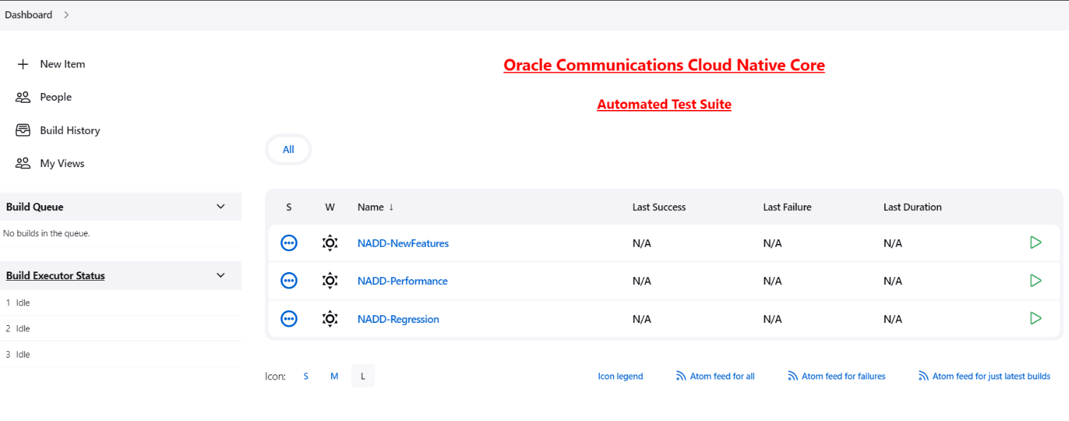

    Figure 4-2 OCNADD Pre-Configured Pipelines
    OCNADD ATS has three pre-configured pipelines.
    • OCNADD-NewFeatures: This pipeline has all the test cases delivered as part of OCNADD ATS - 25.2.100.
    • OCNADD-Performance: This pipeline is not operational as of now. It is reserved for future releases of ATS.
    • OCNADD-Regression: This pipeline is not operational as of now. It is reserved for future releases of ATS.

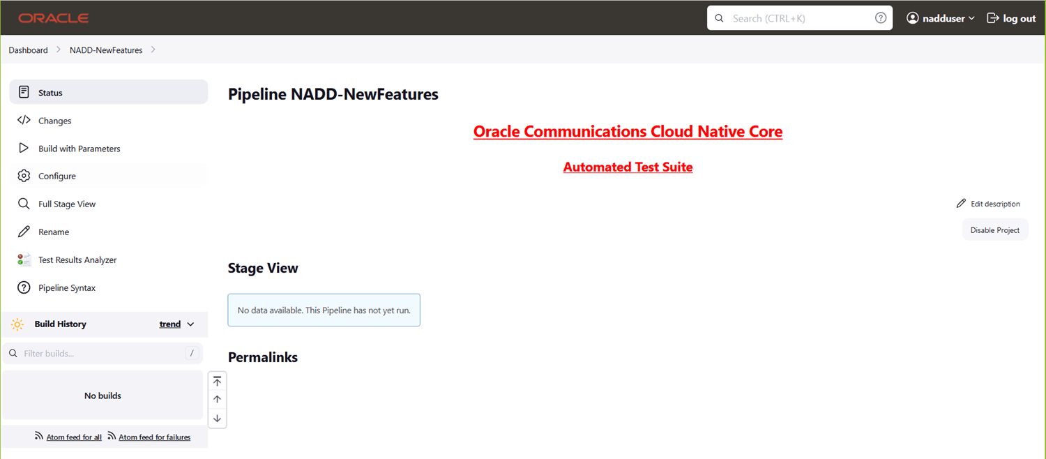

  1. Click OCNADD-NewFeatures in the Name column. The following screen appears:
    Figure 4-3 Configuring OCNADD-New Features
    In the above screen:
    • Click Configure to configure OCNADD-New Features.
    • Click Build History box to view all the previous pipeline executions, and the Console Output of each execution.
    • The Stage View represents the previously run pipelines for reference.

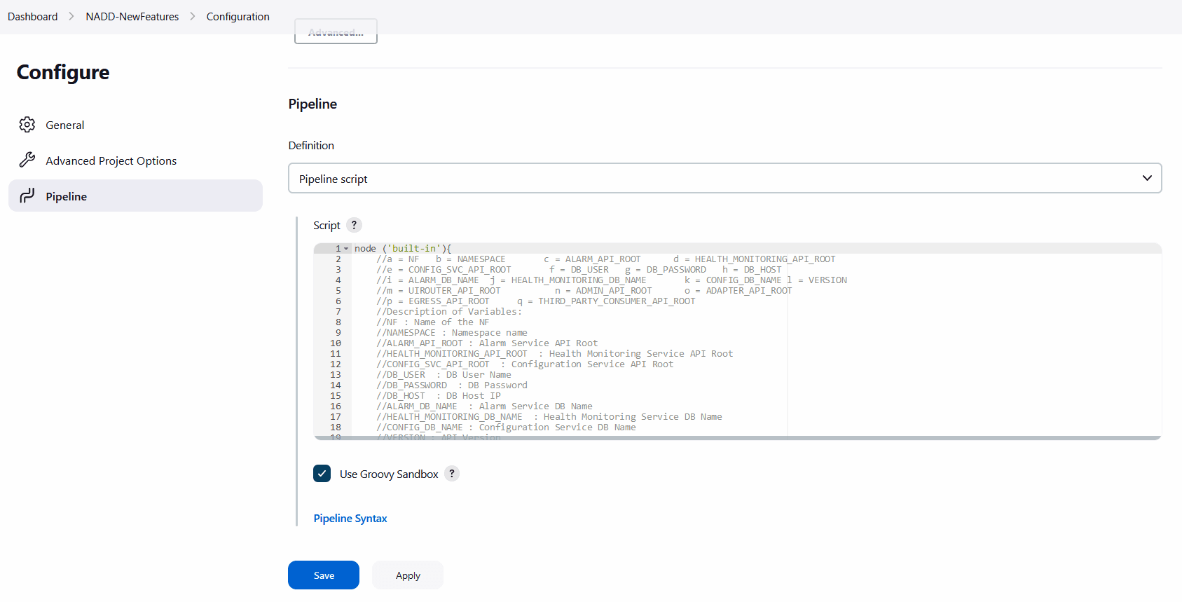

  2. Click Configure. Once the page loads completely, click the Pipeline tab:
    Make sure that the Configure page loads completely before you perform any action on it. Also, do not modify any configuration other than shown below.
    The Pipeline section of the configuration page appears as follows:
    Figure 4-4 Pipeline Section
    Pipeline Section

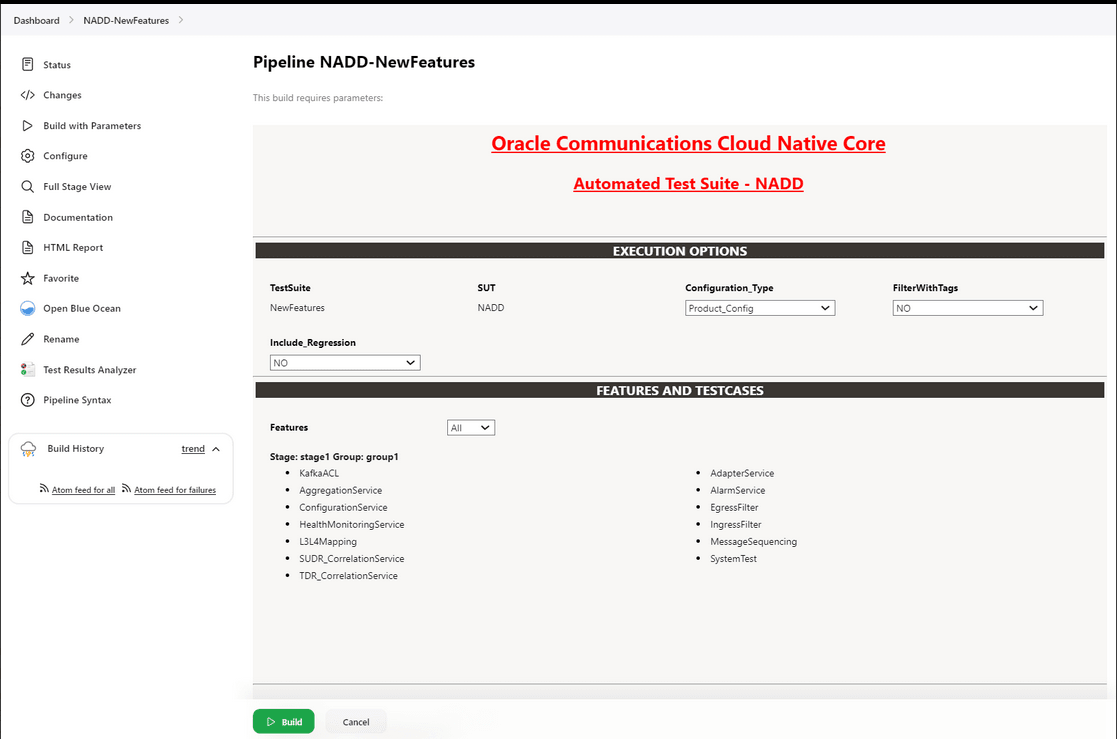

    Important:
    Remove the existing default content of the pipeline script and copy the following script content.
    The content of the pipeline script is as follows:

    You can modify pipeline script parameters from "-b" to "-q" on the basis of your deployment environment, click on 'Save' after making the necessary changes.
    The description of all the script parameters is as follows:

    • l: API root endpoint to reach the ocnaddbackendrouter microservice of NADD. Update the Management Group and Cluster Domain Name in ocnaddbackendrouter.<management-group-namespace>.svc.<domainName>:8988.
    • m: API root endpoint to reach the ocnaddadminservice microservice of NADD. Update the Management Group and Cluster Domain Name in ocnaddadminservice.<management-group-namespace>.svc.<domainName>:9181.
    • n: API root endpoint to reach the ocnaddthirdpartyconsumer microservice of NADD. Update the Management Group and Cluster Domain Name in ocnaddthirdpartyconsumer.<worker-group-namespace>.svc.<domainName>:9094.
    • o: ocnaddbackuprestore image path.
    • p: Alert Manager API root endpoint.
    • q: URI for Prometheus.
    • r: Set the IntraTLS value to either "true" or "false" based on the OCNADD deployment (with IntraTLS enabled or disabled).
    • s: Rerun count for failed test cases. The default value is set to '2'. It can be set to '0', '1', or more, based on user requirements.
    • t: Set the ACL_ENABLED value to either "true" or "false" based on the OCNADD deployment (with ACL enabled or disabled).
    • u: Worker group namespace name along with the cluster name.
    • v: Management group namespace name.
    • w: Set the MTLS_ENABLED value to either "true" or "false" based on the OCNADD deployment.
    • x: OCATS Certificate File name that was created earlier in ATS Certificate Generation to Work with MTLS-Enabled OCNADD section (required only incase of mTls enabled).
    • y: OCATS Certificate Key file name that was created earlier in ATS Certificate Generation to Work with MTLS-Enabled OCNADD section (required only incase of mTls enabled).
    • z: Cluster Domain Name

Running OCNADD Test Cases
To run OCNADD test cases, perform the following steps:
  1. Click the Build with Parameters link available in the left navigation pane of the NADD-NewFeatures Pipeline screen. The following page appears:
    Figure 4-5 Pipeline NADD_NewFeatures
  2. Select Configuration_Type as Product_Config.
  3. Set Include_Regression to 'NO' from the drop-down list.
  4. In Select_Option:
    • Select All to run all the feature test cases and click the Build button to run the pipeline.
    • Choose Single/MultipleFeatures to run the specific feature test cases and click the Build button to run the pipeline.
    • Choose MultipleFeature/MultipleTestCases to select multiple features and multiple test cases within the selected features and click the Build button to run the pipeline.

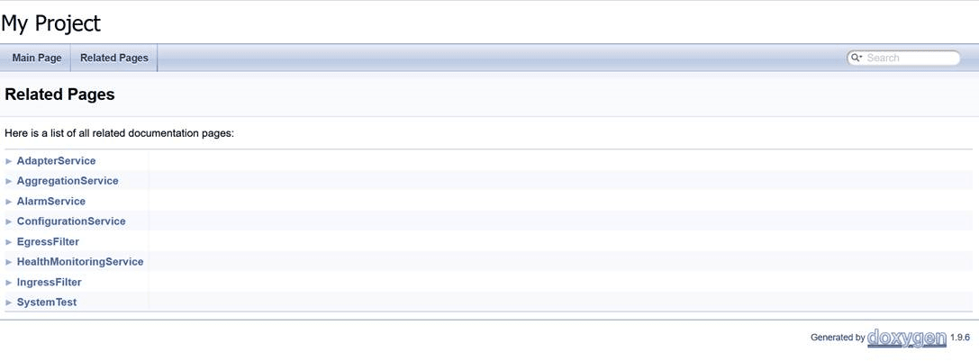

4.1.4 OCNADD-NewFeatures Documentation
The NADD-NewFeatures pipeline has a HTML report of all the feature files that can be tested as part of the OCNADD ATS release. Follow the procedure listed below to view all the OCNADD functionalities:
  1. On the Pipeline NADD-NewFeatures page click Documentation in the left navigation pane. All test cases provided as part of the OCNADD ATS release are displayed on the screen.
    • The Documentation option appears on the screen only if NADD-NewFeatures pipeline test cases are executed at least once.
    • Use the Firefox browser to open the Documentation, other browsers are not supported.
    Figure 4-6 Documentation
    Documentation
  2. Click any functionality to view its test cases and scenarios for each test case.
  3. To exit, click Back to NADD-NewFeatures on the top-left corner of the screen.
