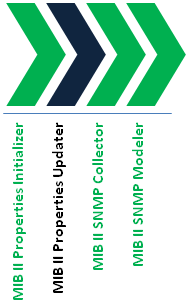

Figure 6-1 shows the processor workflow of the Discover Updated MIB II SNMP action and the placement of the MIB II Properties Updater processor.
This discovery action inherits all the processors from the Discover MIB II SNMP action. See MIB-II SNMP Cartridge Guide for more information.
Figure 6-1 Discover Updated MIB II SNMP Action
Description of "Figure 6-1 Discover Updated MIB II SNMP Action"

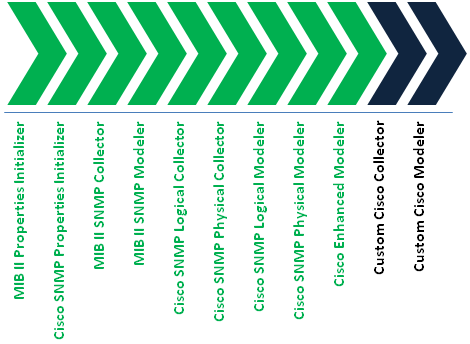

This discovery action inherits all the processors from the Discover Enhanced Cisco SNMP action. See Cisco Router and Switch UIM Cartridge Guide for more information.

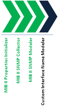

Figure 6-3 shows the processor workflow of the Discover Custom MIB II SNMP action and the placement of the Custom Interface Name Modeler processor.
Figure 6-3 Discover Custom MIB II SNMP Action
Description of "Figure 6-3 Discover Custom MIB II SNMP Action"

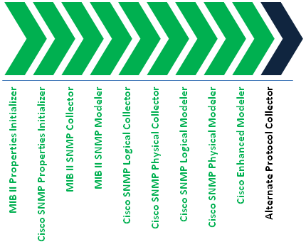

Multiple Protocol Discoveries
This scenario describes the steps required to extend an existing cartridge to discover data using multiple protocols.
The following cartridges must be imported into the Design Studio and build without errors:
Address_Handlers
Cisco_Model
Cisco_SNMP_Cartridge
Cisco_UIM_Cartridge
Cisco_UIM_Model
MIB_II_Model
MIB_II_SNMP_Cartridge
MIB_II_UIM_Cartridge
In this scenario, a range of devices can be discovered. Some devices are SNMP-enabled; some devices support an alternate protocol (for example, TL1). With a list of IP addresses for each of these devices, the discovery action can dynamically discover a device using either SNMP or the alternate protocol.
The Cisco UIM Sample cartridge contains the sample Discover Enhanced Cisco SNMP action. Create a discovery action that reuses the Discover Enhanced Cisco SNMP action. This discovery action can be extended to support the alternate protocol by creating a discovery processor that implements the alternate protocol to this discovery action. To use a JCA resource adapter for this alternate protocol, see "Working with JCA Resource Adapters".
Create a condition that checks whether the SNMP polling to a device is successful or not. If a device supports SNMP, this condition returns true; otherwise if the device supports the alternate protocol, this condition returns false. By applying this condition to the processors, the discovery action can dynamically discover a device using either SNMP or the alternate protocol.
This scenario is made up of high-level steps that are explained in greater detail in the Design Studio Modeling Network Integrity Help.
To extend a cartridge to discover devices using multiple protocols:
Create a discovery action called Discover MultiProtocol and make it dependent on the Cisco_UIM_Cartridge cartridge project.
Create a discovery action called Discover Multi-Protocol.
In Discover Multi-Protocol, add the Discover Enhanced Cisco SNMP action as a processor.
Create a discovery processor called Alternate Protocol Collector to implement the alternate protocol to discover a device and add it to Discover Multi-Protocol as the last processor.
Implement Alternate Protocol Collector by implementing the invoke method. In this example, one line is logged indicating that this processor implements an alternate protocol. In a realistic scenario, implement the alternate protocol to discover a device in this invoke method. The following is the Java snippet for the invoke method:
@Override public void invoke(DiscoveryProcessorContext context, AlternateProtocolCollectorProcessorRequest request) throws ProcessorException { logger.log(Level.INFO, "SNMP Failed - using alternate protocol to discover device " + request.getScopeAddress()); } -
Create a condition called SnmpSucceeds that checks the SNMP results from MIB II Collector to determine whether the SNMP discovery on a device is successful or not. This condition takes mibiisnmpCollectorResponseDocument (an output parameter from MIB II SNMP Collector) as the input parameter. The following is a Java snippet for this SnmpSucceeds condition:
public class SnmpSucceedsConditionImpl implements SnmpSucceedsCondition { @Override public boolean checkCondition(DiscoveryProcessorContext context, SnmpSucceedsRequest request) throws ProcessorException { MIBIISNMPCollectorResponseType snmpResponse = request.getMibiisnmpCollectorResponseDocument(); return snmpResponse != null && snmpResponse.getDiscoveryStatus() == DiscoveryStatus.SUCCESS; } } -
Apply the SnmpSucceeds condition to the following processors and set the Equals to be true:
MIB II SNMP Modeler
Cisco SNMP Logical Collector
Cisco SNMP Physical Collector
Cisco SNMP Logical Modeler
Cisco SNMP Physical Modeler
Cisco Enhanced Modeler
By applying the SnmpSucceeds condition, these processors are invoked only if the SnmpSucceeds condition returns true.
Apply the SnmpSucceeds condition to the Alternate Protocol Collector processor and set the Equals to be false.
In this example, only the message is logged to indicate that an alternate protocol is used in the Alternate Protocol Collector processor. In a realistic scenario, the alternate protocol would be implemented and the network data collected using this protocol and model the collected network data. See "Extending an Existing Cartridge to Discover and Reconcile New Characteristics" section on how to map the collected network data (in that section, the network data is SNMP OID) to new Characteristics and how to update UIM related actions for importing, discrepancy detection and resolution with the new Characteristics.
Figure 6-5 shows the processor workflow of the Discover MultiProtocol action and the placement of the Alternate Protocol Collector processor.
This discovery action inherits all the processors from the Discover Enhanced Cisco SNMP action. See Cisco Router and Switch UIM Integration Cartridge Guide for more information.
