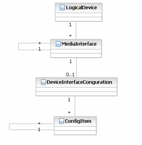

MIB-II SNMP Cartridge UML Representation
Figure 4-1 displays a unified modeling language (UML) diagram depicting the object relationship being rendered.
Figure 4-1 MIB-II SNMP Cartridge UML Representation
Description of "Figure 4-1 MIB-II SNMP Cartridge UML Representation"
Hierarchy Mapping
The logical device object is established and seeded with data sourced by RFC1213-MIB.mgmt.mib-2.system tables.
As a device is discovered, the media interface encapsulates common information about that interface. The device interface configuration captures the media type information that decorates the interface with media-specific parameters that define its behavior (that is; Generic, ATM, Frame Relay or VLAN). This cartridge supports only Generic.
Interfaces are established and seeded with data sourced by:
RFC1213-MIB.mgmt.mib-2.interfaces.ifTable
IF-MIB.mgmt.mib-2.ifMIB.ifMIBObjects.ifXTable.ifXEntry
IP-MIB.mgmt.mib-2.ip.ipAddressTable.ipAddressEntry
The interface hierarchy is established by:
F-MIB.mgmt.mib-2.ifMIB.ifMIBObjects.ifStackTable.ifStackEntry.ifStackStatus
Device interface configuration is established and seeded with data sourced by:
RFC1213-MIB.mgmt.mib-2.ip.ipAddrTable.ipAddrEntry
