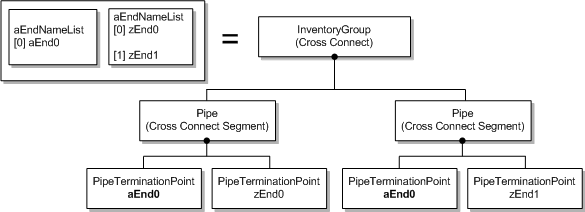

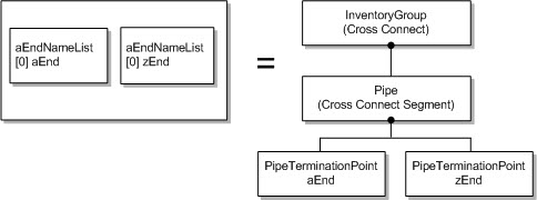

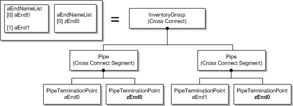

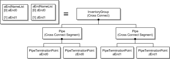

tmf814XCSegmentGeneric A pair of related aEndName and zEndName objects are treated as a cross-connect segment. |

The Optical TMF814 CORBA cartridge models cross-connects as one of the following types:
ST_SIMPLE: Cross-connects with only one segment, as shown in Figure 5-1.
Figure 5-1 ST_SIMPLE Type Cross-Connect Model Mapping
Description of "Figure 5-1 ST_SIMPLE Type Cross-Connect Model Mapping"Some vendors represent a bidirectional cross-connect as two unidirectional cross-connects, meaning one has A1-Z1 as its ends and other has Z1-A1 as its ends. Such cross-connects are modeled as bidirectional.
ST_EXPLICIT: The cross-connect object is modeled as multiple pipe objects, as shown in Figure 5-2.
Figure 5-2 ST_EXPLICIT Type Cross-Connect Model Mapping
Description of "Figure 5-2 ST_EXPLICIT Type Cross-Connect Model Mapping"The number of objects into which a single cross-connect is modeled depends on aEndNameList and zEndNameList size. The explicit subnetwork connection (SNC) type has an n-entry aEndNameList and zEndNameList pairing. The tuples are pairs matched by index, for example (A1,Z1), (A2, Z2), ...,(An,Zn). A pipe object is modeled for each pair. These multiple pipes are grouped by a parent Inventory Group object.
ST_ADD_DROP_A: The cross-connect object is modeled as two pipe segments with aEndPoint repeating on both cross-connects segment, as shown in Figure 5-3.
Figure 5-3 ST_ADD_DROP_A Type Cross-Connect Model Mapping
Description of "Figure 5-3 ST_ADD_DROP_A Type Cross-Connect Model Mapping" -
ST_ADD_DROP_Z: The cross-connect object is modeled as two pipe segments with zEndPoint repeating on both cross-connects segment, as shown in Figure 5-4.
Figure 5-4 ST_ADD_DROP_Z Type Cross-Connect Model Mapping
Description of "Figure 5-4 ST_ADD_DROP_Z Type Cross-Connect Model Mapping"

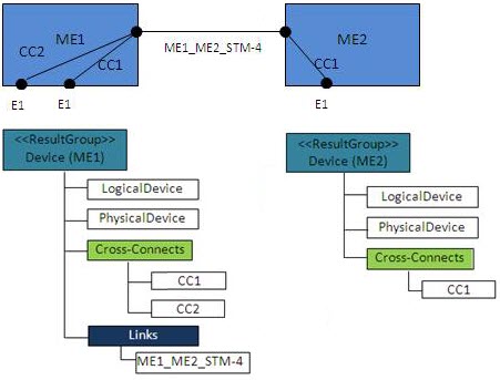

Result Groups
Topological link pipe entities and cross-connect inventory group entities are both added to the same device result group, but in separate group containers.
Topological links span multiple devices. When the aEnd and zEnd ports are managed by MEs belonging to different EMSs, the topological link is modeled according to the device name that appears first in a sorted list.
The Link result group models a root entity container with the name Links as the parent for all topological links associated with a device. The topological link appears on the lower device of the two endpoints, as shown in Figure 5-5.
The cross-connect result group models a root entity container with the name Cross-connects as the parent for all cross-connects associated with the device, as shown in Figure 5-5.
Figure 5-6 shows an example grouping for links and cross-connects with the following particularities:
A populated result group for each device
The appropriate cross-connects added to each device group
The topological link is added only to the ME1 device group
Figure 5-6 Example Result Group Model and Configuration
Description of "Figure 5-6 Example Result Group Model and Configuration"
