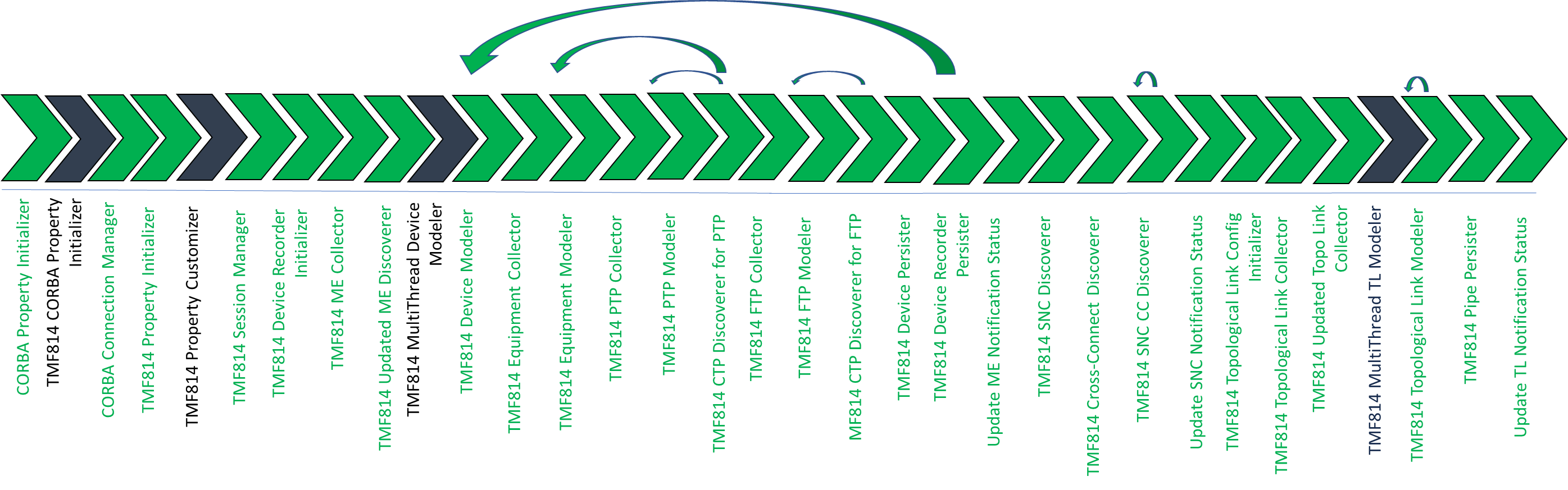

Figure 2-1 illustrates the processors workflow of the Discover Abstract TMF814 action.
Figure 2-1 Discover Abstract TMF814 Action Processors
The Abstract TMF814 action is configured with the isIncrementalScanEnabled condition. When this condition is met, the corresponding processors will run.

Figure 2-2 illustrates the processors workflow of the Discover Abstract TMF814 action.
Figure 2-2 Discover TMF814 Action Processors
