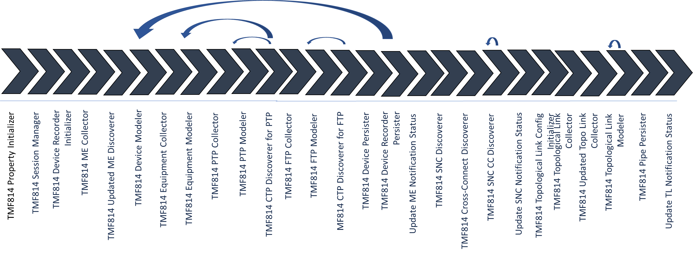

Figure 2-1 illustrates the processors workflow of the Discover Abstract TMF814 action.
Figure 2-1 Discover Abstract TMF814 Action Processors

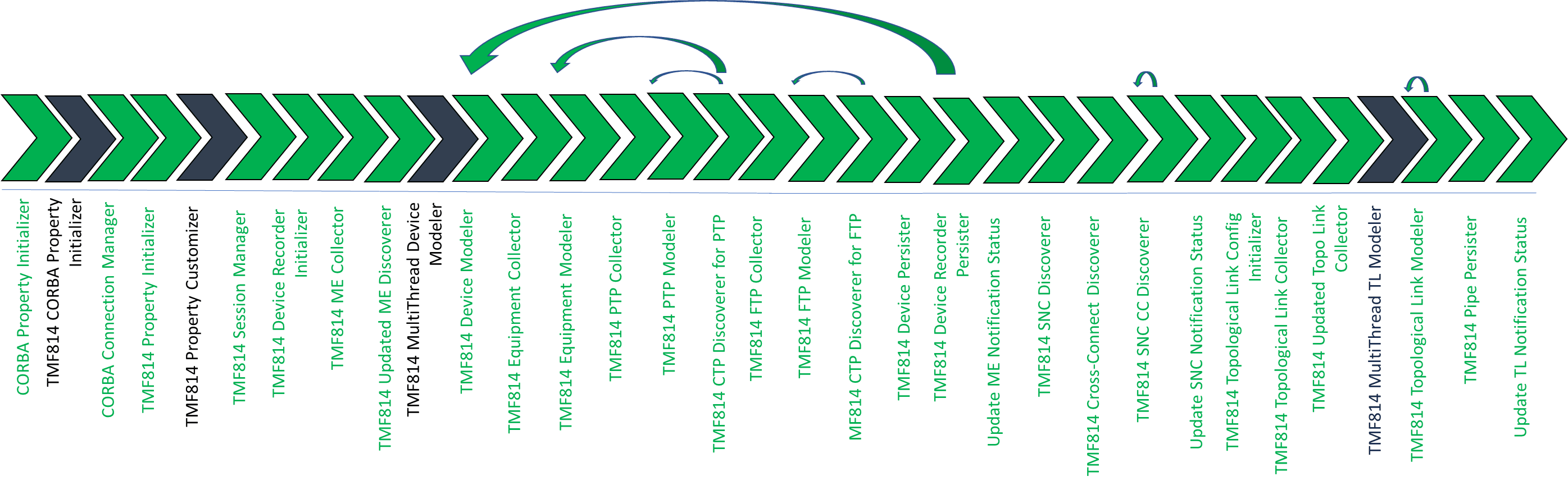

Figure 2-2 illustrates the processors workflow of the Discover Abstract TMF814 action.
Figure 2-2 Discover TMF814 Action Processors
TMF814 CORBA Property Initializer
This processor reads the ORBProperties and ORBArguments parameters from the UI and passes them to the CORBA Connection Manager processor through the corbaSeed. ORBProperties and ORBArguments are used during ORB initialization.
See Network Integrity CORBA Cartridge Guide for information about ORBProperties and ORBArguments.
TMF814 Property Customizer
This processor takes scan parameters for a specific scan and assigns them to properties in the TMF814 Property Initializer processor. See Table 7-3 for a list of available scan parameters.
TMF814 MultiThread Device Modeler
This processor models logical and physical device entities, collects and models equipments, collects and models PTPs and respective CTPs, and collects and models FTPs and the corresponding CTPs. It creates logical and physical device entities and persists to the result.
This processor verifies whether a scan is configured with the Parallel Process option enabled. If not enabled, the processor skips the process.
This processor uses WebLogic's ManagedExecutorService work-manager concept to process it in parallel. For more information, see Network Integrity Developer's Guide.
TMF814 MultiThread TL Modeler
This processor models topological link objects according to the Optical Model for Network Integrity, and adds it to the result group and persists the results.
This processor verifies whether a scan is configured with the Parallel Process option enabled. If not enabled, it skips the process.
