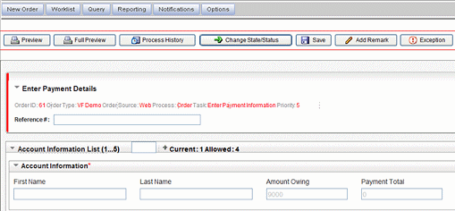

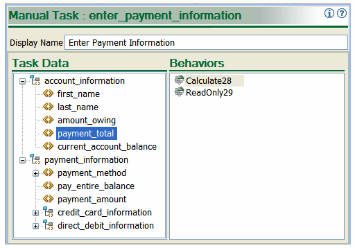

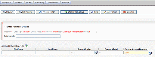

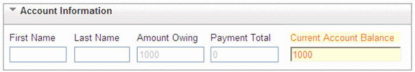

You can model behaviors in tasks and in orders. Figure 9-1 shows how behaviors are modeled in a task that enters payment information. In this figure, the field that shows the payment total uses two behaviors:
A Calculation behavior that adds values in multiple other fields to create the total payment value.
A Read Only behavior that makes the field read-only in the Task web client.
The examples are for illustrative purposes only; OSM is not typically used for payment handling.

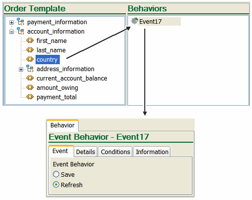

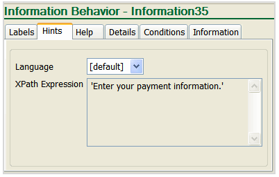

Figure 9-2 shows a behavior modeled in an order. This behavior is used by an order to display a tool tip for the payment information field.
Figure 9-2 Information Behavior Modeled in Oracle Communications Service Catalog and Design - Design Studio
Description of "Figure 9-2 Information Behavior Modeled in Oracle Communications Service Catalog and Design - Design Studio"

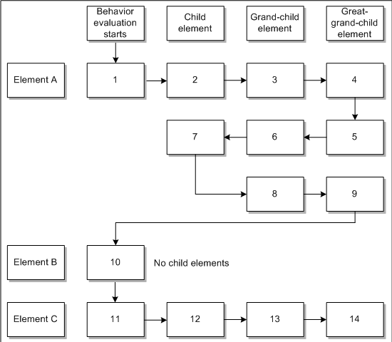

The system evaluates all behaviors for a given node before moving to the next node in the order.
The next node in the order is based on a depth first, left-to-right traversal.
Figure 9-3 shows the element selection order.

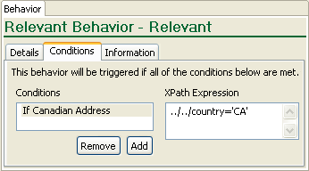

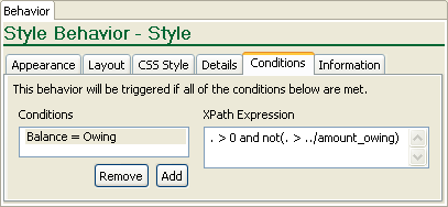

About Setting Conditions in Behaviors
Conditions enable you to specify when a behavior should function. You set a condition by defining an XPath expression. If the XPath expression evaluates to false at run time, the condition is not met and the behavior is not applied. If the XPath expression evaluates to true at run time, the condition is met and the behavior may or may not be applied, depending on the outcome of evaluation of the behavior at run time.
If no conditions are defined, OSM considers the condition to be met. If multiple conditions are defined, all conditions must evaluate to true for the condition to be met.
The Constraint behavior is the only exception to the way conditions are handled.
Constraint behaviors specify a condition that must be met for the data to be considered valid.

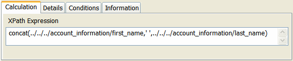

Figure 9-4 shows an XPath expression that combines the first_name field and the last_name field. The Calculation behavior is applied to a field that contains the card-holder name field, where the first and last names are combined into a single field value.
Figure 9-4 Calculate Behavior Formula for Combining String Values
Description of "Figure 9-4 Calculate Behavior Formula for Combining String Values"

Using the Event Behavior to Re-evaluate Data
You can use the Event behavior to save or refresh data when the data changes. This is useful when a change in a field can cause a behavior to automatically occur in the same field or in another field. For example, you might include an Event behavior in the account_information/country field, that causes the data to refresh. That refreshed data might in turn be used by a Relevant behavior assigned to the address details fields that display address information based on the country.
Refreshing causes OSM to re-evaluate all the behaviors associated with the task but does not save the order. Saving re-evaluates the behaviors and automatically saves the contents of the order.
Figure 9-5 shows an Event behavior defined in Design Studio. In this figure, the Event behavior refreshes the data in the account_information/country field.
Figure 9-5 Event Behavior Defined in Design Studio
Description of "Figure 9-5 Event Behavior Defined in Design Studio"
See "Using the Relevant Behavior to Specify if Data Should Be Displayed in the Web Client" for more information on the Relevant behavior, and this scenario in particular.
OSM supports the Event behavior in the Task web client.

Using the Information Behavior to Display Data and Online Help
You can use the Information behavior to specify how data is displayed in the OSM Task web client. You can do the following:
Set an alternative label for the field. For example, instead of the standard label State, the field can be changed to State or Province when processing the type of order that uses this behavior setting.
Localize the field label to one or more different languages.
Set a tool tip on a field.
Provide an online help topic for the field.
In the Order Management web client, any information rule on the first instance of a group node that uses a table layout style is used to determine the text of the table panel header. The first instance of each of this group instance's child field nodes are used to determine the column header text for that field node. Hint text for the group instance row and child field instance cells are displayed as tooltip text. Help defined for the group can be run with either a menu item in the table's Actions menu or a row-level context menu and displays help in a modal window in the page containing the table. The implementation of this help behavior differs from the Task web client implementation, which uses an icon in each table cell to load the help in a separate browser window.
OSM triggers information rules when the data element or structure contains data, (for example, from the incoming order or derived from other data sources). If the data element or structure is empty, OSM does not display any label, hint, or help topic information behaviors associated with the empty element or structure. For example, if you defined a label for an element, the label does not appear when the element does not contain a value. Instead, the OSM uses the Display Name of the element as defined in the data dictionary.

This example shows an Information behavior hint that displays when you hover over the Current Balance data field:
"The current balance reflects the customer's ending balance, plus any current charges and fees, minus any applied payments."
This example shows an Information behavior hint that displays when you hover over the Billing Address data field:
"The billing address is the address of the party responsible for payment of account. The billing address may differ from the service address. For example, the service address may be a college student's address, and the billing address may be the student's parents address."

Using the Read-Only Behavior
You can use the Read Only behavior to specify that data displayed in the Task web client is read only. You can specify that data can be read only based on conditions; for example, data can be read only depending on other data in the order.
You typically create read-only fields for fields where the value is derived from other fields. For example, in your order display, you might have two windows: an account window and a payment window. Both windows might have an Amount Owed field, which displays the same data. However, you could make the Amount Owed field in the payment window the field where the data is collected, and the Amount Owed field in the account window read only. In that case, the field in the account window uses two behaviors:
A Calculate behavior, to get the data from the payment window.
A Read Only behavior.

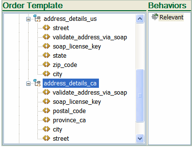

You can use the Relevant behavior to specify if data should be displayed in the Task web client or in the Order Management web Client Data tab, based on specified conditions.
For example, you can use the Relevant behavior to display address-input fields appropriate to the country that the order applies to. In this example, the Relevant behavior can be used as follows:
The data for the customer's country is included in the order's account_information/country field. This data is displayed in the Task web client in the Country/Region field.
Based on the data in the account_information/country field, the customer address fields (address_information) can include different values, depending on the country.
The account_information/country field includes an Event behavior, which refreshes the data in the field, making it available to the Relevant behavior.
Figure 9-6 shows the address fields for the United States (address_details_us) and Canada (address_details_ca). The Relevant behavior applies to the selected data, address_details_ca.
Figure 9-6 Address Fields in Design Studio
Description of "Figure 9-6 Address Fields in Design Studio"
Figure 9-7 shows the XPath expression that specifies the condition (country = Canada) under which the Relevant18 behavior is enabled.
In the Order Management web client, if a group instance displayed with a table style behavior is not relevant, then the entire associated table row is omitted. If a particular field is not relevant, the associated table cell is rendered empty.

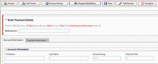

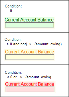

Using the Style Behavior to Specify How to Display Data in the Task Web Client
You can use the Style behavior to specify where and how to display data in the Task web client. You can do the following:
Control the placement of an element on a specific page.
Specify to display data on tabbed pages. You can display data in columns and tables.
Hide or mask sensitive data; for example, passwords or credit-card information. You can specify who can read passwords, and you can display a history of password changes. Masked data appears similar to *******.
Control the layout of a multi-valued field, such as a list of buttons to choose from.
Apply cascading style sheets (CSS style sheets) to specify how to display data. For example, you could make the current account balance display in red when the data value is greater than zero.
If you define a behavior that contains an apostrophe (') character, OSM will throw an exception error when loading the data. To prevent this from happening, you must include the escape character before and after the apostrophe.
Example:
'L'Information De Carte de credit'should be
"'"L"'"Information De Carte de credit"'"Figure 9-8 shows how the Style behavior changes the appearance of the Current Account Balance field in the Task web client.
Figure 9-8 Style Behavior Used in the Current Account Balance Field
Description of "Figure 9-8 Style Behavior Used in the Current Account Balance Field"
Figure 9-9 shows the condition that determines if the Style behavior should be applied. In this case, the Style behavior is applied if the account balance is the same as the amount owed.
Figure 9-9 Condition Defined in a Style Behavior
Description of "Figure 9-9 Condition Defined in a Style Behavior"

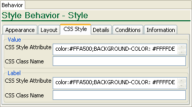

Figure 9-10 shows the style definitions to apply to a field.
Figure 9-10 Field Display Colors Defined in a Style Behavior
Description of "Figure 9-10 Field Display Colors Defined in a Style Behavior"
Figure 9-11 shows how three different conditions can change how the field is displayed. If the balance is zero, the field is green. If the balance is the same as the amount that the customer owes, the field is orange. If the balance is less than zero, or greater than the customer owes, the field is red.
Figure 9-11 How Style Behavior Conditions Are Used for Determining the Display Colors
Description of "Figure 9-11 How Style Behavior Conditions Are Used for Determining the Display Colors"
About Style Behavior Layouts
This section provides additional information on table layouts, which you can choose to set as None, Page Layout, or Table Layout.
The Page Layout option gives you the ability to organize structures elements onto separate pages that you can access directly, through the use of tabs. This is particularly useful for improving access where there are numerous large structures by eliminating the need to scroll through a single page to find the required structure.

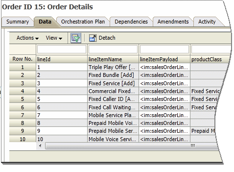

The Table Layout option displays multi-instance structures in a grid format. By default, Table Layout displays all of the child elements in the structures. However, you can prevent a given child element from being used as a column by setting its hidden attribute to true.
Child elements within the structure are represented by columns, and instances of the structure are represented by rows. Table Layout displays the columns from left to right in the same order that they appear from top to bottom when displayed without a table layout. If you need to change the order in which the columns appear, you do so by changing their order in the Design Studio order template. The table uses the same child element label to form the column header that it does when displayed without a table layout.
If you use an Information behavior to dynamically change the child element labels, Table Layout uses the label associated with the first data instance it encounters.

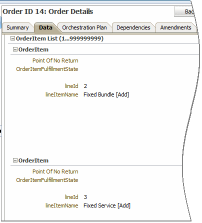

In the Order Management web client data tab, multi-instance child values can be displayed within the corresponding parent value table cell and stacked vertically. You cannot access data history or behavior help from within the cell, but the information about the child multi-instance values can be accessed from the data history for the row. You can access the data history for a row by right clicking on the row and selecting data history or by selecting data history from the table drop down menu.

Figure 9-12 shows the structure with no layout applied. With this option, the elements in the structure display within a group box on the original page.
Figure 9-13 shows the structure with the Page Layout option applied. With this option, the elements in the structure display within a group box on a new page that is accessed through a tab on the original page.
Figure 9-14 shows the structure with the Table Layout option applied. With this option, the elements in the structure display within a grid on a new page that is accessed through a tab on the original page.
Figure 9-12 Task with No Layout in the Task Web Client
Description of "Figure 9-12 Task with No Layout in the Task Web Client"
Figure 9-13 Page Layout in the Task Web Client
Description of "Figure 9-13 Page Layout in the Task Web Client"
Figure 9-14 Table Layout in the Task Web Client
Description of "Figure 9-14 Table Layout in the Task Web Client"
The following figures illustrate the different types of available layouts for the Order Management web client. Each figure shows the same structure with a different layout type:
Figure 9-15 shows the structure with no layout applied.
Figure 9-16 shows the structure with the Table Layout option applied.
Figure 9-15 No Layout in the Order Management Web Client
Description of "Figure 9-15 No Layout in the Order Management Web Client"
Figure 9-16 Table Layout in the Order Management Web Client
Description of "Figure 9-16 Table Layout in the Order Management Web Client"

Table 9-12 shows Style behavior attributes.
Table 9-12 Style Behavior Attributes
| Attributes | Value |
Order of evaluation |
2nd |
Default value |
Data type specific:
Applies to |
Elements of data type:
Elements with Lookup behaviors that display only one column. |
Parent/child inheritance |
Does not inherit (This applies to element relationships within a structure, which is different than the inheritance of behaviors between the data dictionary, order, and task levels.) |
