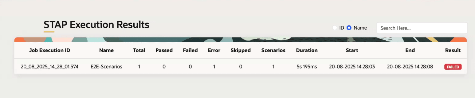

Viewing HTML Reports
After configuring HTML reports using a web server, you can access it them a user-interactive format.
Upon launching a report, it opens an index page titled STAP Execution Results with the total number of jobs run listed. You use the search bar to search for a particular job. To search for a job using its execution ID, select ID. To search for a job using its name, select Name.
Figure 21-1 Web Server Report Index Page
Each job row has these fields:
Table 21-8 Web Server Report Index Page
Field Description
Job Execution ID The ID of the job run.
Name The job's name.
Total Number of scenarios in the job.
Passed Number of scenarios passed.
Failed Number of scenarios failed.
Error Number of scenarios containing errors.
Skipped Number of scenarios skipped.
Duration The amount of time the job took to run, in seconds and milliseconds.
Start The date and time that the test was started.
End The date and time that the test was complete.
Result The result of the scenario: passed or failed.

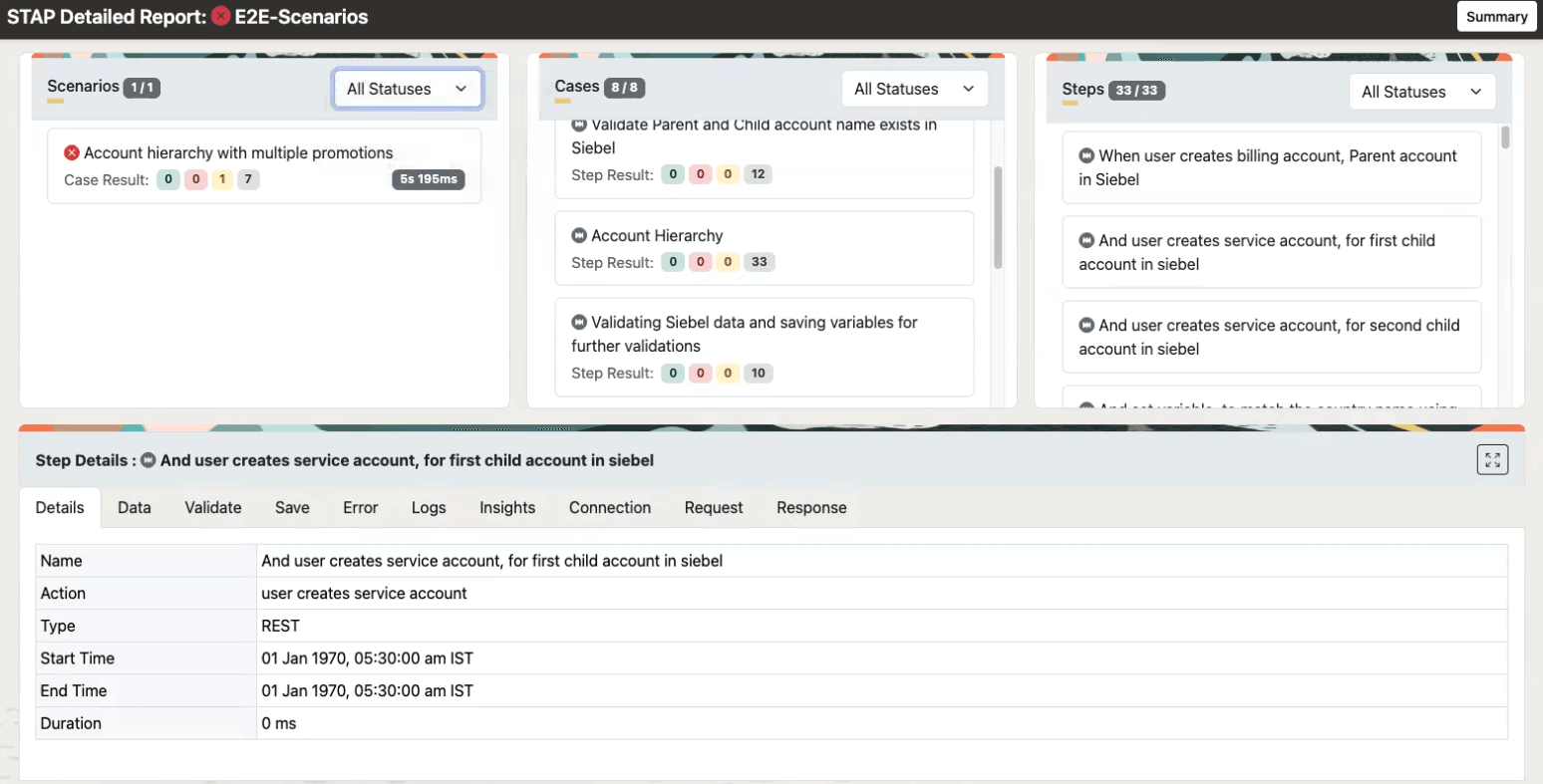

To view more details about the job run, click on its respective row. The STAP Automation Report opens.
This report displays these metrics:
  • Total number of scenarios in the job, including the number of scenarios passed, failed, skipped, or those containing errors. Additionally, it shows the total percentage of scenarios passed, and the amount of time taken to run the job.
  • The total number of scenarios in the job, including the number of scenarios passed, failed, skipped, or those containing errors in a pie chart format.
  • A failure analysis pie chart that presents the number of scenarios failed, and those with errors.
  • The amount of time taken to run each scenario in a horizontal graph.
To return to the index page, click Home on the top right corner.
To view the detailed report of each scenario, click on the scenario name in the list under Scenario Summary Report. Upon clicking on a scenario report, you can view detailed metrics of the scenario, each case within the scenario, and each step within the case.
Figure 21-2 Scenario Summary Report
Each case row displays a color-coded status of the steps run under it:
Table 21-9 Color Coded Summary
Color Description
Green The number of steps passed.
Red The number of steps failed.
Yellow The number of steps containing errors.
Grey The number of steps skipped.
By default, the report displays data for all statuses: passed, failed, skipped, and errors. To filter a case or step using its status, select the status that you want to view under the drop-down menu titled Statuses.
To view details of a particular step, select its corresponding case by clicking on it under Cases, and click on the step you want to view under Steps. You can view the following metrics:
Table 21-10 Detailed Case Report
Field Description
Details The step's details: its name, action name, type, start time, end time, and duration.
Data Displays data configured in the step's BDD. If no data is configured, this section is blank.
Validate Displays validations created under the step in BDD.
Save Displays saved variables and values present in the step.
Error Details of an error when the action was performed. If there is no error, the column is blank.
Logs Displays a detailed report of each action performed.
Insights Display screenshots after each step of UI automation.
Connection Provides details about the endpoint server and its credentials.
Request The request body of the action.
Response The response body of the action.
To go back to the STAP Automation Report, click on Summary on the top-right corner.
