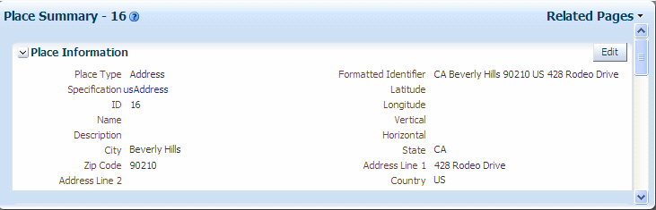

Place Format Identifier
The Place Format Identifier ruleset defines the display format of the Formatted Identifier field for places that are associated with a specific Place specification. The field is comprised of the characteristics defined for the Place specification with which the place is associated. This ruleset runs in UIM whenever the Formatted Identifier field displays for a place. Figure C-1 shows the Place Summary page for an address where the ruleset concatenates the State, City, Zip Code, Country, Address Line 1, and Address Line 2 characteristics to set the Formatted Identifier field.
To modify the ruleset, open it in Design Studio and modify the boldface code in Example C-1 if using Drools, or in Example C-2 if using Groovy. The default code randomly appends the characteristics defined for the specification. By modifying the code, you can specify the characteristics to include in the display, and you can specify the order in which the characteristics appear in the display.
Example C-1 Place Format Identifier Rule (Drools)
