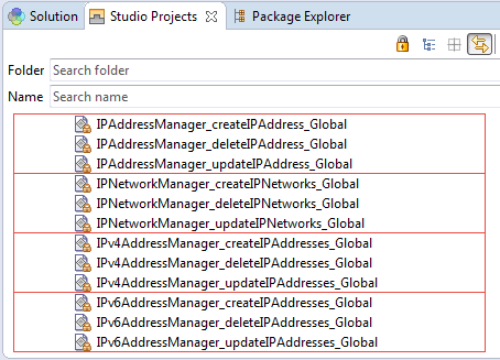

About Naming Conventions
Understanding the naming convention used for the base extension points and base enabled extension points helps you readily locate them within the ora_uim_baseextpts cartridge, which is important because there are hundreds of them. Within the base cartridge, the base extension points are grouped together alphabetically, and the base enabled extension points are grouped together alphabetically.
The naming convention for base extension points is ClassName_methodName. For example, the TelephoneNumberManager_createTelephoneNumbers.
The naming convention for base enabled extension points is SpecificationName_ClassName_methodName. For example, the TelephoneNumberSpecification_TelephoneNumberManager_createTelephoneNumbers.
There are often multiple base extension points defined per class. For example, Figure 8-9 is an excerpt of the ora_uim_baseextpts cartridge expanded in Design Studio that shows several base extension points defined for several entity manager classes. Specifically, IPAddressManager, IPNetworkManager, IPv4AddressManager, and IPv6AddressManager each define extension points for their respective create(), delete(), and update() methods.
Figure 8-9 IP Address Entity Manager Classes
Description of "Figure 8-9 IP Address Entity Manager Classes"
The naming convention used for these extension points indicates that these are global extension points. However, this naming convention is not always employed. So, when working with base extension points, be sure to look at the extension point definition to determine whether the Global check box is selected, indicating that the extension point is a global extension point.

Creating Extension Points
This section applies to specification-based and global extension points.
Before creating a custom extension point, check the UIM_Home/cartridges/base/ora_uim_baseextpts cartridge to see if a base extension point already exists that defines the UIM API method you need to use.
Before you create an extension point, you must first determine the UIM API method signature that you want the extension point to define. For example, you may want to create an extension point that deals with disassociating a telephone number from an inventory group. To determine the UIM API method signatures you need to use the Javadoc and search for the manager class using *Manager.class as search criterion to return a list of all manager classes such as TelephoneNumberManager, EquipmentManager, and PipeManager. After locating the appropriate manager class, search the list of methods for the most likely method, such as the TelephoneNumberManager.disassociateTN() method.
For instructions on how to access the Javadoc, see "Javadoc Documentation".
Creating an extension point is a two-part process:
Both are deployed into UIM as part of a cartridge.
Creating the Extension Point in Design Studio
For instructions on how to create an extension point in Design Studio, see the Design Studio Help. When creating an extension point, use the following information.

For instructions on how to define a ruleset extension point, see the Design Studio Help.
