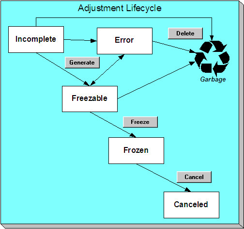

The Lifecycle Of An Adjustment
The following diagram shows the possible lifecycle of an adjustment.

The Adjustment lifecycle is comprised of the Incomplete, Freezable, Frozen, Canceled, and Error states. Adjustments are initially created in the Incomplete state. The adjustment moves to the Freezable state after financial transactions are generated. Freezing the adjustment and its financial transaction moves the adjustment to the Frozen state. Canceling an adjustment removes the financial effects of the adjustment and moves it to the Canceled state. The adjustment moves to the Error state when the system cannot generate the financial transaction because of inconsistent setup data.
Even though New is considered a valid adjustment state, this is only used as default when adding an adjustment. Once the adjustment is saved, it is assigned the appropriate state in the adjustment life cycle. An adjustment will never exist in the New state.
Adjustments are initially created in the Incomplete state. Adjustments in this state don't have a financial transaction. This means, you can change the adjustment type and amount at will.
Click Generate to generate a financial transaction for the adjustment. The financial transaction contains the adjustment's effect on the general ledger and on the customer's payoff and current balances. If the adjustment is calculated, the algorithm on the adjustment type's Generate Adjustment event controls how the adjustment is calculated. If the adjustment is calculated, you must specify the calculation date, which is passed as a parameter to the calculation algorithm and is used for calculations that are effective dated (e.g., rate version or bill factor value). The financial transaction (FT) algorithm defined on the adjustment type Adj. Financial Transaction event controls how the financial transaction is constructed. For calculated adjustments, the distribution code may be taken from the adjustment type or the calculation lines.
After generating the financial transaction, the adjustment becomes Freezable. While in this state, you may change the service agreement, adjustment type and amount at will. However, if you change this information, you will have to regenerate the financial transaction (by clicking the Generate button).
In the very rare situation when the system cannot generate the financial transaction because of inconsistent setup data, the adjustment is moved to the Error state. You may regenerate the financial transaction after correcting the source of the error. You may also delete such an adjustment.
Click the delete button to physically remove an Incomplete, Error or Freezable adjustment from the database.

Click Freeze to freeze the adjustment and its financial transaction. After doing this, the adjustment's state becomes Frozen. While in this state, you cannot change the adjustment's type or amount, but you may change:

If you need to remove the financial effects of an adjustment, click Cancel. Canceling an adjustment causes the generation of another financial transaction. This new financial transaction reverses the financial impact of the original adjustment.
