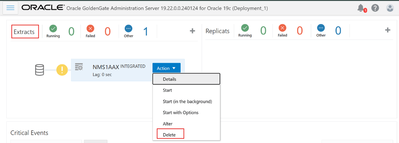

  1. Log in to the source GoldenGate Microservice Administration Service Console.
  2. Ensure all extract process are stopped. Click the Actions section and choose Delete.
    Example screenshot of the Oracle GoldenGate Administration interface showing the Extracts section, where an actions menu for an extract process is open with the delete option available.
    Execute this process for each primary extract process created for the context code. The primary extract process suffix ends with "X". Once the extract process is unregistered, make sure there is no data in the `DBA_CAPTURE` view in the source database related to this context. Execute the following query in the source database. No results should be displayed.

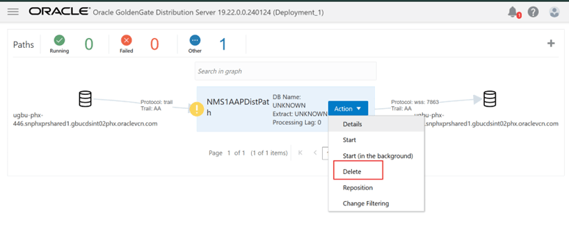

  3. Log in to the Source GoldenGate Microservice Distribution Service Console.
  4. Ensure all distribution paths are stopped. Click the Actions section and choose Delete.
    Example screenshot of the Oracle GoldenGate Distribution Server interface showing the Paths section, where an actions menu for a distribution path is open with the delete option available.

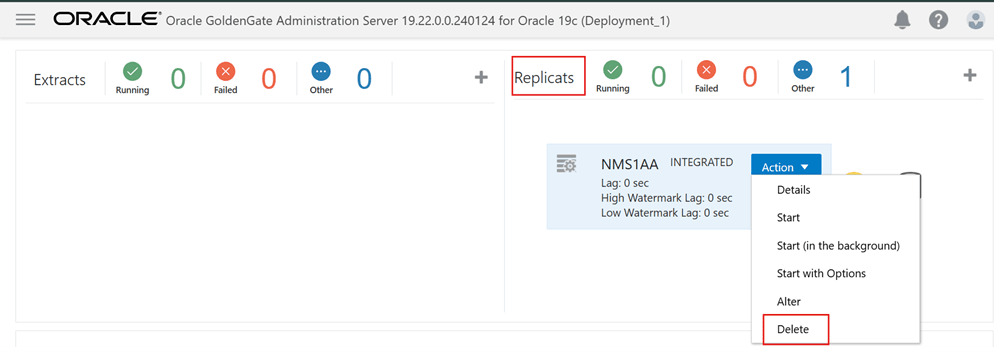

  1. Log in to the target GoldenGate Microservice Administration Service Console.
  2. Ensure all replicats are in a stopped state. Click the Actions section and choose Delete.
    Example screenshot of the Oracle GoldenGate Administration interface showing the Replicats section, where an actions menu for a replicat process is open with the delete option available.
  3. Ensure that no entry is present in the checkpoint table for replicat processes related to the current context.
    Select * from mdadm.b1_checkPoint where group_name like '<context code>%';
