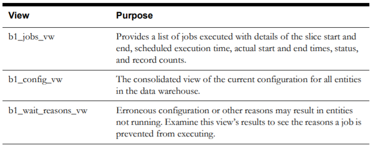

Monitoring the Jobs
As jobs keep running on a regular basis, they are monitored or tracked to ensure that the required performance parameters are met. Jobs are created so that they are capable of automatic re-execution and retries. However, the reasons for the failures should be examined and appropriate actions taken to resolve the issues. The following views are provided for achieving this:
Two columns table showing three views and their respective purpose.
