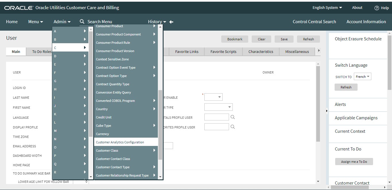

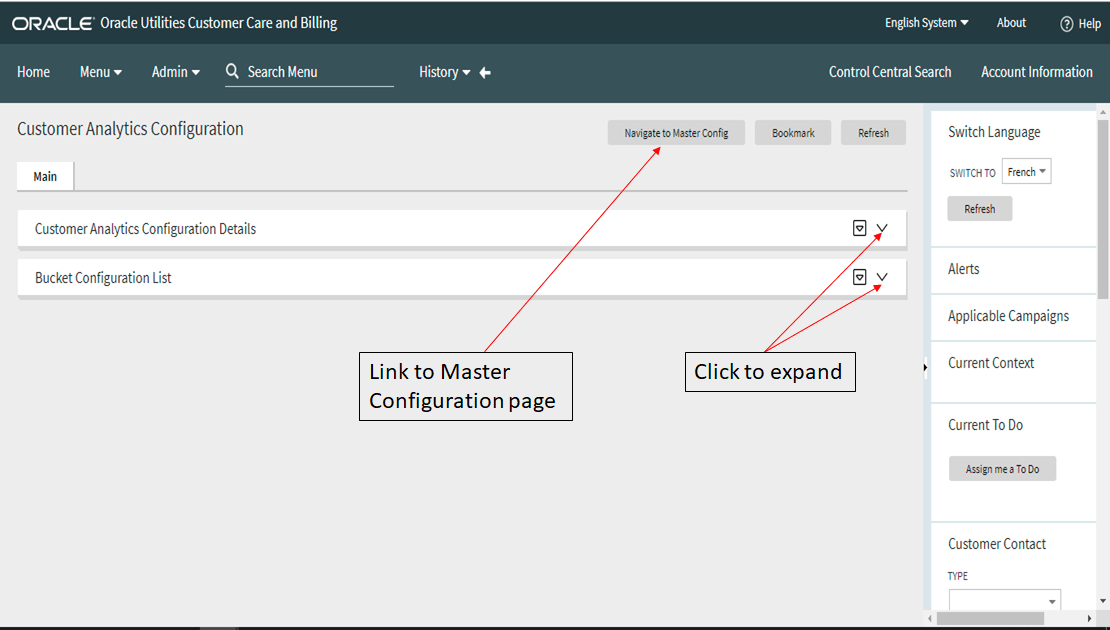

Customer Analytics Configuration Page
The extract parameters and bucket configurations for Oracle Utilities Customer Care and Billing (CCB) application are to be made on the Customer Analytics Configuration page. To access it, log in to the source application and select Customer Analytics Configuration from Admin menu.
The Customer Analytics Configuration page for CCB is divided into two sections that will be described below: Customer Analytics Configuration Details and Bucket Configuration List. It also has a link to navigate to the Master Configuration page.

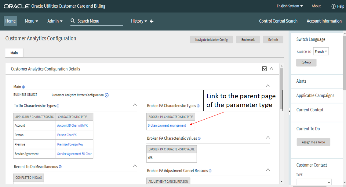

On the Customer Analytics Configuration Details section, you will find the list of the master configuration business objects (BOs) that were created for Oracle Utilities Extractors and Schema, as well as the extract parameters required for the ELT loads.
The parameters that have already been set up will have a foreign key link to the parameter type's parent page, and those that have not been set up yet will only have the parameter name header column.

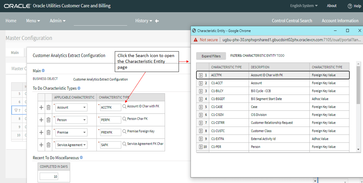

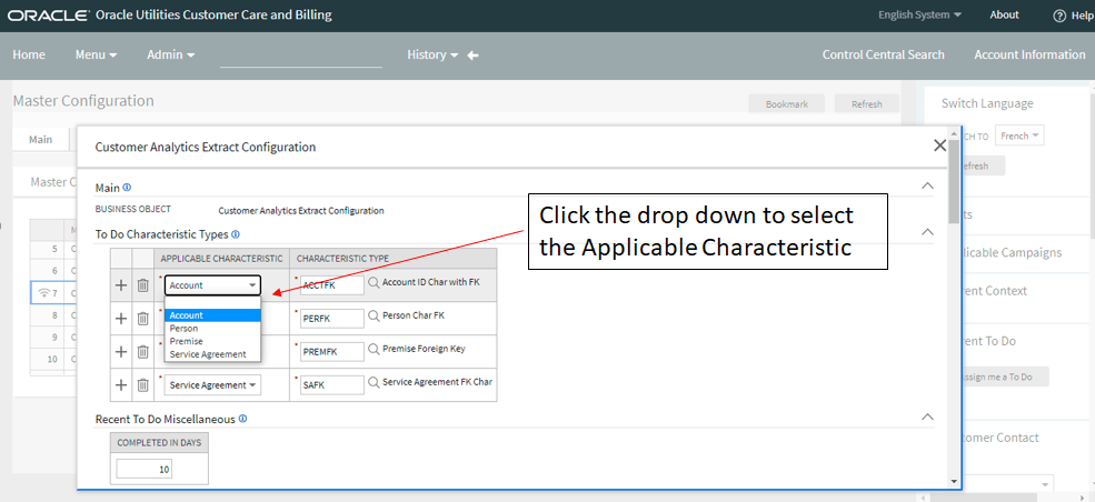

To Do Characteristic Types Parameter
This single-valued extract parameter is used by the To Do facts (CF_TD_ENTRY and CF_RECENT_TD_ENTRY) to configure the Account, Service Agreement, Person, and Premise characteristic types that are used to determine the corresponding entities related to a To Do.
- Navigate to the To Do Characteristic Types parameter on the Customer Analytics Extract Configuration page.
- Select an option from the Applicable Characteristic drop-down menu.
- Click on the search icon to open the characteristic entities list and select a Characteristic Type. Click Save.
- Follow the same steps to set the rest of the values.

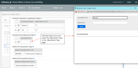

Exclude Archive Adjustment Types Parameter
This multi-valued extract parameter contains all the archive adjustment types that should be excluded by the FT (CF_FT) and FT GL (CF_FT_GL) facts.
- Navigate to the Exclude Archive Adjustment Types parameter on the Customer Analytics Extract Configuration page, and click the search icon to open the Adjustment Type window.
- On the Adjustment Type window, provide the adjustment type or the description value and select the appropriate adjustment type from the list of results. Click Save.
- To add more types, click the (+) icon and populate the required fields.
Broken PA Characteristic Types Parameter
This single-valued extract parameter is used by the Payment Arrangement facts (CF_PA and CF_PA_SNAP) and contains the Broken characteristic type that is used to identify if a payment arrangement is broken.
- Navigate to the Broken PA Characteristic Types parameter on the Customer Analytics Extract Configuration page, and click the search icon to open the Characteristic Type window.
- On the Characteristic Type window, provide the characteristic type or the description value and select the appropriate characteristic type from the list of results. Click Save.

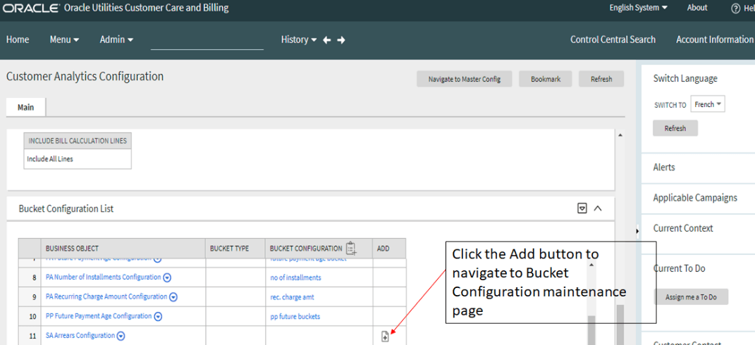

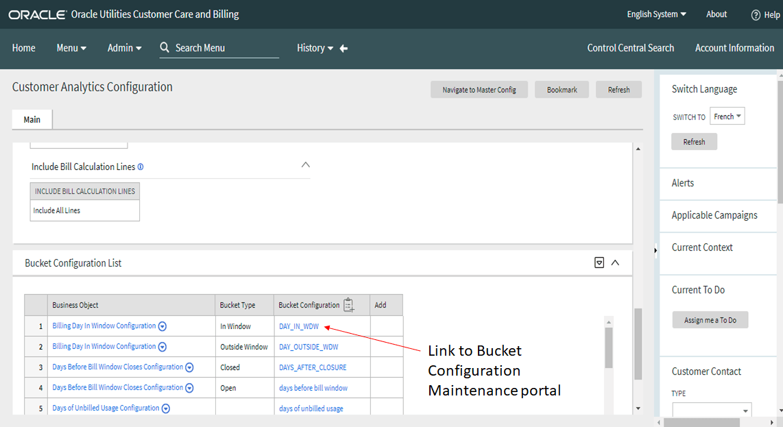

The Bucket Configuration List zone provides an overview of which bucket configurations have been set up so far and which are yet to be set up.
On this zone you will find the Business Objects and Bucket Types configured for the buckets. Under the Bucket Configuration column, the buckets that have already been set up will have a foreign key reference link to the Bucket Configuration Maintenance portal, which allows you to view or edit the current bucket values. Buckets that have not been configured will have an Add (+) button in the Add column.

Billing Day In Window Buckets
This configuration defines the bucket ranges that identify the day on which the bill segment got frozen within the billing window. It also indicates whether the range is within or outside the window. Two sets of ranges can be defined for this bucket configuration: one set for day ranges that fall inside the billing window (In Window status), and another set for day ranges that fall outside the billing window (Outside Window status). This bucket configuration data is extracted into the Billing Day In Window dimension (CD_BILL_DAY_IN_WIN) and referenced in the SA Billing fact (CF_SA_BILLING).
No values are delivered as a part of the base product. Here are some sample values:
- Only one set of ranges can be defined for each bill window status (In Window and Outside Window).
- No gaps or overlaps are allowed within the bucket ranges for a bill window status.
- One initial bucket is required (bucket range starts at 0).
- One catch-all bucket is required for the bucket configuration with the bill window status of Outside Window (bucket end range with maximum value of 99999).
- One and only one bucket range should be categorized as First Day for the bucket configuration with the bill window status of In Window.

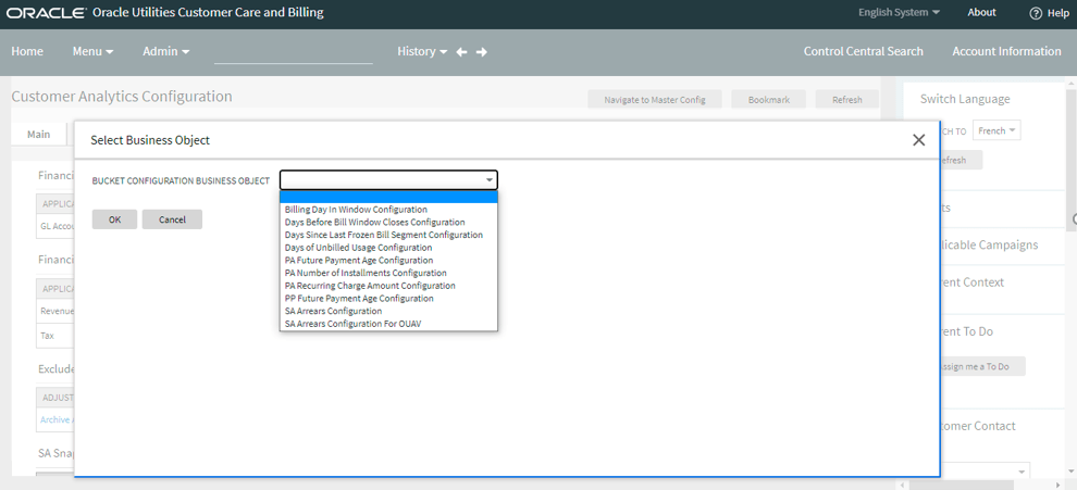

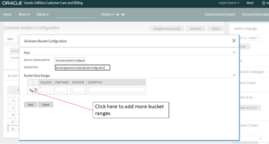

To add this bucket to the configuration list or to add new bucket ranges, follow the steps on Configure CCB Buckets.

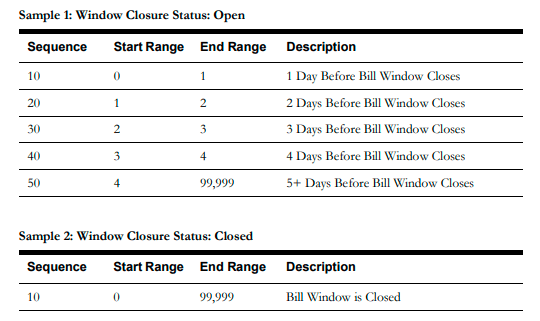

Days Before Bill Window Closes Buckets
This configuration defines the bucket ranges that identify the number of days left before the bill window closes. Two sets of ranges can be configured for this bucket configuration: one set for day ranges when the bill window is still open (Open status), and another set for days when the bill window is closed (Closed status). This bucket configuration data is extracted into the Days Before Bill Window Closes dimension (CD_DAYS_TO_WIN_CLS) and referenced in the SA Billing fact (CF_SA_BILLING) to determine the number of days left for correcting bill segments in Error state before the bill window closes.
- Only one set of bucket configuration can be defined for each window closure status (Open and Closed).
- No gaps or overlaps are allowed within the bucket ranges of a window closure status.
- One bucket should have 0 as its start range.
- Only one range is allowed for the closed window status and it has to catch all the measures (end range has the maximum value of 99999).

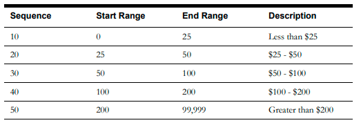

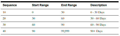

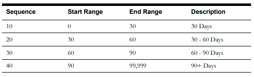

Days of Unbilled Usage Buckets
This configuration defines the bucket ranges used to identify how many days of unbilled usage a service agreement has. The data is extracted into the Days of Unbilled Usage dimension (CD_DAYS_UNBILLED_USG) and is referenced in the SA Arrears Snapshot fact (CF_ARREARS).
- Only one set of the days of unbilled usage bucket configuration is allowed.
- No gaps or overlaps are allowed within the bucket ranges.
- Only one catch-all bucket is allowed and required (the bucket end range has the maximum value of 99999).
- Only one initial bucket is allowed and required (bucket range that starts at 0).

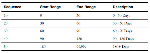

Days Since Last Frozen Bill Segment Buckets
This configuration defines the bucket ranges used to identify the number of days past since a bill segment of the service agreement got frozen. This bucket configuration data is extracted into the Days Since Last Frozen Bill Segment dimension (CD_DAYS_LAST_FRZ_BS) and is referenced in the SA Arrears Snapshot fact (CF_ARREARS).
- Only one set of the days since last frozen bill segment bucket configuration is allowed.
- One and only one catch-all bucket is allowed and required (the bucket end range has the maximum value of 99999).
- One and only one initial bucket is allowed and required (bucket range starts at 0).

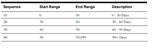

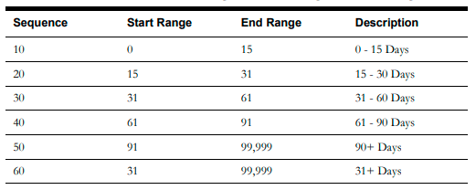

PA Future Payment Age Buckets
This configuration uses day ranges to define the age of scheduled payments (where "age" refers to the number of days within which a payment is supposed to be made) for payment arrangements. The future payments for a payment arrangement are approximated using the number of installments left and the frequency that the payment arrangement SA is billed (via the bill cycle schedule of the account). This bucket configuration data is used in PA Accumulation (CF_PA) and Snapshot (CF_PA_SNAP) facts.
- Only one set of future payment age bucket configuration is allowed.
- One bucket should have the start range as 0
- One and only one catch-all bucket is allowed and required (bucket end range has maximum value of 99999).

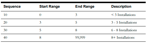

PA Number of Installments Buckets
This configuration defines the bucket ranges used to group payment arrangements based on the number of installments. This bucket configuration data is extracted into the Number of Installments dimension (CD_INSTALLMENT_CNT) and is referenced in the PA Accumulation (CF_PA) and the Snapshot (CF_PA_SNAP) facts.
- Only one set of number of installment bucket configuration is allowed.

PA Recurring Charge Amount Buckets
This configuration defines the bucket ranges used to group payment arrangements based on their recurring charge amounts. This bucket configuration data is extracted into the PA Recurring Charge Amount dimension (CD_REC_CHARGE_AMOUNT) and is referenced in the PA Accumulation/Snapshot fact (CF_PA/CF_PA_SNAP).
- Only one set of recurring charge amount bucket configuration is allowed.
- One and only one catch-all bucket is allowed and required (bucket end range with maximum value of 99999).
- One and only initial bucket is allowed and required (bucket range starts at 0).

SA Arrears Buckets
This configuration defines the bucket ranges for the service agreement's arrears age. This bucket configuration data is used in the SA Arrears Snapshot fact (CF_ARREARS).
- Only one set of arrears age bucket configuration is allowed.
- At least one catch-all bucket has to be defined (bucket end range has maximum value of 99999).
- Gaps in bucket ranges are not allowed.
- Overlaps are allowed within the bucket ranges.
This page details how to add new bucket configurations and bucket ranges for configured buckets for Oracle Utilities Customer Care and Billing (CCB) application.
Add a New Bucket Configuration
Navigate to the Add Bucket Configuration page from the Admin menu.
On the resulting Select Business Object drop-down menu, select the business object for which the buckets are to be configured and click OK.
A new page for the selected configuration appears. Enter the required fields and also provide the bucket value ranges. Click Save and close the window.
To navigate to the Bucket Configuration page of a bucket that has been added to the configuration list, but for which ranges have not been set up yet, click the Add (+) button (located in the Add column).
Populate the Bucket Configuration and the Description text fields.
Provide values in the Bucket Value Ranges section. To add a new bucket range, click the Add (+) button on the left. While providing the bucket value ranges, ensure that:
- At least one bucket has a start range of 0.
- At least one bucket has an end range of 99999.
- There is not overlapping between bucket ranges. For example, if there is a bucket with start range of 1 and an end range of 10, there cannot be a bucket with a start range of 5 and an end range of 13 (5 to 10 is the overlapping range).
- The bucket ranges do not have gaps. For example, if there is a bucket with start range as 1 and end range as 10, the start range for the next consecutive bucket should be 11.
