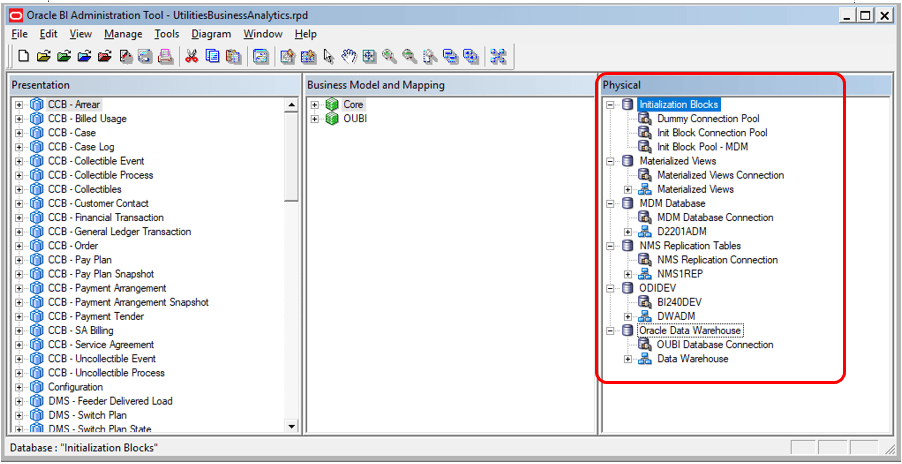

  4. Click Start > Programs > Oracle Analytics Client Tools > Model Administration Tool.
  5. Click File > Open > Offline... to open the RPD in offline mode.
  6. Provide the RPD password. The default password is “oracle123”.
  7. In the Oracle BI Administration tool, go to the Physical pane and expand the tree.
    The tool shows three sections in parallel columns: Presentation, Business Model and Mapping, and Physical, in that order.

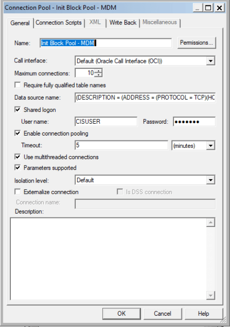

  9. Double-click Init Block Pool - MDM and enter the following (only for Oracle Utilities Meter Data Management):
    • Data source name: MDM database name
    • Username: CISUSER
    • Password: CISUSER User password
      Connection Pool window with the General tab selected. Here the user is to enter the details as instructed in this step.

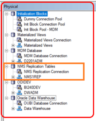

  12. Double-click NMS Replication Tables and enter the following (only for Oracle Utilities Network Management System):
    • Data source name: BI database name
    • Username: DWREAD
    • Password: DWREAD User password
      Detail of the Physical pane. This screenshot emphasizes the NMS Replication Tables tree.
      The default schema name is <NMS4REP>. If the replication schema name is different, then rename it to the actual value.

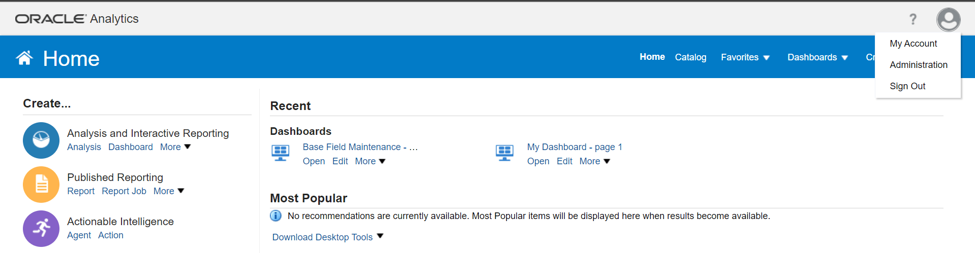

  1. Log in to the Analytics application: http://<App Server Host>:<port>/analytics.
  2. Click the profile icon in the top right corner of the screen, and click Administration.
    Oracle Analytics Home page showing the options that appear when you click the user profile icon.

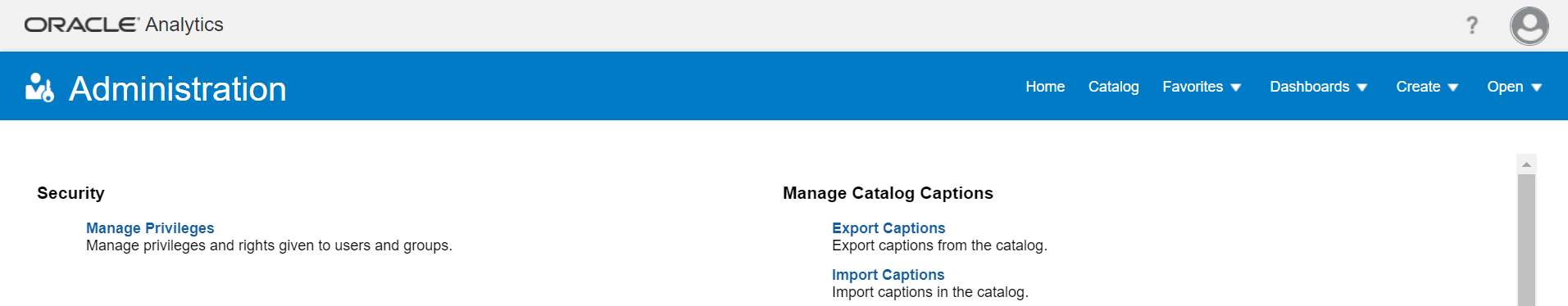

  3. In the Administration screen, under the Security area, click Manage Privileges.

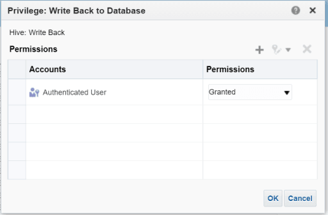

  5. In the dialog box that displays, click the menu in the Permissions column and select Granted from the drop-down menu.
    Privilege: Write Back to Database dialog box displays a table with two columns; Accounts column on the left-hand side, and Permissions column on the right-hand column.
  6. Click OK.
