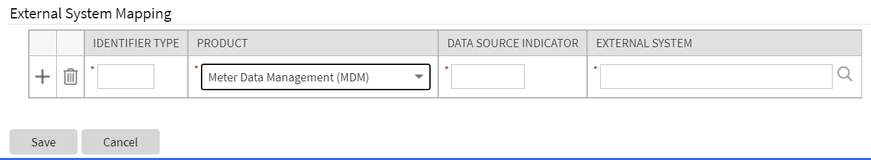

  • External System Mapping. Configure the following items under this group:
  • Item Description
    Identifier Type The identifier type code used to identify the external identifier number from the integrating system.
    Product The product to which Oracle Utilities Operational Device Management is being integrated with.
    Data Source Indicator
    The unique identifier of the integrating system. This is the environment ID of the Oracle Utilities Meter Data Management system. It can be
    identified from the Oracle Utilities Meter Data Management system using the query
    select ENV_ID from
                                     F1_INSTALLATION

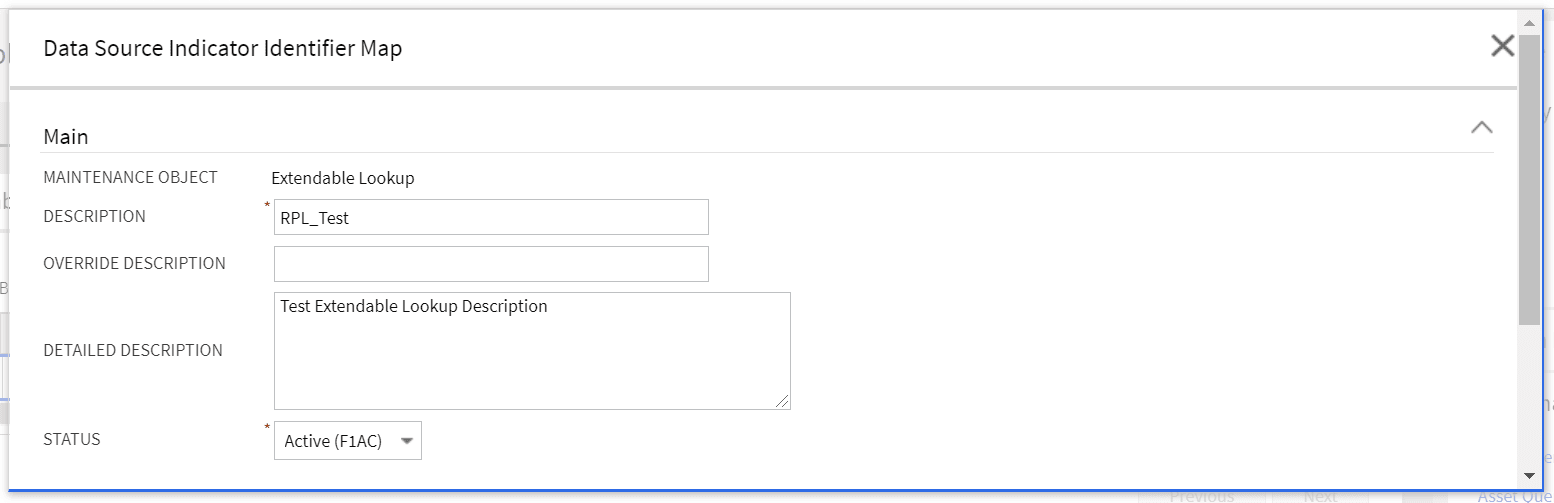

  1. Navigate to the Data Source Indicator Map page from the Extendable Lookup page as shown below.
    Screenshot of how to navigate to the Data Source Identifier Map page.
  2. Populate the fields under Main.
    Screenshot of how populate the fields in the "Main" subsection of the user interface.
  3. Populate the fields under External System Mapping (the descriptions for these fields are provided on the table above). Click Save.
    Screenshot of how to populate the fields in the "External System Mapping" section of the user interface.

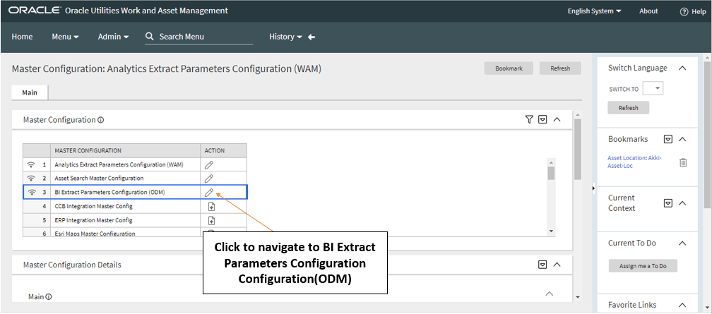

To set a value for this parameter:

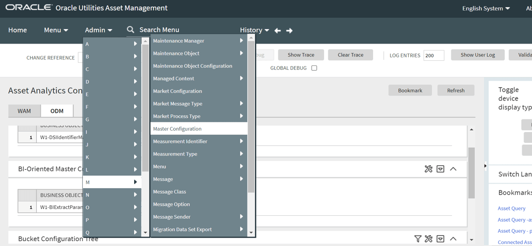

  1. Navigate to the Master Configuration page from the Admin menu.
    Screenshot of how to navigate to the Master Configuration page.
  2. Click Edit on the Action column for BI Extract Parameters Configuration (ODM) row.
    Screenshot of how to navigate to the BI Exotract Parameters Configuration.

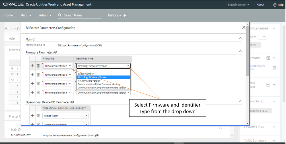

  3. On the BI Extract Parameters Configuration window, navigate to the Firmware Parameters section.
  4. Select the firmware and the identifier type from the drop-down menu and click Save. To add more values, click the Add (+) icon and populate the required fields.
    Screenshot of how to select the firmware and the identifier type from the drop-down menu.

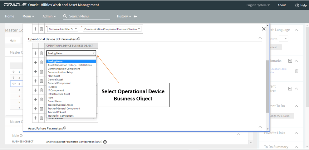

Operation Device BO Parameters
These parameters hold the business object names that are used to identify the operational devices that should be extracted. The Operational Device Snapshot and Operation Device Accumulation facts, as well as the Operational Device dimension in the Business Intelligence data warehouse, are designed to hold only the operational device data. Use this operational device parameter configuration to specify the business objects that are used to identify the assets that should be extracted into the star schema tables.
    Screenshot of how to navigate to the BI Extract Parameters Configuration.
  3. On the BI Extract Parameters Configuration window, navigate to the Operational Device BO Parameters section.
  4. Select the Operational Device Business Object from the drop-down menu and click Save. To add more values, click the Add (+) icon and populate the required fields.
    Screenshot of how to select the Operational Device Business Object from the drop-down menu.

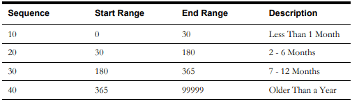

Asset Age Buckets
This configuration defines various bucket ranges that are used to classify how long an operational asset has been in the system. This bucket configuration data is extracted into the Asset Age Bucket dimension (CD_ASSET_AGE) and referenced in the Operational Device Snapshot fact to categorize an asset's age into the appropriate bucket.
No values are delivered as a part of the base product. Here are some sample values:
Default: Yes
Picture of a table showing sample values for the Asset Age Bucket configuration.
While selecting the Business Object in Select Bucket Configuration Business Object window, select the Asset Age Bucket Configuration (ODM) (W1-AssetAgeBuckets) option from the drop-down menu.
To add this bucket to the configuration list or reconfigure bucket ranges for configured buckets, see Configure ODM Buckets.

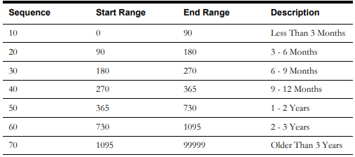

Asset Installation Age Buckets
This configuration defines various bucket ranges that are used to classify how long an operational asset has been installed on the field. This bucket configuration data is extracted into the Asset Installation Age Bucket dimension (CD_ASSET_INSTALL_AGE) and referenced in the Operational Device Snapshot fact to categorize an asset's install age into the appropriate bucket.
Default: Yes
Picture of a table showing sample values for the Asset Installation Age Bucket configuration.
While selecting the Business Object in Select Bucket Configuration Business Object window, select Asset Install Age Buckets (ODM) (W1-AssetInstallAgeBktConfig) option from the drop-down menu.

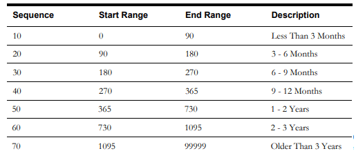

Asset In Storage Age Buckets
This configuration defines various bucket ranges that are used to classify how long an operational asset has been in store. This bucket configuration data is extracted into the Asset In Storage Age Bucket dimension (CD_ASSET_INSTORE_AGE) in the BI data warehouse and referenced in the Operational Device Snapshot fact to categorize an asset's in-store age into the appropriate bucket.
Default: Yes
Picture of a table showing sample values for the Asset In Storage Age Bucket configuration.
While selecting the Business Object in Select Bucket Configuration Business Object window, select Asset In Storage Bucket Configuration (W1-AssetInstoreAgeBktConfig) option from the drop-down menu.

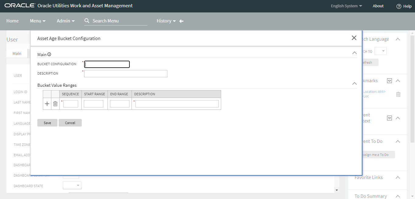

Add a New Bucket Configuration

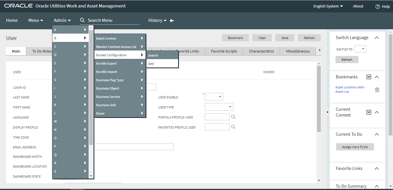

  1. Navigate to the Add Bucket Configuration page from the Admin menu.
    Screenshot of how to navigate to the Bucket Configuration page.

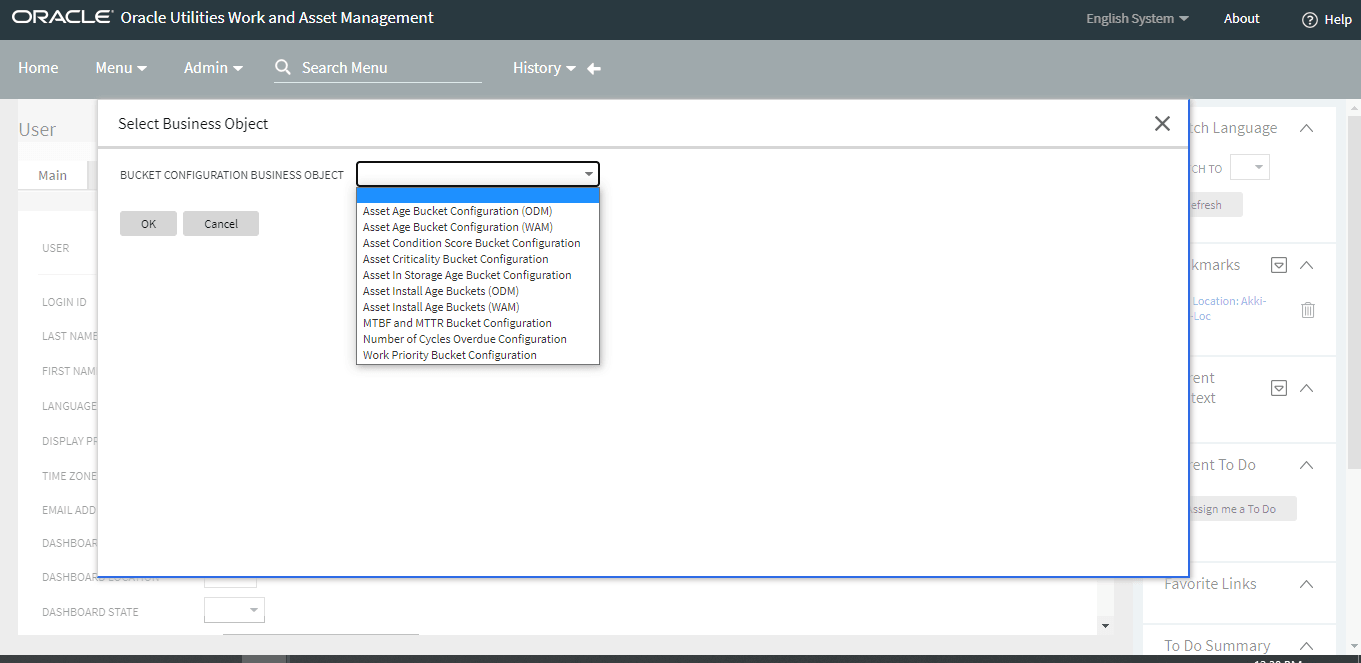

  2. On the Select Business Object drop-down menu, select the business object for which the buckets are to be configured and click OK.
    Screenshot of how to select the business object for which the buckets are to be configured.
  3. On the selected bucket's window, populate the required fields and provide the bucket value ranges.
    Screenshot of how to populate the required fields and provide the bucket value ranges.
  4. Click Save and close the window.

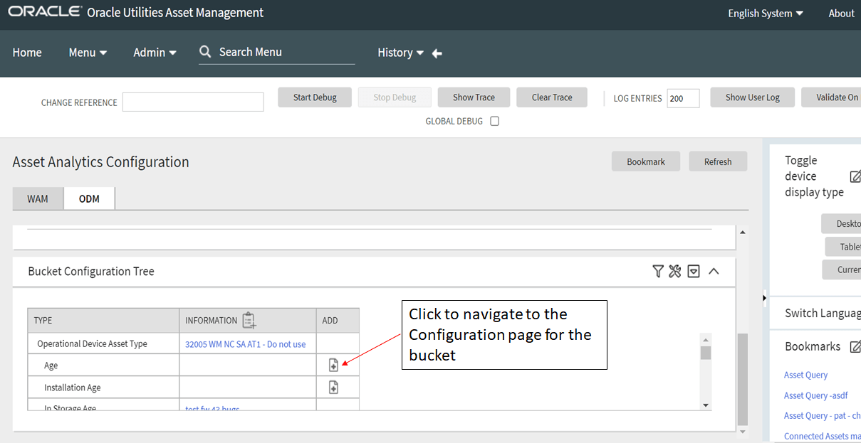

Add Bucket Ranges for Configured Buckets
  1. To navigate to the Bucket Configuration Maintenance page of a bucket that have been added to the configuration list but which ranges have not been set up yet, click the Add (+) button that is located under the Add column.
    Screenshot of how to navigate to the Bucket Configuration Maintenance page.

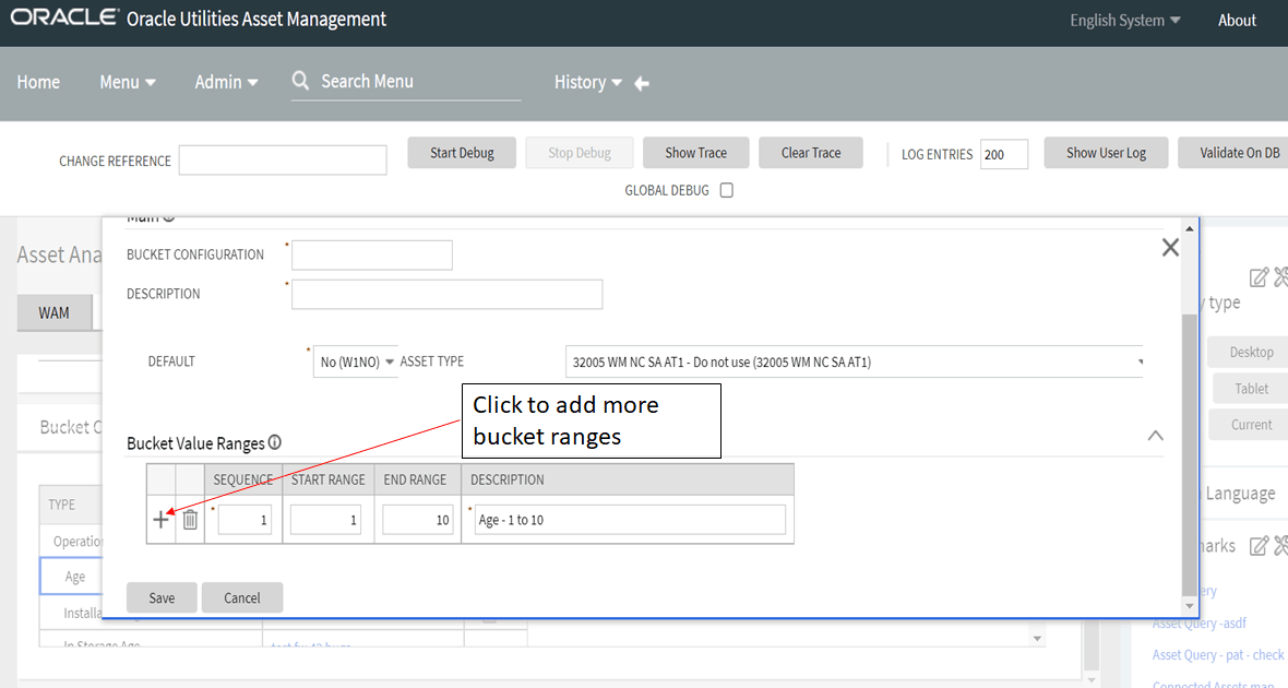

  2. From the configuration window, you can add or edit value ranges. To add a new value range, click the Add (+) button on the left, populate the fields, and click Save. To edit a current value range, modify the values in the fields and click Save.
    Screenshot of how to add or edit bucket value ranges.
  3. While providing the bucket value ranges, ensure that:
    • At least one bucket has a start range of 0.
    • At least one bucket has an end range of 99999.
    • There is not overlapping of bucket ranges. For example, if there is a bucket with a start range of 1 and an end range of 10, there cannot be a bucket with a start range of 5 and an end range of 13 (5 to 10 is the overlapping range).
    • There are no gaps between bucket ranges. For example, if there is a bucket with a start range of 1 and an end range of 10, the start range for the next consecutive bucket should be 11.
