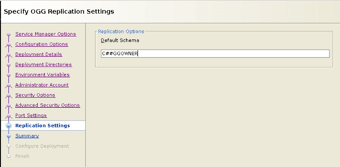

  1. Set the security options by selecting the SSL/TLS security checkbox and defining the respective wallets.
    Select the SSL/TLS security checkbox and define the respective wallets.
  2. Set the replication settings.
    Set the Default Schema to the Oracle GoldenGate Owner like C##GGOWNER for the Distribution (Source) GoldenGate Microservices. Do not create a new GoldenGate Owner. Use the same user that was used in GoldenGate Classic Source configuration.
    Set the Default Schema replication setting to the Oracle GoldenGate Owner.

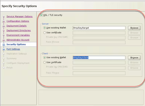

    Select the SSL/TLS security checkbox and defining the respective wallets.

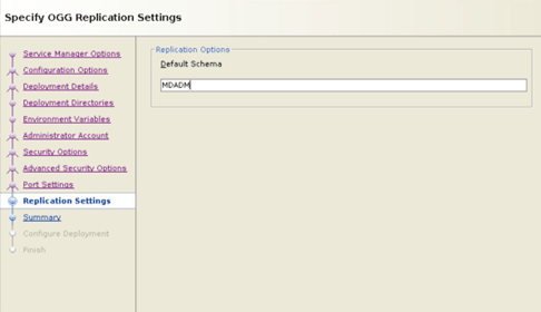

    Set the Default Schema to MDADM for the Receiver (Target) GoldenGate Microservices.
