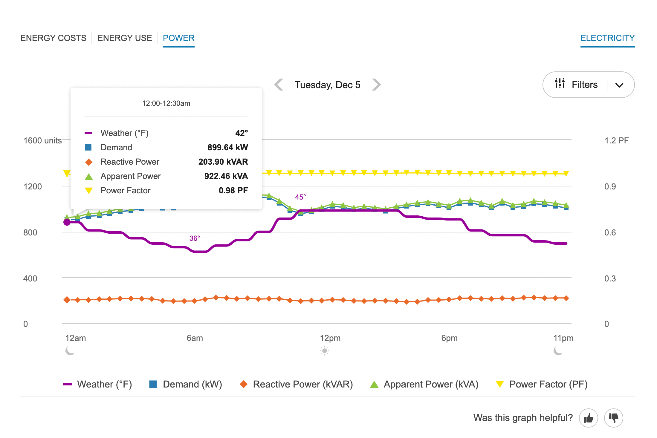

The Power view of the Data Browser shows business customers their energy demand trends over time. It can also show several types of data and power measurements over a 24-hour time period: demand, reactive power, apparent power, and power factor. Use the information below to review the available configuration options.
Power View Example
The image below is an example of the Power view for an individual day.
An example of the Power view line graph showing data for weather, demand, reactive power, apparent power, and power factor.
