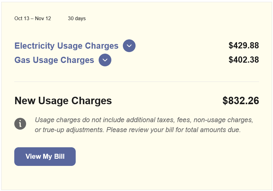

Legacy Billing Data
If the utility is using the Legacy Billing Data Transfer specification, then menus for Electricity Usage Charges and Gas Usage Charges from the most recent bill period are shown. These sections are followed by a New Usage Charges section, which displays a total of all usage charges, as well as a disclaimer about how taxes and fees are excluded. The breakdown does not include the following information: Posted On, Past Due Charges, All Other Charges, Total Charges, and Due Date.
Screenshot of the Bill Breakdown widget for customers who are dual fuel and who cannot see extra details like taxes and fees.

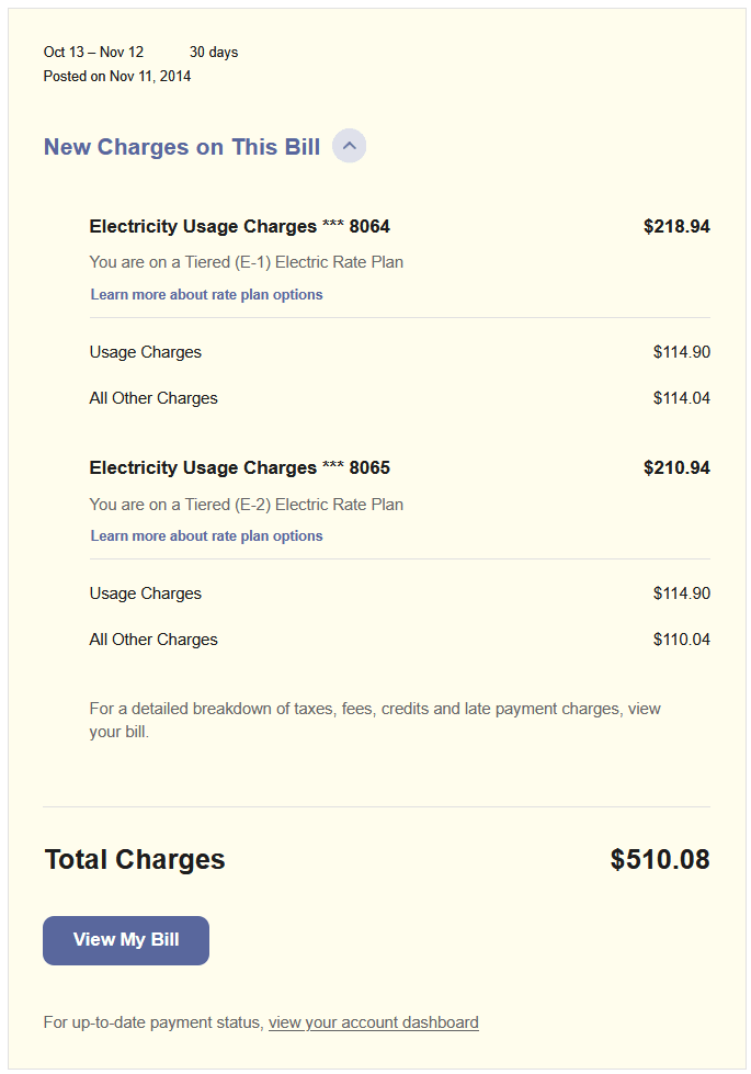

Multiple Service Agreements
If a customer has multiple service agreements for a fuel type, the breakdown shows additional information about each service agreement when the menu is expanded for each set of charges. This state is available for single and dual fuel customers.
Screenshot of the Bill Breakdown widget for customers who have multiple service agreements for a fuel type.
The details displayed for each agreement vary slightly depending on whether the utility is on the latest Billing Data Transfer specification or the Legacy Billing Data Transfer specification.
For example, if the utility is using the legacy specification, then the charges shown for each service agreement will not include taxes and fees. If the utility is using the latest specification, then customers will see a breakdown of usage charges and other all other charges.
