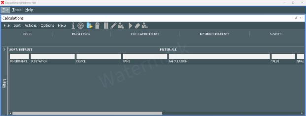

The Web Workspace Tools menu's Calculation Engine… option allows you to view the calculations configured in the system. To display the calculation engine, select Calculation Engine… from the Web Workspace Tools menu. The Calculation Engine tool will open displaying the Calculation tab.
The Calculation Engine provides access to Calculations Summary, Variables Summary, Device Class Rules Summary and the Audit Log tabs.

Understanding the Calculations Summary
The Calculation Summary provides a list of all calculations in the system. As each calculation is associated with a device this list is filtered by your zone subscriptions by default.
The Calculation Summary consists of four parts:

The Calculation Summary Table
The Calculation Summary Table contains all the calculation matching the current filters and zone subscriptions. The table displays the following information:
• The Inheritance property of the calculation. The value can be one of:
• None: The calculation is not derived from a device class rule
• Inherited: The calculation is inherited from a device class rule
• Overridden: The calculation was inherited from a device class rule but has subsequently been modified such that its definition now differs from the device class rule it was associated with.
• The Substation associated with the calculations device.
• The name of the Device associated with the calculation.
• The Name of the calculation.
• The Calculation definition.
• The real-time Value of the calculation.
• The Quality of the calculation. If this column is empty then calculation is good quality otherwise it is one of the following values:
• Parse Error: There is a syntax error in the definition of the calculation.
• Circular Reference: There exists a circular reference within this calculation. See Understanding Circular References for more details.
• Missing Dependency: There is a missing dependency within the calculation. See Understanding Missing Dependencies for more details.
• Suspect: One of the calculations dependencies is not good quality. See Understanding Quality Propagation for more details.
• Inhibit: The calculation has been inhibited by an operator.
• Manual: The value of the calculation has been manually entered by an operator.
• Override: The value of the calculation has been manually overridden by an operator.
• The Timestamp is the time the calculation value was last updated. See Understanding Timestamp Propagation for more details.
• The Error contains additional error information to facilitate understanding missing dependencies, circular references and parse errors.
• The Trigger indicates when the calculation is evaluated. The value can be one of:
• On Change: The calculation is evaluated every time one of its dependencies changes value.
• Periodic: The calculation is evaluated periodically.
• On Change and Periodic: The calculation is evaluated periodically and every time one of its dependencies changes value.
• The Periodicity is the time between periodic evaluations if the calculation trigger is set to Periodic or On Change and Periodic.
• The Comment is an operator supplied comment used when the calculation is inhibited or overridden.
• The Who column is the name of the operator who has inhibited or overridden the calculation.
• The Comment Time column is the time at which the inhibit or override operation was applied.
Truncated Results
The Calculation Summary Table will be truncated if too many rows are fetched from the server. The maximum number of calculations that can be fetched is controlled by the MaxCalculationsToFetch Event Management Rule, and defaults to 2000 rows.
