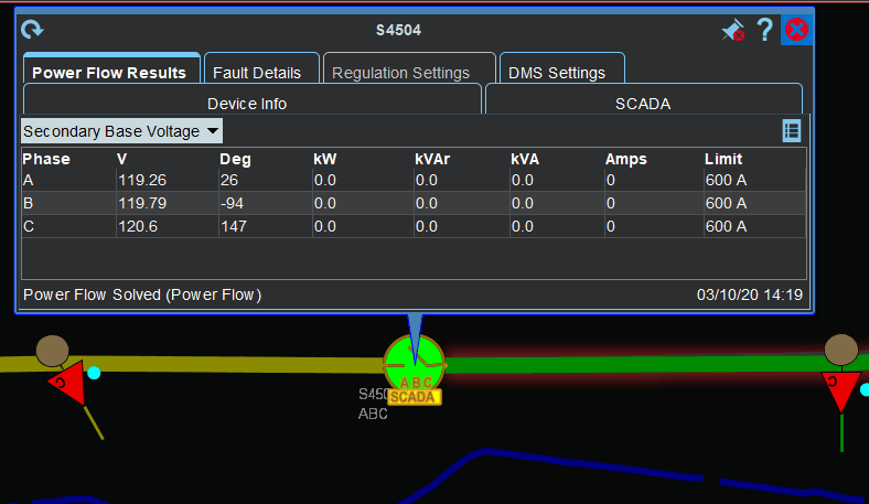

As an object is selected in the Viewer, the Power Flow Results tab updates with the calculated feeder voltages and equipment flows. The lower right corner of the Power Flow Results tab will display the time when the last solution was solved.
To view the Power Flow results for a device in real-time, follow these steps:
1. Start the Viewer. If the Viewer is in Study Mode, click the Real-Time () button to set the mode to Real-Time.
2. Click the Viewer's Device Details button () to enable Device Details.
3. Select a device.
4. Select the Power Flow Results tab to display the latest power flow results for the device.
.Screen capture of SCADA device with balloon details showing the Power Flow results tab.
Note: To view more information about the power flow conditions, click the Power Flow Solutions Details button (), which will open the Feeder Load Management Feeder Errors, Warnings, and Details dialog box.

The Device Details Power Flow Results tab displays power flow solutions in a tabular format. The date and time the last power flow solution was conducted for the selected device appears in the bottom right corner of the balloon dialog box.
