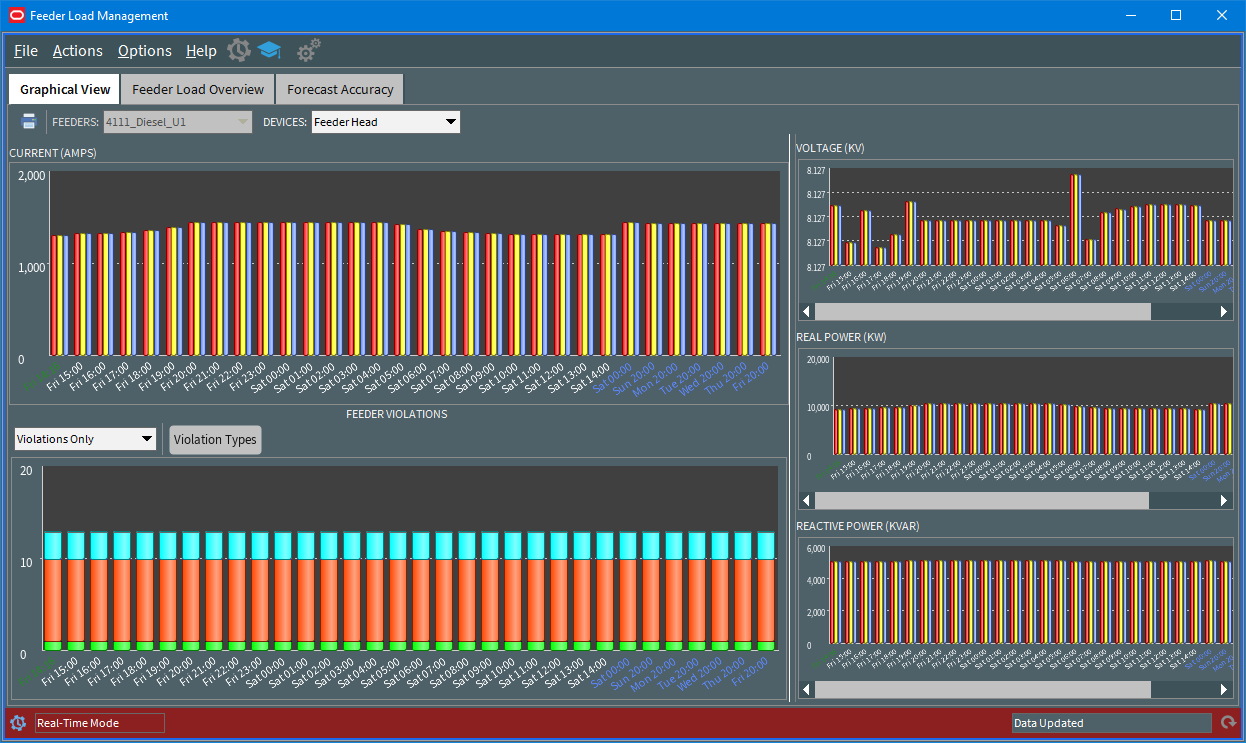

Graphical View Tab
The Graphical View tab is active when you initially start the Feeder Load Management tool. The Graphical View allows you to quickly see the trends in the forecasted data.Screen capture of the Feeder Load Management window with the Graphical View tab selected.
Use the Feeder option menu to display data for a different feeder, if the Feeder Load Management Tool is showing results for more than one feeder. Use the Devices option menu to display data for a signification device on the feeder; Feeder Head is the default selection.
The Graphical View shows five different graphs:
• Current
• Feeder Violations
• Voltages
• Real Power
• Reactive Power

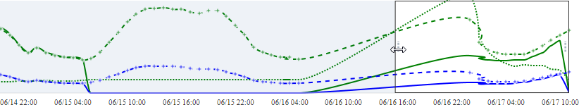

For the currents, voltages, and power graphs, the bar graphs show three bars, representing results data for three phases.
• The X axis displays the time of the forecast, with values for real-time loading, 24-hour forecast values, and 6 daily peak forecasts.
• The axis label colors are based on forecast type and are consistent with the colors used on the Date/Time column of the tabular display.
• Use the slider between the left side of the tab (displaying the Current and Violations) and the right side of the tab (displaying Voltage and Power) to resize the graphs.
When you hover over a point on a graph, a hover text box displays the actual data values, as shown below: Screen capture of the data values and their corresponding colors.

Forecast Accuracy Trend Graph
The Forecast Accuracy trend graph displays a graph of the data for the selected row. The trend graph displays the following data by default:
• Average forecast values for kW and kVAr.
• Actual values seen for kW and kVAr.
• Forecast error for kW and kVAr.
You can use the mouse wheel to zoom in and out. You can also drag the graph to see details over the time line.
You may also widen or shrink the viewport to show more or less detail. Hovering over the viewport left or right side will change the cursor to allow you to resize the box.Screen capture of graph showing resizing the range of dates displayed.
Hovering the mouse over the trend will show the value at the point in the graph.

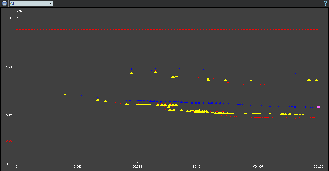

Voltage Profile Graph Tab
The Voltage Profile Graph tab displays a graph of voltage load (p.u.) versus distance from the feeder head for a feeder selected in the Feeder Load Overview Tab. The graph also displays the upper and lower ANSI Range A violation limits (1.05 and 0.95 p.u., respectively).
Note: This pane is available only when a present load row is selected in the Feeder Load Overview table.
Supply points are represented by a symbol in their phase color. You can choose to view all phases (default) or individual phases by selecting the phase from the drop-down list.
Drop-Down List Options
• All: displays all phases plotted in their respective colors.
• Phase A: Phase A loads are displayed (red dots).
• Phase B: Phase B loads are displayed (yellow triangles).
• Phase C: Phase C loads are displayed (blue squares).
Note: Bellwether loads are displayed in pink.Screen capture of the voltage profile graph.
