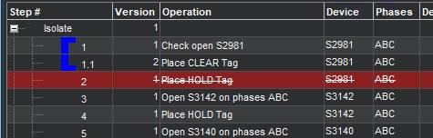

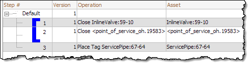

The steps table on the Steps tab displays the following fields:
• Step # displays the number of the step.
• For a block header row, this column displays the block name.
• For a step row, this column displays the step number (1 through n).
• For a sub-step within an aggregate step, such as Open & Tag, this column displays the sub-step number (a-z). Blocks and aggregate steps can be expanded or collapsed by clicking the + or - sign.
• If you are viewing the differences between this version and another version, this column uses outline numbering (1.1, 1.2, and so on) to identify steps that were added since the previous version. See Working with Switching Sheet Versions for more information.
• Version displays the version number of the switching sheet when the step was added. See Working with Switching Sheet Versions for more information.
• Operation displays the description of the switching action. When the switching action is associated to a safety document, then the safety document type and number will be displayed in this field after the switching description. This field is editable, but only if the step action is a non-operational action. In other words, if the action for this step does not impact the NMS model in any way and is not tied to another NMS tool or feature, then the text can be edited in this column. Edited text will show up with a yellow background color. To reset the value, see Resetting Operation Text.
• Asset displays the asset alias referenced in the step. If the asset is not modeled, then the Asset field will have a yellow background meaning that the asset does not have a handle or a valid NCG and cannot be focused upon in the Viewer.

Group steps
Right-click and choose Group Steps from the context menu.
Groups the selected steps and draws a bracket around them in the Steps list. This allows steps to be completed in or out of order within the grouping depending on the switching sheet type. See Grouping Steps. This option is disabled if the sheet is in view only mode or the sheet state is Completed.
Ungroup steps
Right-click and choose Ungroup Steps from the context menu.
Ungroups the selected steps and revises or removes the group bracket. (If you ungroup the third of three steps, the first 2 remain grouped.) See Ungrouping Steps. This option is disabled if the sheet is in view only mode or the sheet state is Completed.

Working with Blocks
Blocks are used to organize steps based on stages of execution. A block is a series of contiguous steps that can include both single (ungrouped) steps and groups of steps. Note the following when working with blocks:
• When you create a new sheet, the system creates an empty block named "Default." When you add steps, they are added to this block by default. You can delete this block and create a new top-level block if you wish.
• The system provides several pre-configured block headers (Isolate, Maintenance, Restore, and Construction); or you can create a custom header. The header is simply the block name that is displayed in the Steps list.
• To expand a block and display its steps, click the + symbol to the left of the block name.
To collapse a block and hide its steps, click the - symbol.
• All steps within a block must be completed before a step within another block can be completed, unless the block names are the same and the blocks are adjacent (not separated by any blocks of different names). See the Parallel Step Execution for more information about parallel execution of block steps.

Grouping and Ungrouping Steps
Step grouping allows a sheet type to enforce in or out of order step execution rules for the steps that are grouped. For Product configured switching sheets, grouped steps exhibit the opposite execution rules that non-grouped steps have. If non-grouped steps can be executed out of order, then the grouped steps have to be executed in order; the opposite is true as well. For more information on how these rules are configured for each sheet type, see Step Order Execution Rules.
The following rules apply when grouping and ungrouping steps:
• Step groupings cannot cross over Block boundaries.
• Step groupings can be removed and altered (ungrouping and regrouping) at any time. Note that this may impact which steps can be completed next based on step completion rules.
This section includes the following topics:
Grouping Steps
To group steps:
1. Select two or more contiguous steps. Remember that the grouping cannot cross Block boundaries.
2. Right-click and select Group Steps from the context menu. A blue bracket appears in the step number column to visually indicate the newly formed grouping, as shown in the following figure:
Screen capture of grouped steps.
Note: Groups cannot span more than one block. If you attempt to group steps that span two or more blocks, the system will create separate groups within each block.
Ungrouping Steps
You can ungroup some or all steps in a group. To ungroup steps:
1. Select one or more steps that are currently part of a group.
2. Click the right mouse button and select Ungroup Steps from the context menu.
The bracket is removed (if all steps were ungrouped) or redrawn to indicate the steps that remain grouped. If the selected steps were in the middle of a grouping, then two new groups are created, and the middle steps are no longer grouped.
Adding Steps to an Existing Group
You can add one or more steps to an existing group as follows:
1. Select the steps you want to add and include at least one step from the existing group.
2. Click the right mouse button and select Group Steps.
The selected steps that were previously ungrouped are added to the existing group.
Grouping Aggregate Steps
An aggregate step is an operation, such as Open and Tag, that comprises two or more sub-steps (numbered a through z). An aggregate step is treated as a single step when grouping and ungrouping steps:
• If you add any sub-step of an aggregate step to a group, then all sub-steps are added to the group.
• If you ungroup any sub-step, then all sub-steps are removed from the group.

Step Versioning
Steps also have version numbers. The step version number is the version number of the sheet when the step was added. A step's version number is displayed on the Steps tab to the right of the step number.
• If you add steps to a checked-in switching sheet, the sheet version is automatically incremented and the newly added steps are associated to this new sheet version number. This allows you to easily distinguish between steps that were previously issued to a crew and newly added steps.
• To see the differences between the current version and a previous version, open the version drop-down list on the status bar, then select the version to compare against.
When you select a version, the Step # column uses outline numbering (1.1, 1.2) to identify steps that were added since the previous version.
If you delete a step when the switching sheet version is checked-in or when an earlier version of the step exists, then the step is removed from the current version. If you view a previous version in which the step existed, the deleted step is indicated with strikethrough text and is shaded red. Screen capture of step versions with deleted step having strikethrough text.
