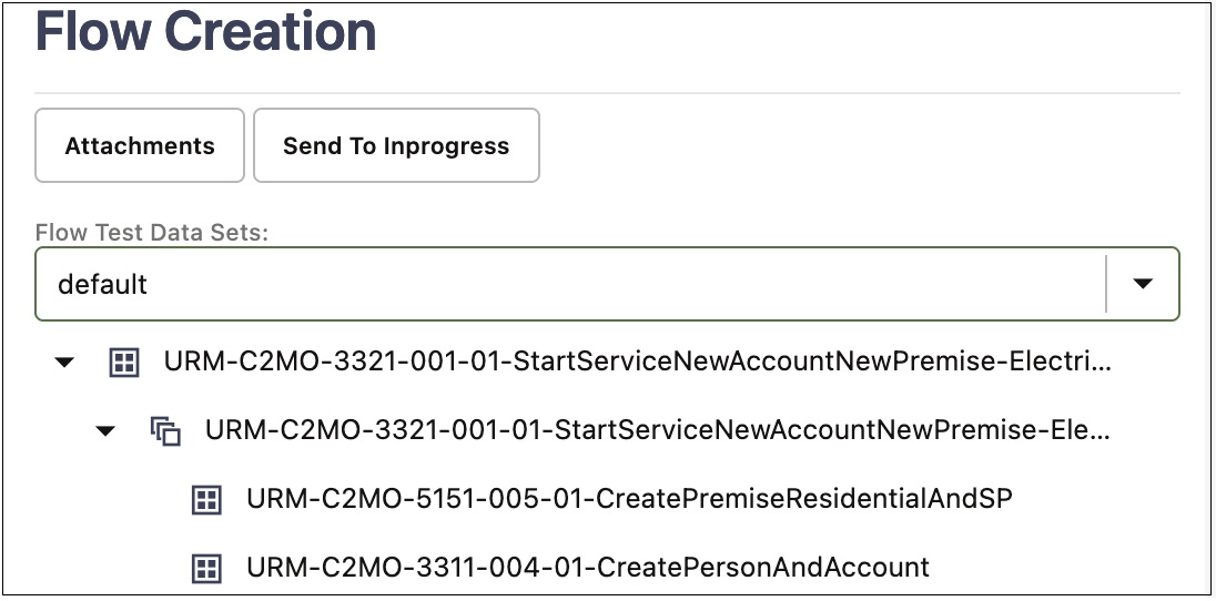

To create a flow:

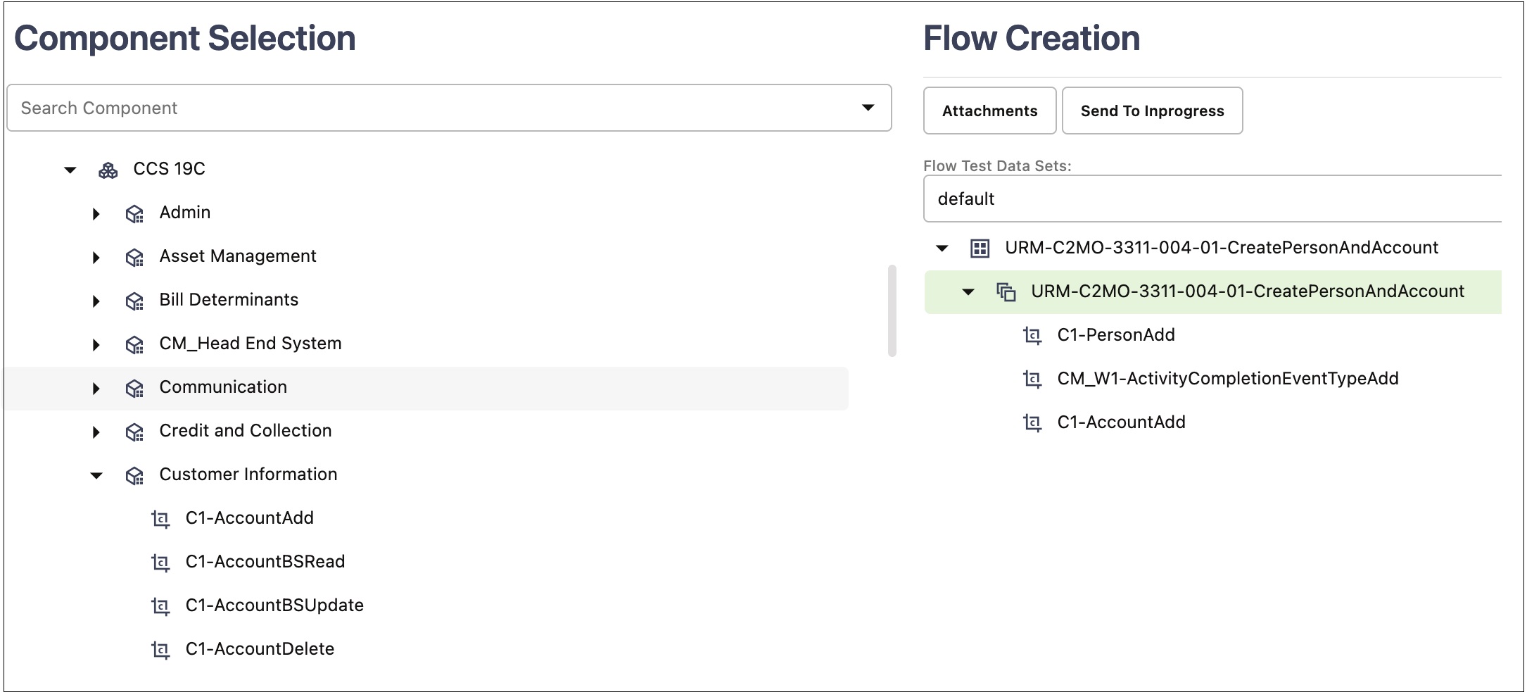

1. Navigate to the product/module in the flow tree to create the flow.
2. Right-click the product/module and select Create Flow.
3. In the Create Flow pane, enter the Flow Name, Flow Type, Tags, and Description.
4. Save in either of the following ways:
Save: Saves the flow and redirects to the Search Flow page.
Create Structure: Creates the flow with a default scenario and redirects to the Flow Structure page.
5. Expand the flow tree. The flow contains a default scenario with the same name as the flow name.
6. In the sequence defined by the business scenario being tested, drag and drop the components from the Approved Components pane to the flow scenario or components within the flow structure. The component moved will be added below the scenario/component to which it was moved. The component moved will be added to the scenario/component to which it was moved.

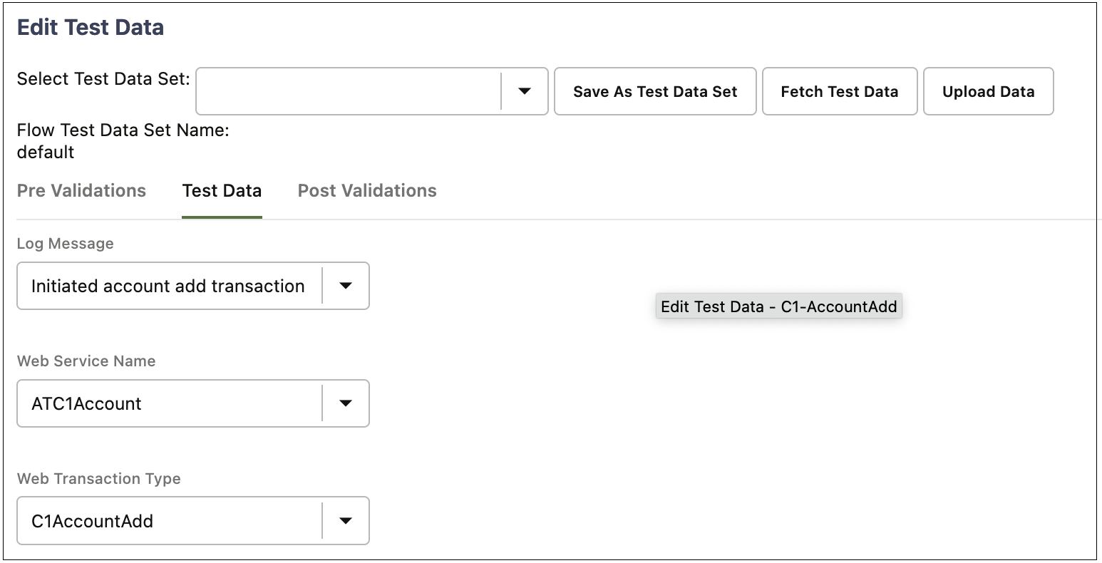

To add data to a component in a flow:
1. In the flow tree structure, right-click the component and select Edit Test Data.

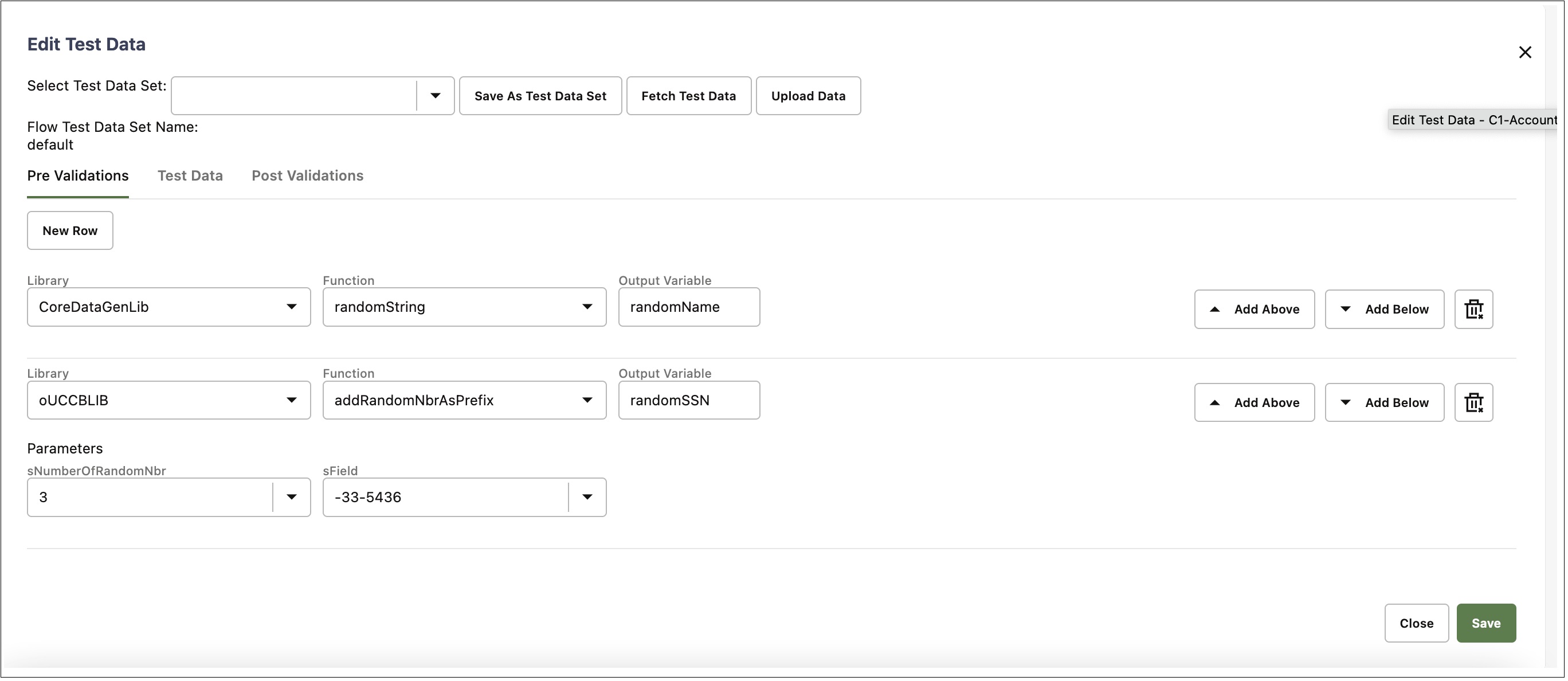

2. Enter the test data in the Test Data page. The Webservice Test Data page has 3 sections.
a. Pre Validations
The Pre Validations section can be used for specifying functions that can generate randomized test data for the flow/component step. It is used to add functions in the components that may be specific to the flow being developed. Click New Row to add new rows. The Pre Validations section is used to add functions in the components that may be specific to the flow being developed.
The library in which the function exists can be selected in the Library field. Based on the library selected the function can be selected from the Function drop-down list. If the function outputs a value, provide the custom global variable name in the Output Variable field into which the function output is stored. This variable can be used as test data in the Test Data section or in subsequent pre validations or post validations sections. The function inputs can be specified against the parameter fields, based on the number of input parameters that the function needs. The variable names defined in the pre validations and post validations sections will be automatically prefixed with “fvar” and presented in the test data field's drop down under the Global Variables section, so they can clearly be distinguished from the global variables defined in the component definition.
b. Test Data
The test data corresponding to each of the elements in the component can be specified in the Test Data GUI.
The Web Service Name and Web Transaction Type fields help define the web service end point to which the request needs to be posted to during the test execution. Most of the components have the web service name and transaction type specified as the default data in the component definition. You can select the corresponding values by clicking on the test data drop down corresponding to the web service name/transaction type fields and selecting the value under the Default Data section in the list of values.
The Log Message field appears for most of the components that have this option enabled. This is free text field and any value entered in this field will be added to the flow run summary report. This helps to identify what a component step does in a flow, by looking at the summary report.
Displays Log message, Web Service Name and Transaction Type fields.

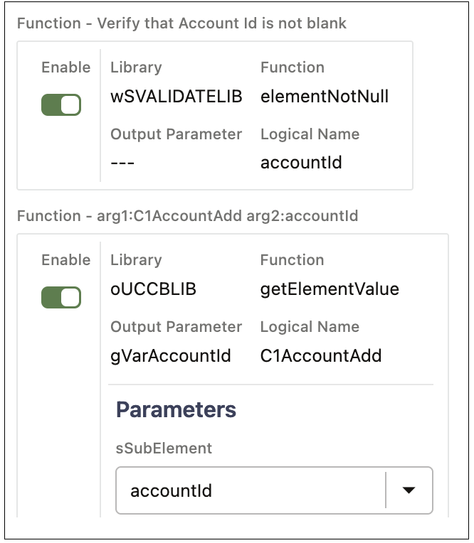

c. Post Validations
The Post Validations section is used to add verification functions post the base validations. Each of the component comes with a base set of validations and these can be disabled or enabled in the Test Data GUI using the switch corresponding to the validation line in the test data UI for the component. And, if any new or more of these verifications are to be added based on the flow specific requirements or if a specific set of values have to be retrieved from the response of the component run, the Post Validations section can be used.
The post validations section allows users to add any number of functions/validations to the component step in a flow. These will be specific to the component's instance in that flow. These will not apply to the component when used in other flows. Specification of functions in the Post Validations section follows the same pattern as the one specified in the Pre-validations section.
Only function calls can be added in the Post Validations section.The Post Validations section allows you to add any number of functions to the component in a flow.

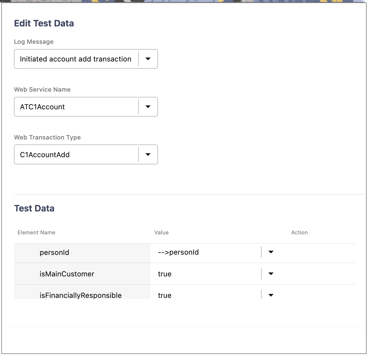

To map to non-list elements in a response:
1. Navigate to the Create/Update Flow Structure for the test flow.
2. Navigate to the Flow Test Data page of the component into which test data should be linked to. Click the downward arrow corresponding to the test data field to show the drop-down list.
3. From the list, select Data From...
In the example, the test data page corresponds to C1-AccountAdd component in the flow, which has C1-PersonAdd component preceding the C1-AccountAdd component.
The flow tree structure up to the preceding component of the current component is displayed. Shows the flow tree structure up to the preceding component of the current component.
4. Click the component from whose response the value should to be mapped. The corresponding elements in the component is displayed. Click the component from whose response the value should to be mapped.
5. Select the element from the component’s response whose value needs to be mapped to this field in the current component. The filter at the top of the xpath attributes can be used to quickly find the xpath that is needed.
In the case of the example, select the personId field from the C1-PersonAdd component.
The test data field is populated with the selected element. “-->” is prefixed to the selected element name to differentiate it from the global variables and static test data.
The following figure shows the selected personId field mapped between the components. Shows the selected personId field mapped between the components.

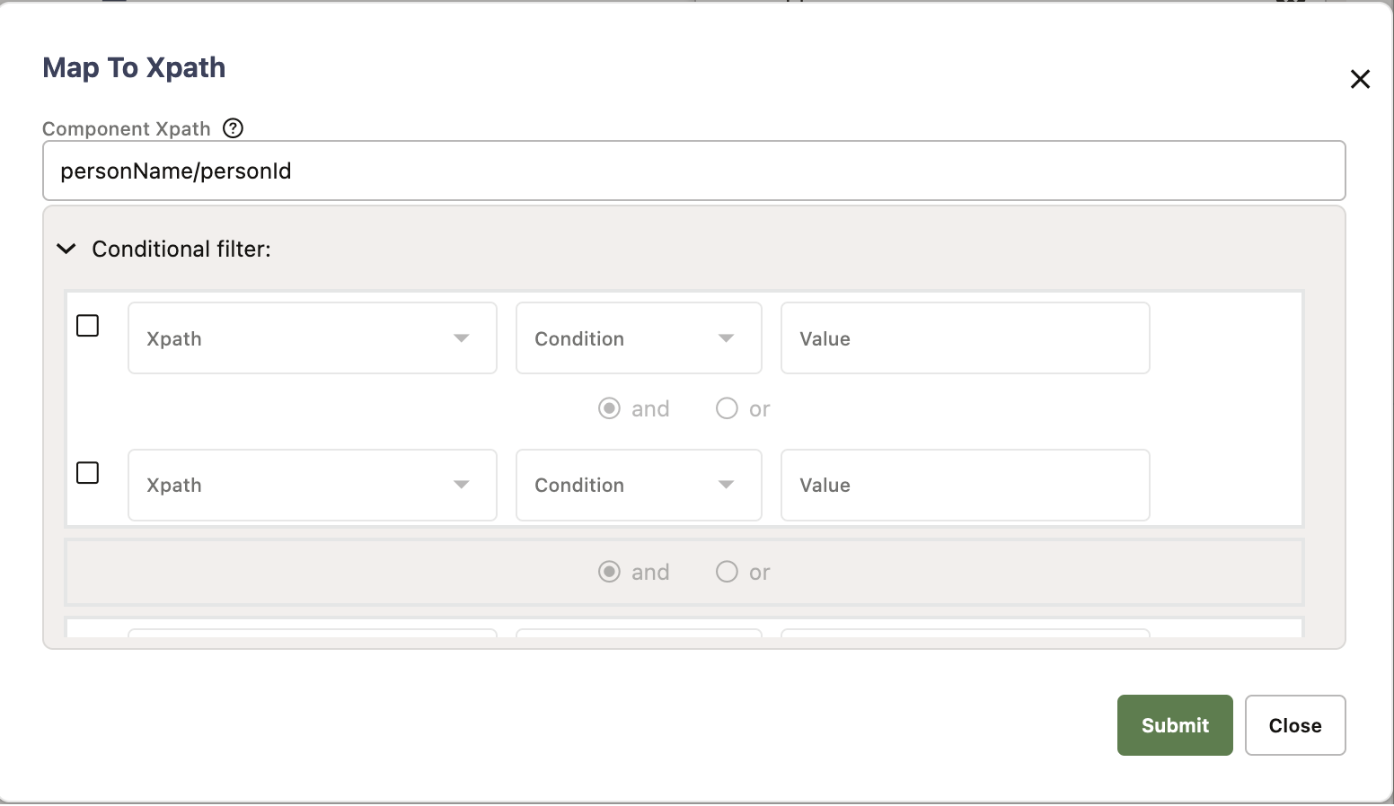

7. If the specific occurrence is not known, conditions may be applied on one or more of the list elements to find the required value from the list.
In the above example: To find the personId corresponding to the person with the name “John”, the first condition can be enabled and the condition can be specified in the condition filter. The condition to be specified should be selected in the xpath.
The list element on which the condition needs to be specified should be selected in the xpath field and a condition type can selected from the condition drop down. Based on the condition type, the value can be provided.
The supported conditions are:
“Less than”, “Less than or equal to”, “Greater than”, “Greater than or equal to”: These are applicable only to value type Number.
“Equal to”, “Not equal to”, “contains”: These are applicable to value type String.
“Equal to” and “Not equal to” condition types as applicable to value type Number as well.
If more than one condition needs to be specified, the appropriate conditions may be added by enabling succeeding condition filters. The corresponding join type also needs to be selected for multiple filters. The support join types are “And” and “Or”.
8. After specifying all conditions, click Submit to save the conditions for mapping.
9. To review or update the conditions, click the Test Data drop-down list corresponding to this field and then select Data From option. The Map to Xpath window is displayed with the current conditions.

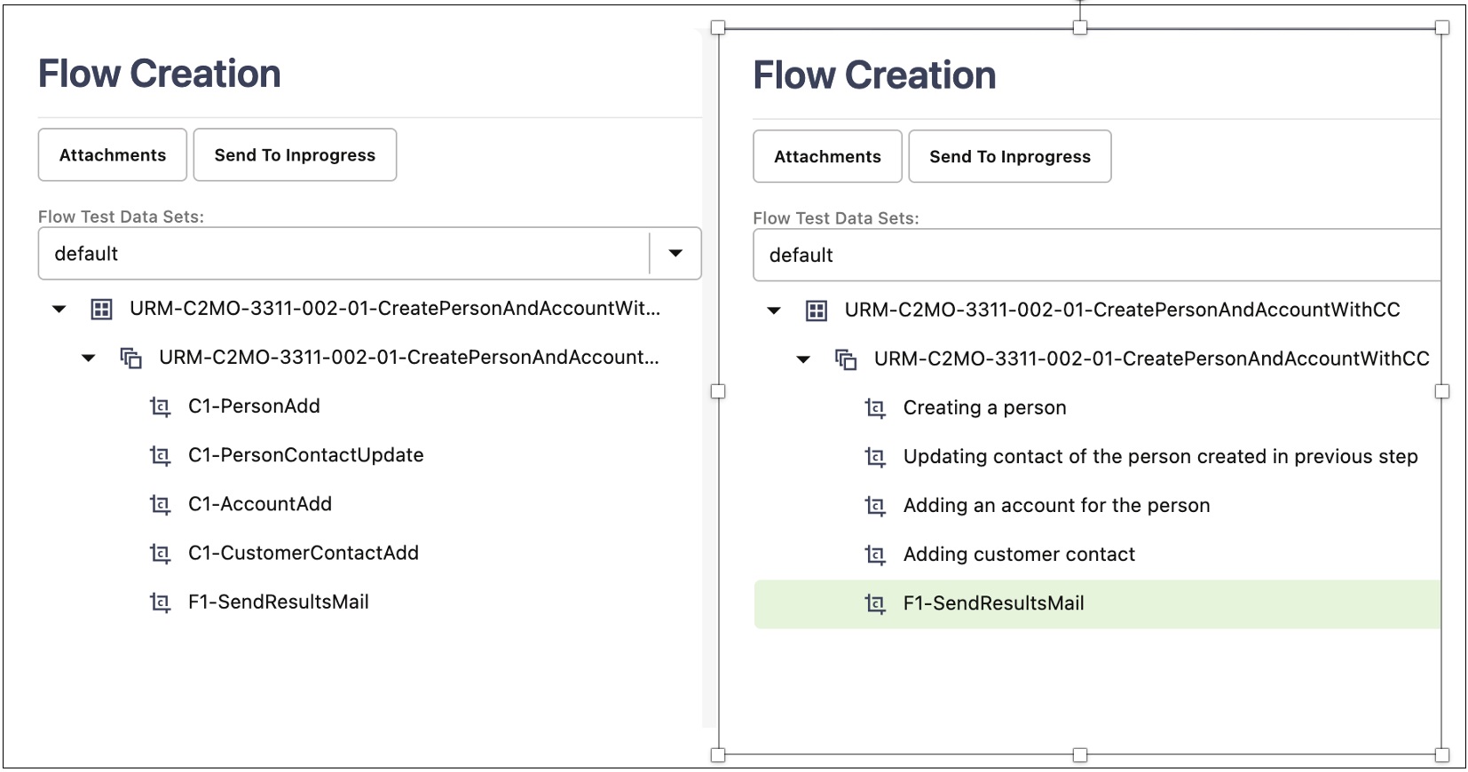

Annotating Components in a Flow
Annotations can be added for each component step to describe the purpose of each of the steps in an Oracle Utility Testing Accelerator test flow. This helps in understanding the functional aspects of the flow just by looking at the flow tree structure.
To add an annotation right-click a component step in the flow definition. Select Update Component Description and enter the description. The description replaces the default display of the component name in the flow step. The annotation can be removed or updated through the same process. Clearing the component description in the flow removes the annotation and displays the component name.
The following figure shows a flow without and with annotations:Shows a flow without and with annotations.

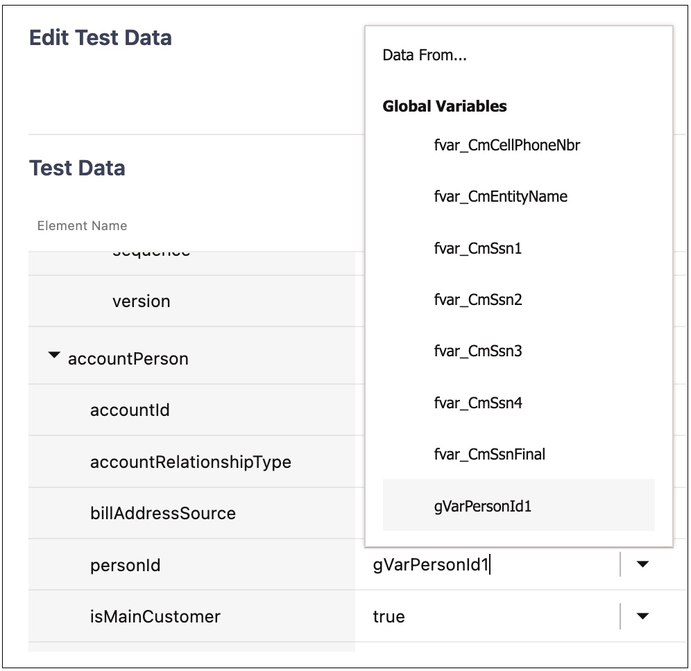

In a simple test flow, add a new person in Oracle Utilities Customer Care and Billing and add a customer contact for that person. The C1-CustomerContactAdd component is a dependent component and during runtime needs the ID of the person, created using C1-PersonAdd component within the same flow.
To add component references to a dependent component (C1-CustomerContactAdd):

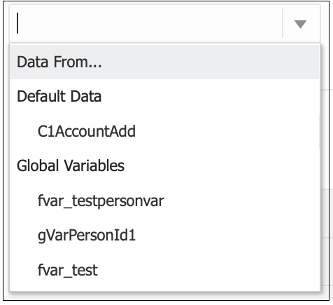

1. In the Edit Test Data GUI of the C1-CustomerContactAdd component, find the component line that requires the personId as input.
2. Against the personId row, click the downward arrow to open the Test Data drop-down list. All variables exposed by the preceding components are diaplayed in the Global Variables section.
In this case, personId exposed by the C1- PersonAdd component.
3. Select the personId variable from the drop down list and set it as test data against this element. Select the personId variable.
Each of the base components expose one or more global variables that hold the output of the component during execution. These global variables can be used to set the output of one component as the input of another component.
Additionally, global variables are also created to hold output of functions used in pre-validations or post-validations sections. These global variables are defined in the Output Variable field and are to be set against only functions that return an output value. These function based global variables are automatically pre-fixed with “fVar_” and these can be used as input in the test data of subsequent steps in the flow.
All the global variables are automatically suffixed with their occurrence number. If the C1-PersonAdd component is used twice in the flow, there will be two variables (gVarPersonId1, gVarPersonId2) one for each occurrence of the component, suffixed with it's occurrence number. Custom global variables can be defined and exposed by the components through the Pre-Validations and Post Validations sections. These variables are automatically prefixed with “fvar_”, to differentiate them from the component's base global variables. These variables are also suffixed with their occurrence number in the flow, similar to the global variables specified in the component definition.

1. Select and right-click the flow name in the Oracle Utilities Testing Accelerator flows tree structure.
2. Click Create/Update Flow Structure.
3. Click Add Global Variable Container.
4. Right-click the variable container in the flow tree structure and select Edit Test Data.
5. Define a flow variable name in the Output Variable Name field.
6. Define the variable value in the Value field.
7. Add more rows and enter the variables.
8. Click Save to save the updates.
These variables can be used as test data in the subsequent components in the flow.

3. On the Flow Definition page, navigate to the component. Right-click and select Edit Test Data.
4. On the Edit Test Data page, click Fetch Test Data.
5. On the Fetch Test Data page, enter in the web service name from which the test data has to be retrieved, operation (typically READ operation) to invoke and necessary credentials and any required info (for example: to retrieve data related to ToDoRole). Shows how to retrieve data related to ToDoRole.
6. Enter the WSDL name and operation name. Select the user and flow configuration set. Click Populate Form to populate the form with all fields that the web service supports.
Alternatively, use the URL and user credentials from the Flow/User Configuration properties file. Click Use Configuration Properties and select the appropriate flow/user configuration from the respective drop-down menus.

Adding Subroutines to a Flow
To add an existing flow as a subroutine in a flow:
1. Right-click the scenario/component in the flow.
2. Select Add SubRoutine.
3. Specify the Release, Product Family, and Product to filter the flows.
4. From the Flows drop-down list (search-able), select the flow to be included.
5. Click Add to add it to the current flow as a subroutine.
Note: A flow cannot be added to itself as a subroutine. Make sure that nested subroutines do not create a cyclic dependency.

5. In the component's Test Data section, click the Pre-Validations tab.
6. Add the “skipStep” function from the “CoreUTAOps” library. Set the test data to “true” so that the component may be skipped during the flow run.
7. If the component should not be skipped during the flow run, set the test data for the function to “false”.
Multiple test data sets can be used to set different test data for the function making sure that the specific components in which the function exists may be skipped or run based on the input to the function.

Skipping components based on outcome of a component step
In cases where certain component/components have to be skipped based on the outcome of a component step result in a flow, the “CoreVerifyConditionVariableLib” library can be used. The functions in the library can be used to validate the response for a component request, much like the functions in the WSValidateLib that are used to validate a response. But, the functions in the “CoreVerifyConditionVariableLib” library output either a false or true value, but do not fail or pass the test.
The output of the functions in “CoreVerifyConditionVariableLib” can be stored into a global variable and then the global variable may be used as input to the “skipStep” function. This allows conditional bypass/running of a component based on the outcome of another component.
Note: If a certain set of components have to be skipped as part of the flow run using this feature, add the “skipStep” function in the Pre Validations section of each of the components.
Component Test Data Sets
The component level test data sets allow to create test data sets specific to the component. These can be thought of as master test data sets for a component.
Example: For a C1-PremiseAdd component in Oracle Utilities Customer Cloud Service, the component level test data sets can be residential premise test data set and commercial premise test data set. Every time the C1-PremiseAdd component is used in a flow, instead of filling up the test data manually, the appropriate component test data set can be selected which automatically populates the test data from the component test data set into the component's test data GUI in the flow. This reduces a lot of work while providing test data in a flow.
Component test data sets save current test data of a component with a given name, which can later be retrieved and auto-populated it into another instance of the component either in the same flow or another flow.
Creating Reference Test Data for a Component
Save the current test data of a component for future use by saving it as a component test data set. After saving the test data set, the component can be populated with the test data contained in a Test Data Set. On the Edit Test Data page, select Test Data Set from the drop-down menu.
To create a test data set:
1. Login to Oracle Utilities Testing Accelerator.
2. On the Flows menu, navigate to the flow in which the component is used. Right-click and select Create/Update Flow Structure to open the Flow Definition page.
3. Navigate to the component for which the test data set needs to be created. Right-click the component and click Edit Test Data.
4. Click Save As Test Data Set to save the test data of the component. Specify the name of the test data set and click Save. Then, click OK to return to the Edit Test Data page.
Note: If a test data set with the same name already exists, the application asks for confirmation to overwrite the test data.
Loading Test Data from a Component Test Data Set
To populate the test data from a given component test data set:
3. Right-click the flow and select Create/Update Flow Structure.
4. On the Flow Definition page, navigate to the component for which the test data set needs to be created.
5. Right-click the component and then click Edit Test Data.
6. Select the test data set from the drop-down menu. The test data gets populated into the component.
Deleting Component Test Data Sets

Loading Test Data from a .csv File
Populate the test data of a component using the component’s generated databank and filling in the data in the databank. Note that this upload feature is not supported for components with nested groups.
The upload will fail if the databank is not in the same format as the generated databank for the component. The upload capability is limited to test data that does not have multilists/groups. It is recommended to use the component test data sets and flow test data sets in place of CSVs, as the features are designed to provide better reusability of test data.
To upload test data using the .csv file:
2. Navigate to the Flows menu and select the flow in which the component is used.
4. On the Flow Definition page, navigate to the component for which test data set needs to be created. Right-click the component and click Edit Test Data.
5. Click Load Data. From the window displayed, drag-and-drop the .csv file to upload.
6. Click Save to start loading the test data.
Flow Test Data Sets
Flow Test Data Sets allow users to create and manage multiple test data sets for the same flow. These test data sets can be used for selective or iterative run of the flow. This feature is aimed at creating multiple sets of test data per flow and swap between these test data sets before running a flow.
The Flow Test Data sets store the data specified against all the components within the flow, as a single data set. Users can copy the data set to create a new test data set and update it to reflect any changes. This feature has been provided to enhance reusability where test cases which do not differ in the flow structure, but only in the test data that is used, can be automated without having to recreate a test automation flow.
For more information, see the Iterative Flow Run section.

This figure shows flow test data sets option for the selected flow.
Loading Test Data from Flow Test Data Sets
To populate the test data from a given test data set:
4. On the Flow Definition page, select the test data set to be populated in the flow from the Flow Test Data Sets drop-down list.
To edit or add test data against a flow test data set, the corresponding flow test data set has to be selected on the flow structure definition pane. Navigate to the Edit Test Data page of each component in the flow and update/add the test data.
5. If the flow definition includes a subroutine, select the test data set for the subroutine. Right-click the subroutine and select Edit Test Data. Select the test data set from the Subroutine Flow Test Data Set drop-down list.
