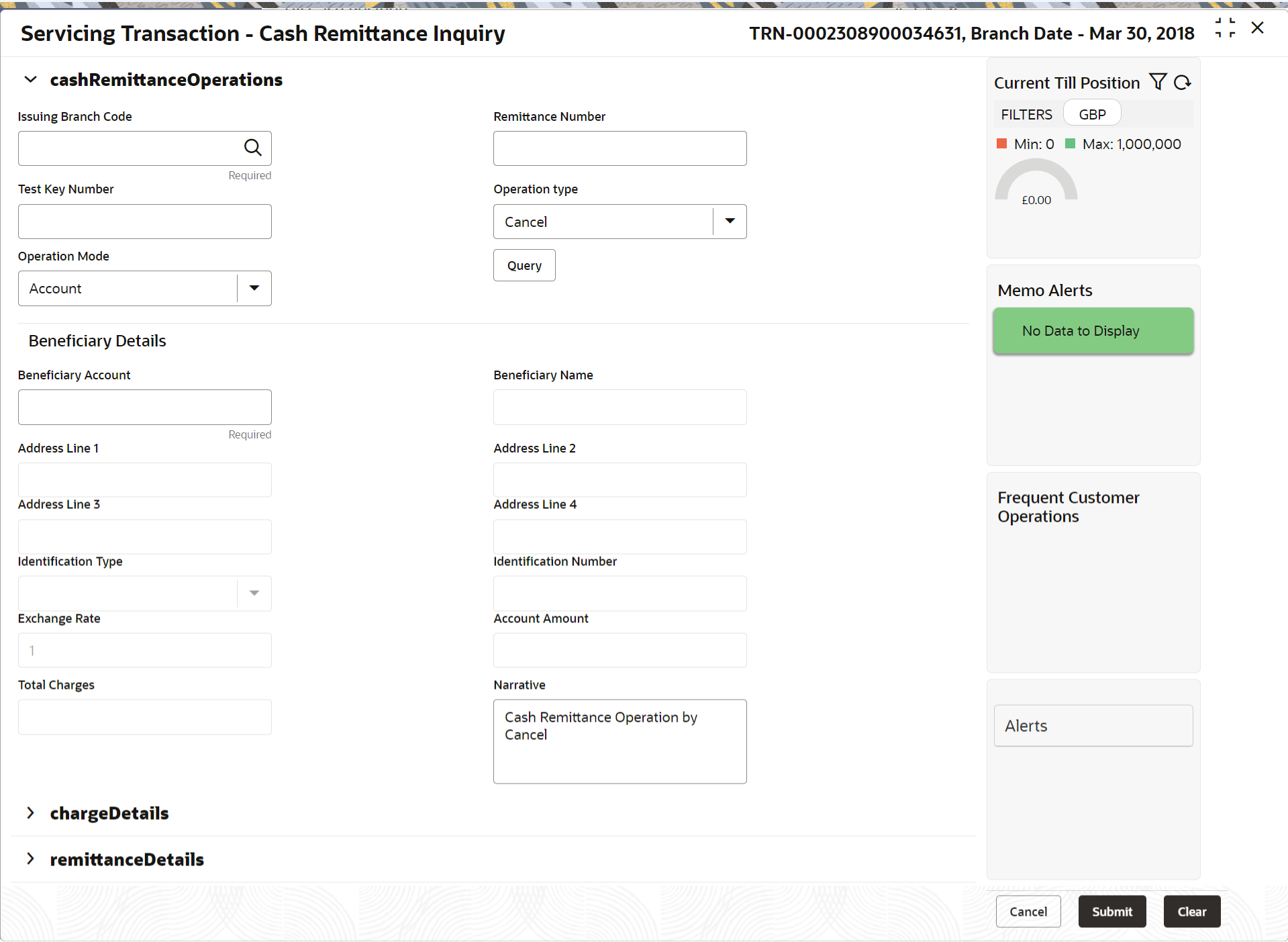

Figure 5-55 Cash Remittance Operations (Cancel by Account)
- On the Cash Remittance Operations screen, specify the
fields. For more information on fields, refer to the field description
table.
The fields marked as Required are mandatory.Table 5-53 Cash Remittance Operations (Cancel by Account) - Field Description
Field Description Issuing Branch Code
Select the branch code where the remittance is issued.
Remittance No
Specify the remittance number of the instrument.
Test Key No
Specify the test key number.
Operation Type
Select the type Cancel from the drop-down list.
Operation Mode
Select the operation mode as Account from the drop-down values.
Query
Click Query to fetch the remittance details.Note:
When you click this icon, after you specify the Issue Branch Code and Remittance No, the system will make a service call to Oracle Banking Payments and fetch the remittance details.Beneficiary Details
Specify the details under this segment.
Beneficiary Account
Displays the beneficiary account number.
Beneficiary Name
Displays the beneficiary's name.
Address Line 1 to Address Line 4
Specify the address of the beneficiary.
Identification Type
Select the identification type of the beneficiary from the drop-down values.
Identification No
Specify the identification number of the beneficiary.
Exchange Rate
Displays the exchange rate, and it can be modified.Note:
If the transaction currency is the same as the account currency, the system will display the exchange rate as 1. This field is displayed only ifMulti-Currency Configuration
at Function Code Indicator level is set as Y.Account Amount
Displays the account amount.Note:
at Function Code Indicator level is set as Y.Total Charges
Displays the total charge amount.Note:
This field is displayed only ifTotal Charges Configuration
at Function Code Indicator level is set as Y.Narrative
Displays the default narrative as Cash Remittance Operation by Cancel, and it can be modified.
