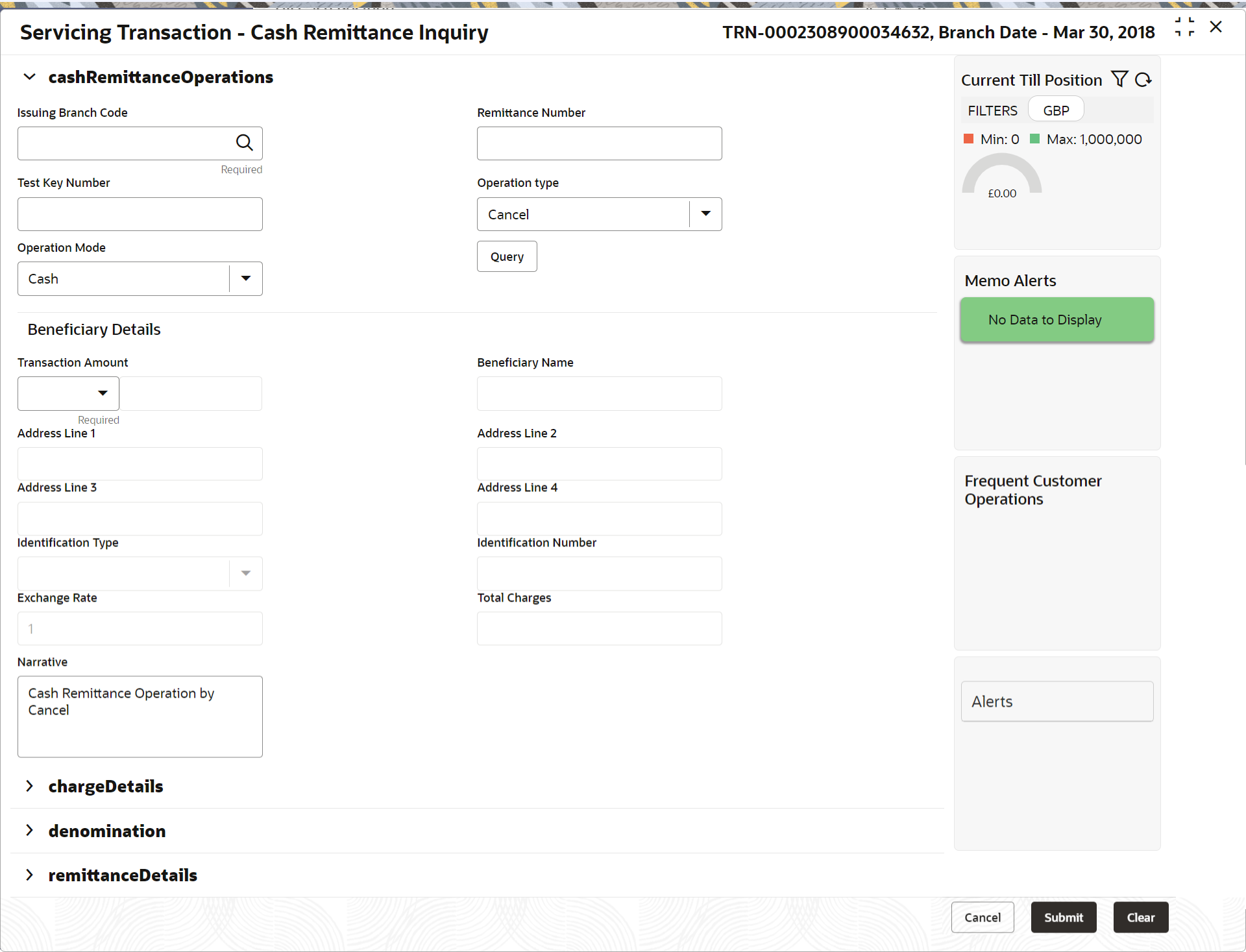

    Figure 5-56 Cash Remittance Operations (Cancel by Cash)
  2. On the Cash Remittance Operations screen, specify the fields. For more information on fields, refer to the field description table.
    The fields marked as Required are mandatory.
    Table 5-54 Cash Remittance Operations (Cancel by Cash) - Field Description
    Field Description
    Issuing Branch Code
    Select the branch code where the remittance is issued.
    Remittance No
    Specify the remittance number.
    Test Key No
    Specify the test key number.
    Operation Type
    Select the type Cancel from the drop-down list.
    Operation Mode
    Select the operation mode as Cash from the drop-down values.
    Query
    Click Query to fetch the remittance details.
    When you click this icon, after you specify the Issue Branch Code and Remittance No, the system will make a service call to Oracle Banking Payments and fetch the remittance details.
    Beneficiary Details
    Specify the details under this segment.
    Transaction Amount
    Displays the transaction currency and transaction amount.
    By default, the local branch currency is displayed as a transaction currency, and it can be modified.
    Beneficiary Name
    Specify the beneficiary name.
    Address Line 1 to Address Line 4
    Specify the address of the beneficiary.
    Identification Type
    Select the identification type of the beneficiary from the drop-down values.
    Identification No
    Specify the identification number of the beneficiary.
    Exchange Rate
    Displays the exchange rate, and it can be modified.
    If the transaction currency is the same as the account currency, the system will display the exchange rate as 1. This field is displayed only if Multi-Currency Configuration at Function Code Indicator level is set as Y.
    Total Charges
    Displays the account amount.
    This field is displayed only if Total Charges Configuration at Function Code Indicator level is set as Y.
    Narrative
    Displays the default narrative as Cash Remittance Operation by Cancel, and it can be modified.
  3. Specify the charge details. For information on the fields in the Charge Details segment, refer to cancel-cash-remittance-cash.html.
  4. Specify the denomination details. For information on the fields in the Denomination segment, refer to cancel-cash-remittance-cash.html.
  5. Click on the Remittance Details data segment to view the additional details of the remittance.
    This data segment is non-editable.
  6. Click Submit.
    A teller sequence number is generated, and the Transaction Completed Successfully information message is displayed.
