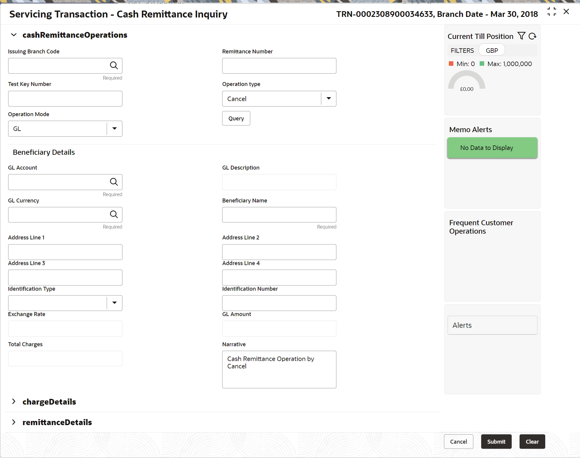

The Teller can use the Cash Remittance Operations screen to cancel a cash remittance.
The cancellation amount is credited to the GL account when the operation mode is GL.

    Figure 5-57 Cash Remittance Operations (Cancel by GL)
  2. On the Cash Remittance Operations screen, specify the fields. For more information on fields, refer to the field description table.
    The fields marked as Required are mandatory.
    Table 5-55 Cash Remittance Operations (Cancel by GL) - Field Description
    Field Description
    Issue Branch Code
    Select the branch code where the instrument is issued.
    Remittance No
    Specify the remittance number of the instrument.
    Test Key No
    Specify the test key number.
    Operation Type
    Select the type Cancel from the drop-down list.
    Operation Mode
    Select the operation mode as GL from the drop-down values.
    Query
    Click Query to fetch the remittance details.
    When you click this icon, after you specify the Issue Branch Code and Remittance No, the system will make a service call to Oracle Banking Payments and fetch the remittance details.
    Beneficiary Details
    Specify the details under this segment.
    GL Account
    Specify the GL account number.
    GL Description
    Displays the description of the specified GL account number.
    GL Currency
    Specify the currency of the specified GL account.
    Beneficiary Name
    Specify the beneficiary name.
    Address Line 1 to Address Line 4
    Specify the address of the beneficiary.
    Identification Type
    Select the identification type of the beneficiary from the drop-down values.
    Identification No
    Specify the identification number of the beneficiary.
    Exchange Rate
    Displays the exchange rate, and it can be modified.
    If the transaction currency is the same as the account currency, the system will display the exchange rate as 1. This field is displayed only if Multi-Currency Configuration at Function Code Indicator level is set as Y.
    GL Amount
    Displays the GL amount.
    Total Charges
    Displays the total charge amount.
    This field is displayed only if Total Charges Configuration at Function Code Indicator level is set as Y.
    Narrative
    Displays the default narrative as Cash Remittance Operation by Cancel, and it can be modified.
