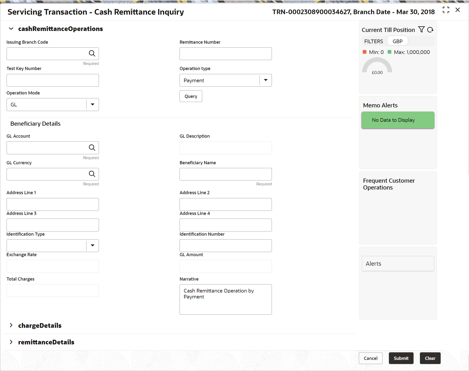

  1. On the Homepage, from Teller mega menu, under Remittances, click Cash Remittance Operations or specify Cash Remittance Operations in the search icon bar and select the screen.
    The Cash Remittance Operations screen is displayed.
    Figure 5-51 Cash Remittance Operations (Payment by GL)
  2. On the Cash Remittance Operations screen, specify the fields. For more information on fields, refer to the field description table.

    Table 5-49 Cash Remittance Operations (Payment by GL) - Field Description
    Field Description
    Issuing Branch Code
    Select the branch code where the remittance is issued.
    Remittance No
    Specify the remittance number of the instrument.
    Test Key No
    Specify the test key number.
    Operation Type
    Select the type Payment from the drop-down list.
    Operation Mode
    Select the operation mode as GL from the drop-down values.
    Query
    Click Query to fetch the remittance details.
    When you click this icon, after you specify the Issue Branch Code and Remittance No, the system will make a service call to Oracle Banking Payments and fetch the remittance details.
    Beneficiary Details
    Specify the details under this segment.
    GL Account
    Specify the GL account number.
    GL Description
    Displays the description of the specified GL account number.
    GL Currency
    Displays the branch local currency of the specified GL account.
    You can also select a currency from the list of values.
    Beneficiary Name
    Specify the beneficiary name.
    Address Line 1 to Address Line 4
    Specify the address of the beneficiary.
    Identification Type
    Select the identification type of the beneficiary from the drop-down values.
    Identification Number
    Specify the identification number of the beneficiary.
    Exchange Rate
    Displays the exchange rate, and it can be modified.
    If the transaction currency is the same as the account currency, the system will display the exchange rate as 1. This field is displayed only if Multi-Currency Configuration at Function Code Indicator level is set as Y.
    GL Amount
    Displays the GL amount.
    Total Charge Amount
    Displays the total charge amount.
    This field is displayed only if Total Charges Configuration at Function Code Indicator level is set as Y.
    Narrative
    Displays the default narrative as Cash Remittance Operation by Payment, and it can be modified.
  3. Specify the charge details. For information on the fields in the Charge Details segment, refer to cash-remittance-payment-gl.html.
  4. Click on the Remittance Details data segment to view the additional details of the remittance.
    This data segment is non-editable.
  5. Click Submit.
    A teller sequence number is generated, and the Transaction Completed Successfully information message is displayed.
    The transaction is moved to authorization in case of any warning raised when the transaction saves.
    On transaction submission, the system will hand off the request to Oracle Banking Payments using Instrument Pay Service. If the remittance is issued by another bank, the Oracle Banking Branch has to provide the test key number during handoff for validation. On transaction completion, the Oracle Banking Branch will hand off accounting to FLEXCUBE Universal Banking for the main leg.
