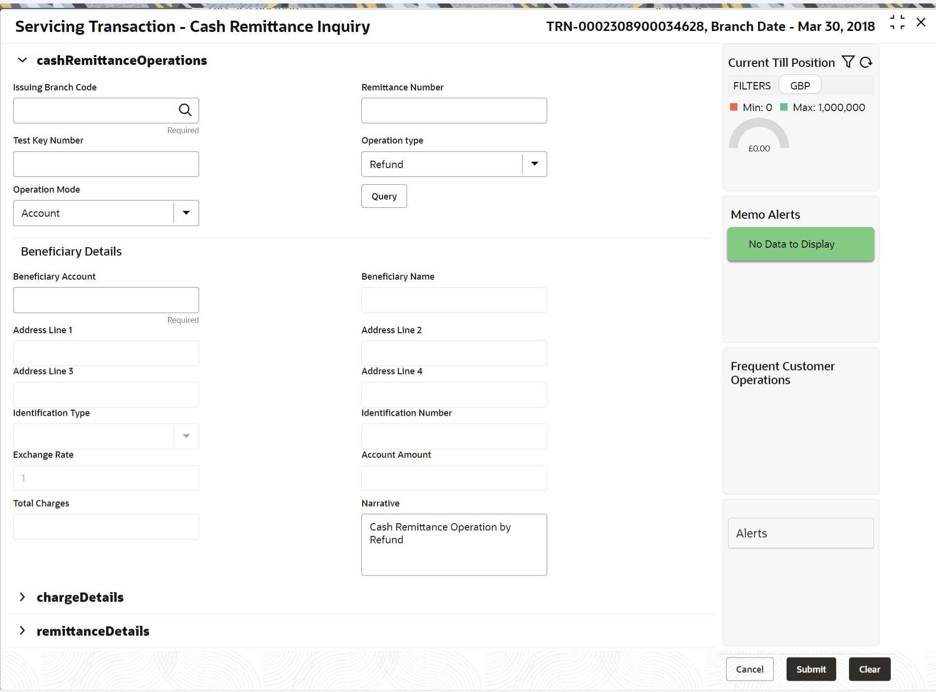

5.3.2.5 Cash Remittance Refund by Account
The Teller can use the Cash Remittance Operations screen to refund the amount against a cash remittance.
The refund amount is credited to the beneficiary customer account when the operation mode is Account.
To refund the amount:
  1. On the Homepage, from Teller mega menu, under Remittances, click Cash Remittance Operations or specify Cash Remittance Operations in the search icon bar and select the screen.
    The Cash Remittance Operations screen is displayed.
    Figure 5-52 Cash Remittance Operations (Refund by Account)
  2. On the Cash Remittance Operations screen, specify the fields. For more information on fields, refer to the field description table.
    The fields marked as Required are mandatory.
    Table 5-50 Cash Remittance Operations (Refund by Account) - Field Description
    Field Description
    Issue Branch Code
    Select the branch code where the remittance is issued.
    Remittance No
    Specify the remittance number.
    Test Key No
    Specify the test key number.
    Operation Type
    Select the type Refund from the drop-down list.
    Operation Mode
    Select the operation mode as Account from the drop-down values.
    Query
    Click this icon to fetch the remittance details.
    When you click this icon, after you specify the Issue Branch Code and Remittance No, the system will make a service call to the Oracle Banking Payments and fetch the remittance details.
    Beneficiary Details
    Specify the details under this segment.
    Beneficiary Account
    Displays the beneficiary account number.
    Beneficiary Name
    Displays the beneficiary's name.
    Address Line 1 to Address Line 4
    Specify the address of the beneficiary.
    Identification Type
    Select the identification type of the beneficiary from the drop-down values.
    Identification Number
    Specify the identification number of the beneficiary.
    Exchange Rate
    Displays the exchange rate, and it can be modified.
    If the transaction currency is the same as the account currency, the system will display the exchange rate as 1. This field is displayed only if Multi-Currency Configuration at Function Code Indicator level is set as Y.
    Account Amount
    Displays the account amount.
    Total Charge Amount
    Displays the total charge amount.
    This field is displayed only if Total Charges Configuration at Function Code Indicator level is set as Y.
    Narrative
    Displays the default narrative as Cash Remittance Operation by Refund, and it can be modified.
  3. Specify the charge details. For information on the fields in the Charge Details segment, refer to cash-remittance-refund-account.html.
  4. Click on the Remittance Details data segment to view the additional details of the remittance.
    This data segment is non-editable.
  5. Click Submit.
    A teller sequence number is generated, and the Transaction Completed Successfully information message is displayed.
