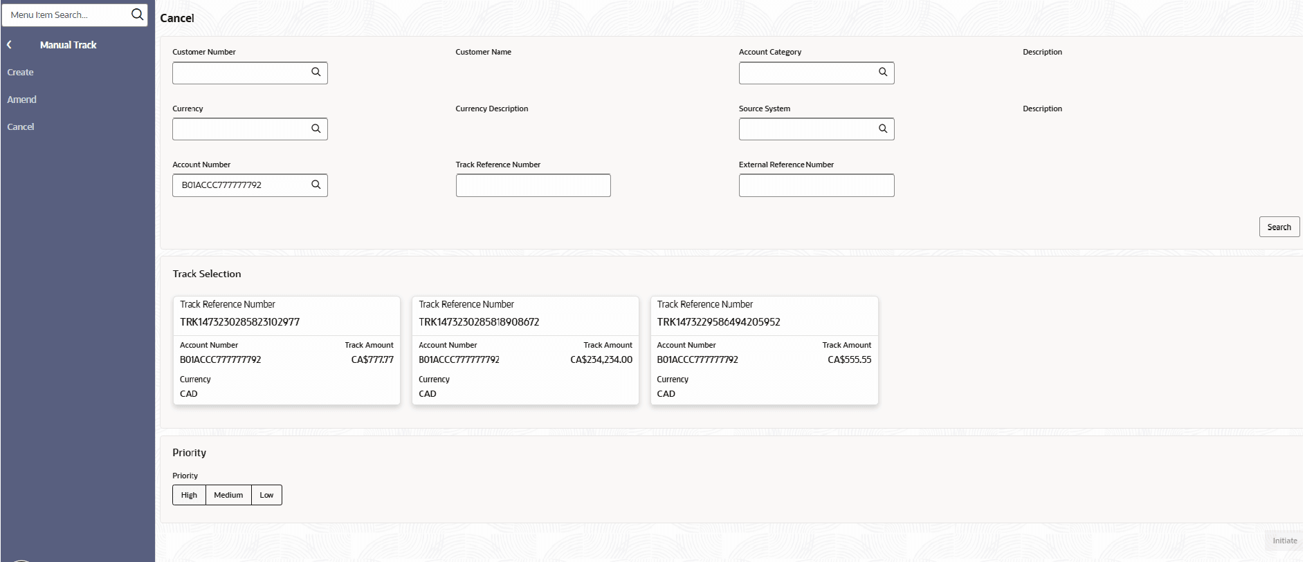

  1. Click Cancel under Manual Track.
    The Manual Track Entry page displays.
    For more information on fields refer to the field description table.
    Table 1-21 Cancel Manual Track
    Field Description
    Customer Number Click Search icon to select the customer number.
    Customer Name Displays the customer name.
    Account Category Displays the account category.
    Currency Displays the currency.
    Currency Description Displays the currency description.
    Source System Displays the source system.
    Account Number Click Search icon to select the account number.
    Track Reference Number Displays the track reference number.
    External Reference Number Displays the External Reference Number.

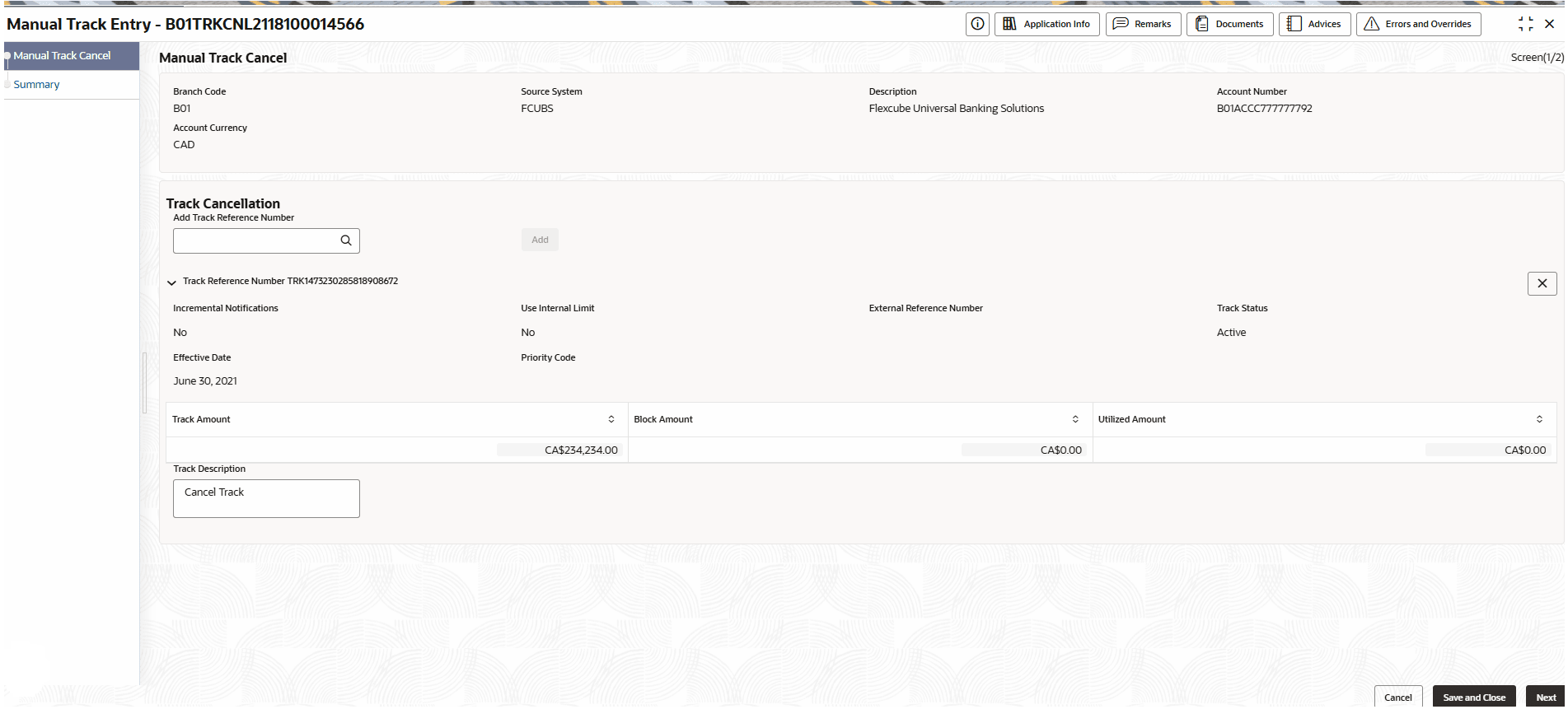

  2. Click and select the required account tile, then click Initiate.
    The Manual Track Cancel page displays.
    Figure 1-39 Manual Track Cancel
  3. Click Next.
    The Summary screen displays the edited or new tiles with a check mark in green on the bottom right of the tile.
  4. Click Submit from the Summary screen.

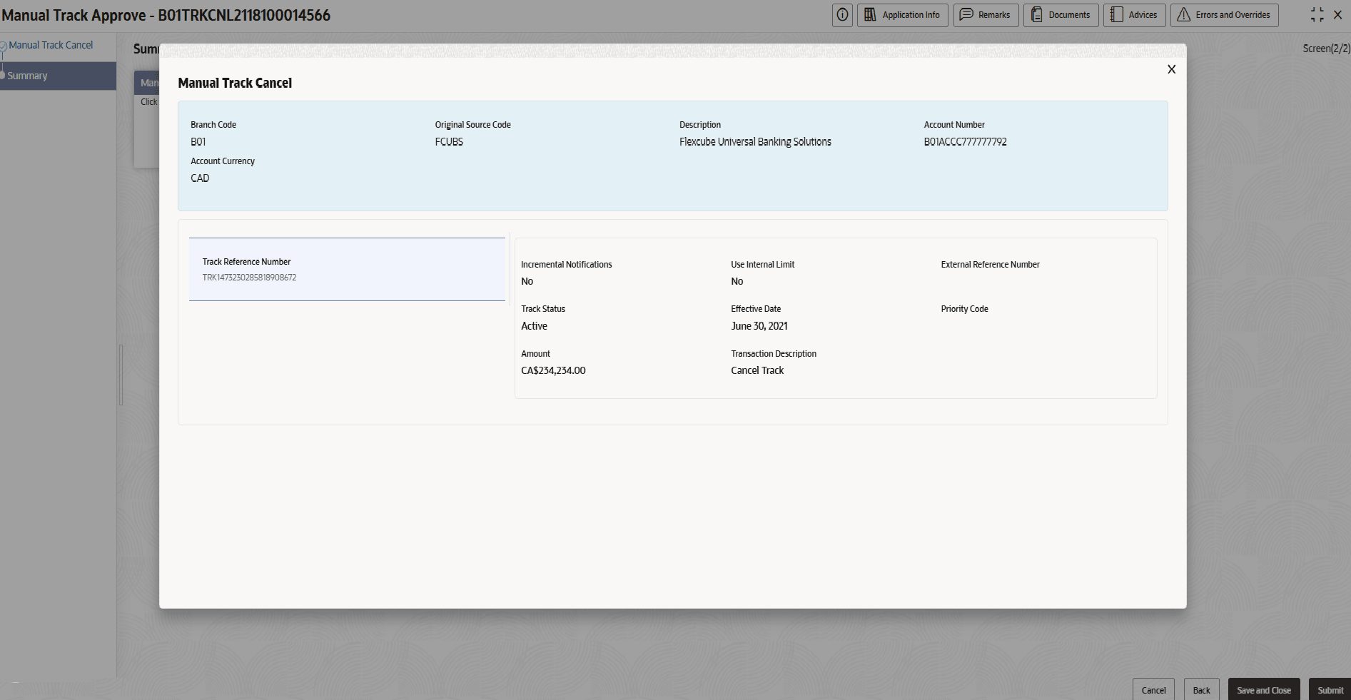

  7. Click Acquire and Edit.
    The Manual Track Approve page displays.
  8. Click Next.
    Figure 1-40 Manual Track Cancel
  9. Review the updated Manual Track Details and click Submit from the Summary page.

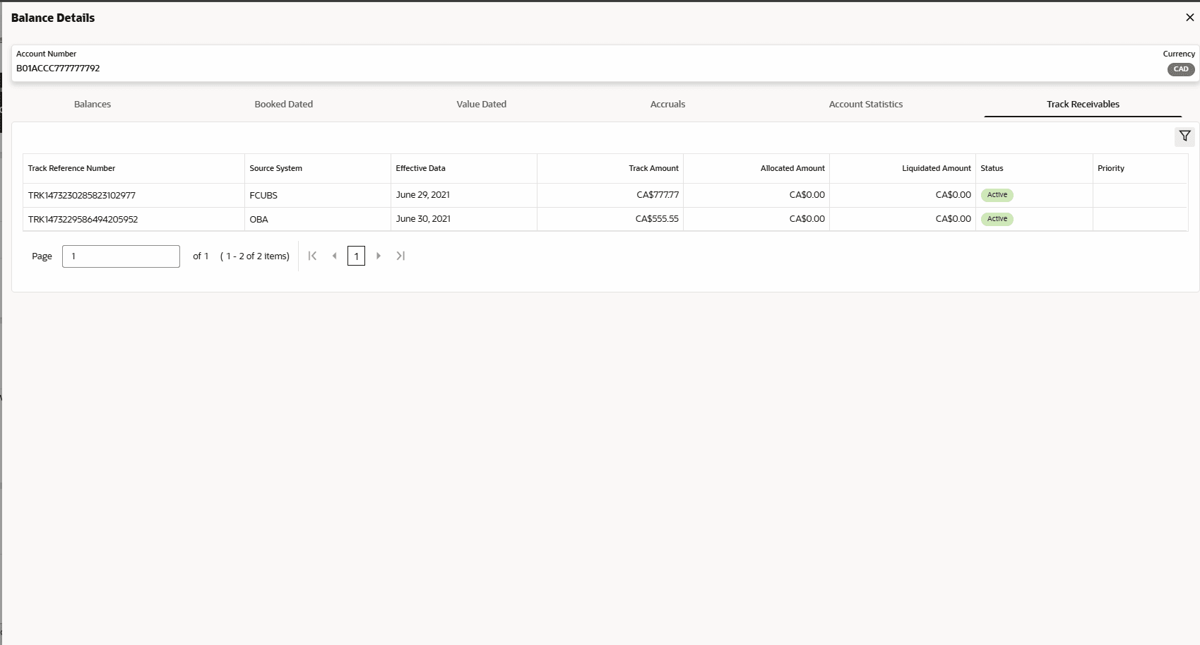

  11. Confirm that the account has the Track Receivable.
    1. Click Tasks, and under Tasks, click Completed Tasks.
      The Completed Tasks page should display Entry and Approval stages.
    2. View the account balance details in the 360 view and click on Track Receivable tab.
      The Balance Details Page displays.

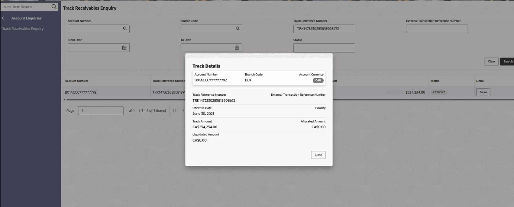

  12. Click Track Receivables Enquiry under Account Enquiry.
    The Track Receivables Enquiry Page displays with Track Details.
