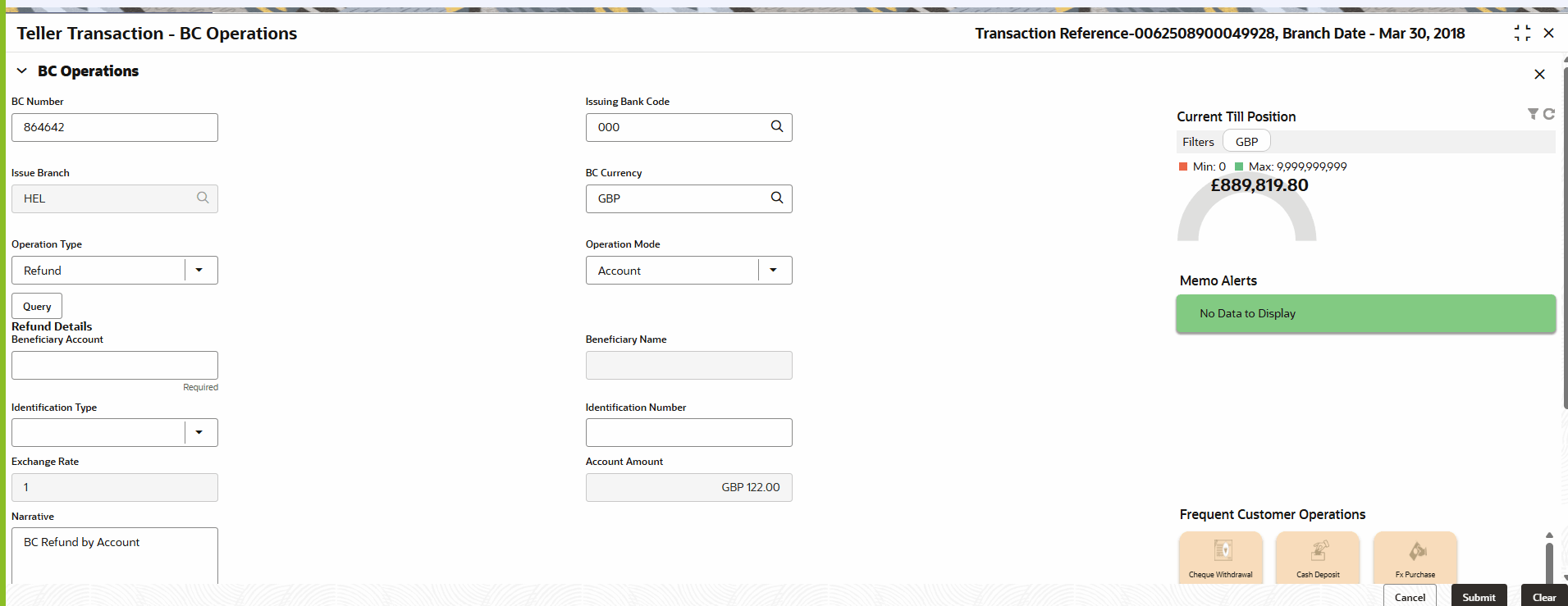

The Teller can use the BC Operations screen to refund the amount against a BC.
The BC refund is made by cash to the beneficiary when the operation mode is Cash.
To refund the amount:
  1. On the Home page, from Teller mega menu, under Remittances, click BC Operations or specify BC Operations in the search bar and select the screen.
    The BC Operations screen is displayed.
    Figure 5-15 BC Operations - Refund by Cash
  2. On the BC Operations screen, specify the fields. For more information on fields, refer to the field description table.
    The fields marked as Required are mandatory.
