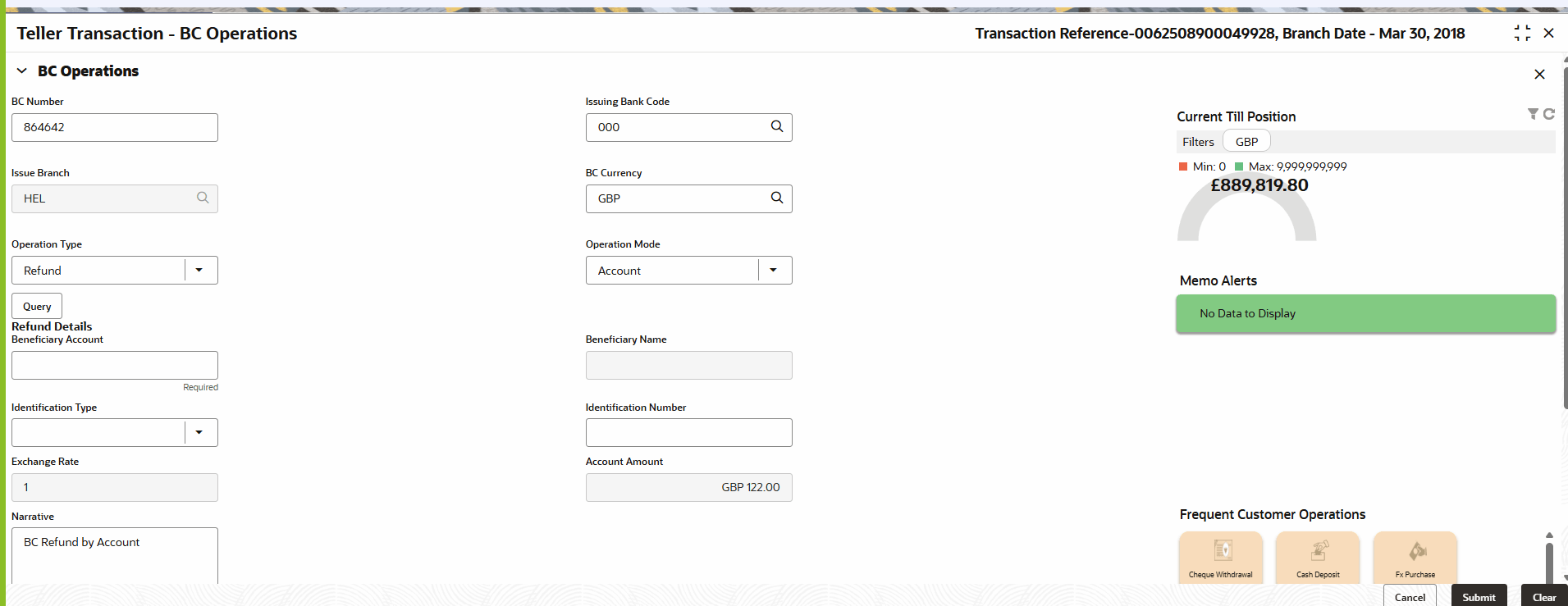

The Teller can use the BC Operations screen to refund the amount against a BC.
The BC payment is credited to the GL account when the operation mode is GL.
To refund the amount:
  1. On the Home page, from Teller mega menu, under Remittances, click BC Operations or specify BC Operations in the search bar and select the screen.
    The BC Operations screen is displayed.
    Figure 5-16 BC Operations - Refund by GL
  2. On the BC Operations screen, specify the fields. For more information on fields, refer to the field description table.
    The fields marked as Required are mandatory.

  3. Specify the charge details. For information on the fields in the Charge Details segment, refer to Charge Details.
  4. Click on the View BC Details data segment to view the additional details of the BC.
    This data segment is non-editable.
  5. Click Submit.
    A teller sequence number is generated, and the Transaction Completed Successfully information message is displayed.
