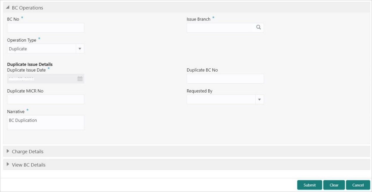

    Figure 8-19 BC Operations - Duplicate Issue
  2. On the BC Operations screen, specify the fields. For more information on the fields in the BC Operations screen, refer to Table 8-15.
