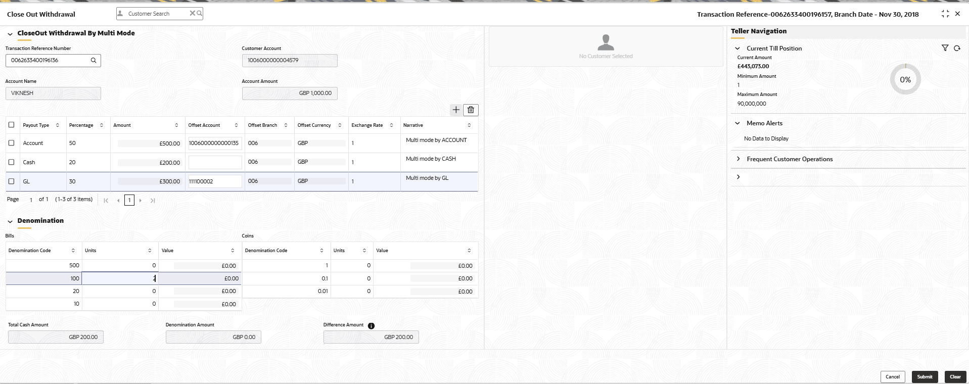

    Figure 4-14 Close Out Withdrawal by Multi Mode
  2. On the Close Out Withdrawal by Multi Mode screen, specify the fields. For more information on fields, refer to the field description table.

  3. Specify the denomination details. For information on the fields in the Denomination Details segment, refer to Add Denomination Details.
  4. Specify the charge details. For information on the fields in the Charge Details segment, refer to Charge Details.
  5. Click Submit.
