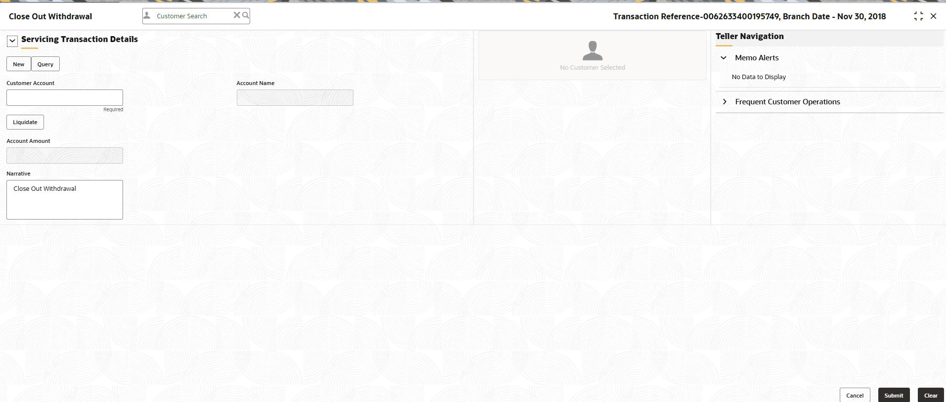

  1. On the Homepage, from Teller mega menu, under Customer Transaction, click Close Out Withdrawal or specify Close Out Withdrawal in the search bar and select the screen.
    The Close Out Withdrawal screen is displayed.
    Figure 4-11 Close Out Withdrawal
  2. On the Close Out Withdrawal screen, specify fields. For more information on fields, refer to the field description table.
    Table 4-10 Close Out Withdrawal - New
    Field Description
    Customer Account
    Specify the account number for which the account closure to be requested.
    The system displays an override or error message on the tab out of Account Number based on the account dormancy parameters.
    Account Name
    Displays the name of the specified account number.
    IC Liquidate
    Click this button to liquidate interest on accounts online before proceeding with account closure process.
    The system will prompt an error if Submit button is clicked before liquidating the interest.
    Account Amount
    Displays the account balance in account currency post liquidating the interest on account.
    Narrative
    Displays the default narrative Close Out Withdrawal and it can be modified.
  3. Click Submit.
    A teller sequence number is generated, and the Transaction Completed Successfully information message is displayed.
    The transaction is moved to authorization in case of any approval warning raised when the transaction saves. On transaction submission, it will verify if IC liquidation is completed for the account. Once the IC liquidation is done, the transaction details are handed off to the CASA module in the DDA for the account closure process. During account closure process, the closure amount will be parked in the intermediary suspense GL specified during transaction request handoff.
    Maintain Close mode as CASH and linked product as ZRCD in Account Closing Maintenance (STDCLSMD) in FCUBS. This maintenance will ensure the funds are parked to the respective suspense GL during the account closure process at FCUBS.

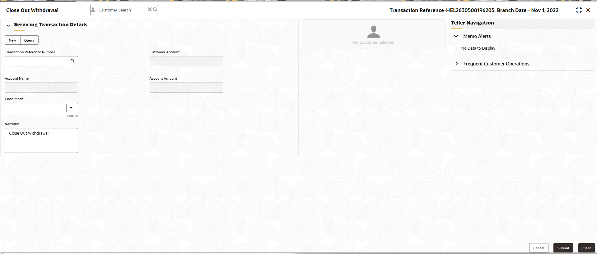

  4. Click Query.
    The Close Out Withdrawal - Query screen is displayed.
    Figure 4-12 Close Out Withdrawal - Query Transaction
  5. On the Close Out Withdrawal screen, specify fields. For more information on fields, refer to the field description table.
    Table 4-11 Close Out Withdrawal
    Field Description
    Transaction Reference Number
    Specify the transaction reference number for which the closure is initiated.
    Customer Account
    Displays the customer account number.
    Account Amount
    Displays the account balance in account currency.
    Close Mode
    Select the close mode from the following drop-down values:
    • Account
    • Cash
    • Bankers Cheque
    Narrative

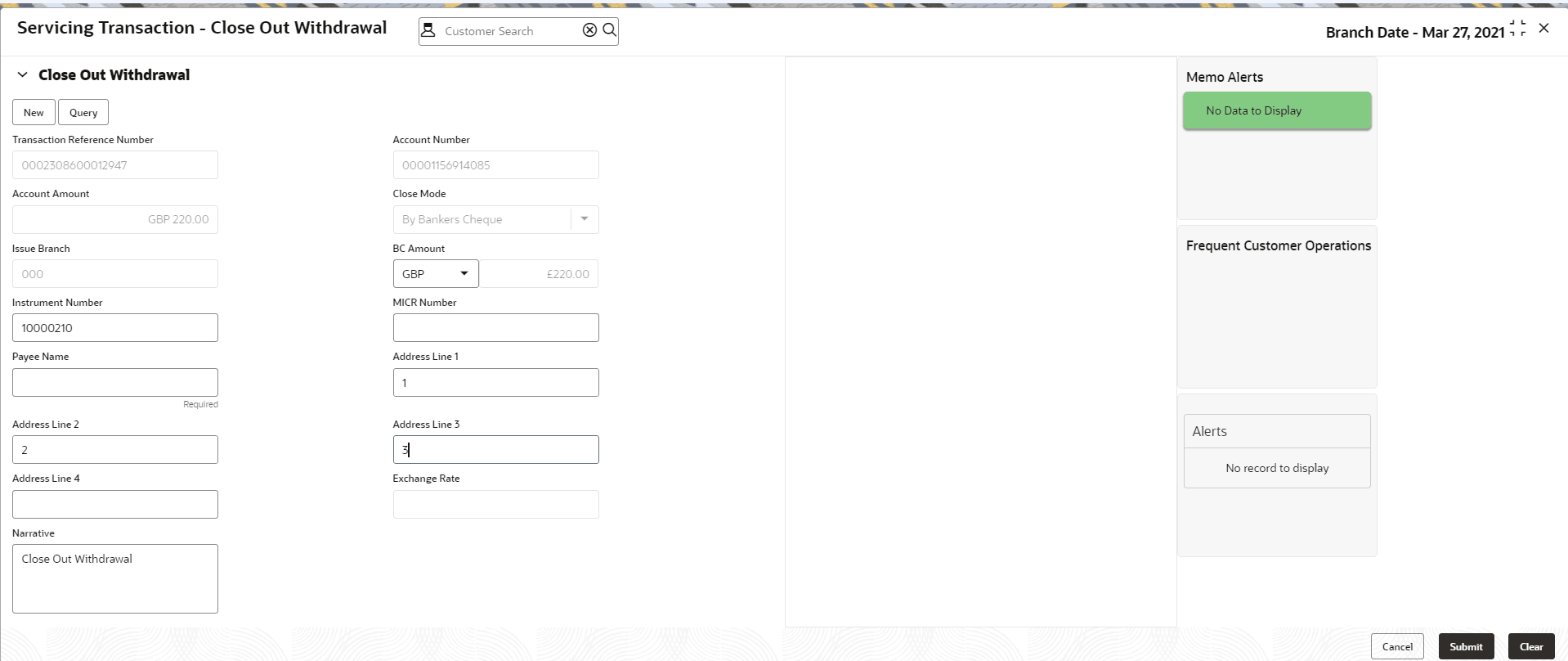

    Figure 4-13 Close Out Withdrawal - Bankers Cheque
    On the Close Out Withdrawal by Bankers Cheque screen, specify the fields. For more information on fields, refer to the field description table.
    Table 4-14 Close Out Withdrawal by Bankers Cheque - Field Description
    Field Description
    Displays the transaction reference number for which the closure is initiated.
    Account Number
    Displays the account number for which the account closure is to be requested.
    Account Amount
    Close Mode
    Displays the close mode as By Bankers Cheque.
    Issue Branch
    Displays the issuing branch of the banker's cheque.
    BC Amount
    Displays the account currency and account balance. You can also modify the account currency.
    Instrument Number
    Specify the instrument number.
    MICR Number
    Specify the MICR number.
    Payee Name
    Specify the payee name.
    Address Line 1 to Address Line 4
    Specify the address of the payee.
    Exchange Rate
    Displays the exchange rate used to convert the transaction currency into account currency, and it can be modified.
    This field is displayed only if Multi-Currency Configuration at Function Code Indicator level is set as Y.
    Narrative
    Displays the default narrative as Close Out Withdrawal, and it can be modified.
