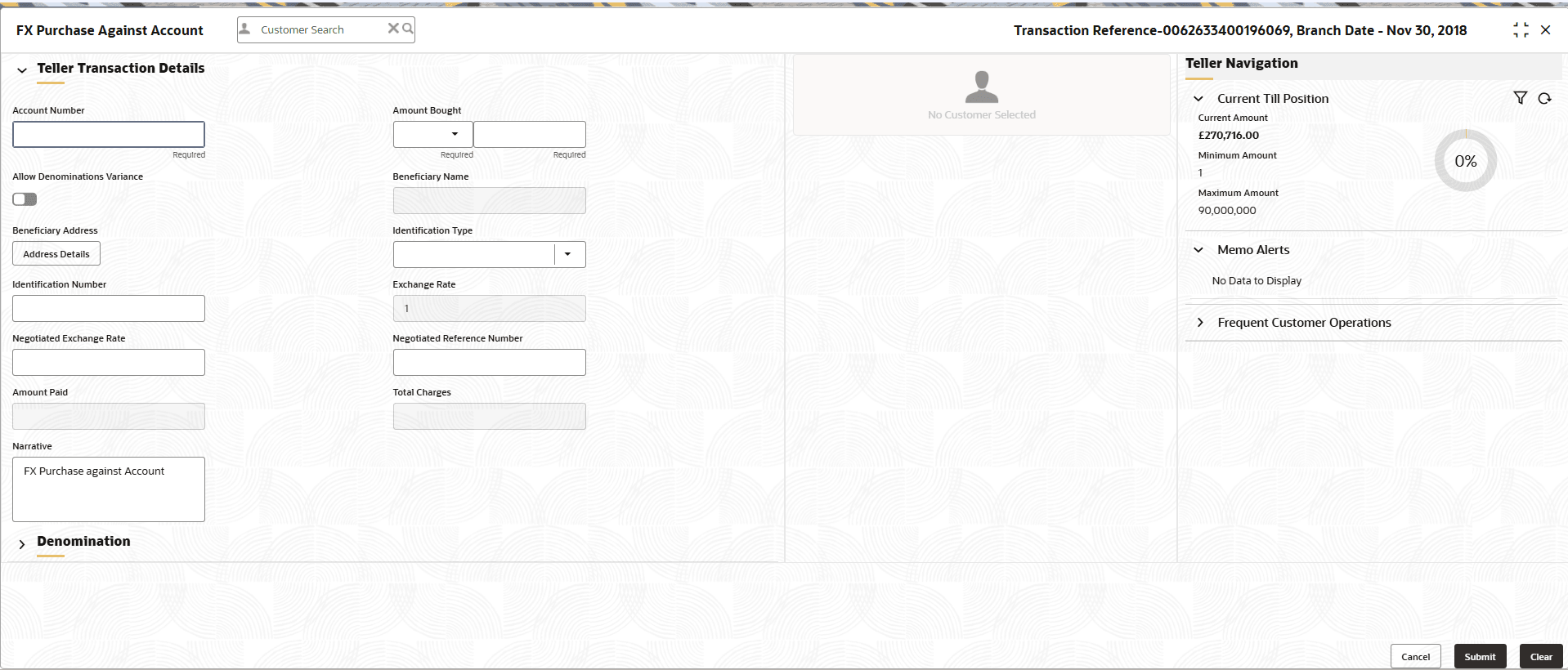

    Figure 4-9 FX Purchase Against Account
  2. On the FX Purchase Against Account screen, specify the fields. For more information on fields, refer to the field description table.

    Table 4-8 FX Purchase Against Account - Field Description
    Field Description
    Account Number
    Specify the CASA account number to be credited for the foreign currency purchase.
    In addition, you can use Oracle Banking Virtual Accounts. These Virtual Accounts are used as a routing account to credit the underlying physical account.
    The system displays an override or error message on the tab out of Account Number based on the account dormancy parameters.
    Amount Bought
    Select the applicable currency from the drop-down list, and specify the amount that needs to be bought from the customer.
    Allow Denom Variance
    Select if the denomination-wise variance needs to be applied for the transaction.
    If the parameter at the function code indicator is set as Y, this option will be selected by default, and it can be modified. If the parameter at function code indicator is set as N, then this option will be disabled.
    Beneficiary Name
    Displays the name of the beneficiary customer based on the account number provided.
    Beneficiary Address
    Click Address Details button to view the customer address details.
    For the field-level description of the customer address, see Address Details.
    Identification Type
    Select the type of identification provided by the customer from the drop-down list.
    Identification Number
    Specify the identification number provided by the customer.
    Exchange Rate
    Displays the exchange rate used to convert the transaction currency into account currency, and it can be modified.
    This field is displayed only if Multi-Currency Configuration at Function Code Indicator level is set as Y.
    Negotiated Exchange Rate
    Specify the negotiated exchange rate that should be used for foreign currency transactions between the treasury and the branch. You need to specify the negotiated exchange rate only when the currencies involved in the transaction are different.
    This field is applicable only if the transaction involves cross currency and only if cross currency enabled and Negotiated_Rate_Enabled Configuration at Function Code Indicator level is set as Y.
    Negotiated Reference Number
    Specify the unique reference number that should be used for negotiation of cost rate, in foreign currency transaction. If you have specified the negotiated cost rate, then you need to specify the negotiated reference number also.
    Accounting system books the online revaluation entries based on the difference in exchange rate between the negotiated exchange rate and transaction rate.
    Amount Paid
    Displays the amount paid and currency to the CASA account.
    The currency of the amount paid is defaulted from the account currency. The Amount Paid will be calculated based on the Amount Bought and the Exchange Rate. This field is displayed only if Multi-Currency Configuration at Function Code Indicator level is set as Y.
    Total Charges
    Displays the total charge amount, which is computed by the system in the local currency of the branch.
    This field is displayed only if Total Charges Configuration at Function Code Indicator level is set as Y.
    Narrative
    Displays the default narrative as FX Purchase Against Account, and it can be modified.
