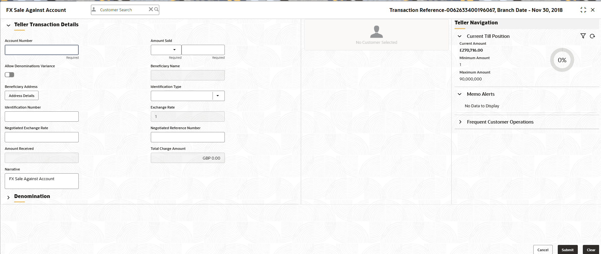

4.4 FX Sale Against Account
The Foreign Exchange (FX) Sale Against Account screen is used to sell the foreign currency from the branch through the CASA account.
This transaction is performed by debiting the corresponding account currency from the CASA account.
To sell the foreign currency against CASA account:
  1. On the Homepage, from Teller mega menu, under Customer Transaction, click FX Sale - Account or specify FX Sale - Account in the search icon bar and select the screen.
    The FX Sale Against Account screen is displayed.
    Figure 4-6 FX Sale Against Account
  2. On the FX Sale Against Account screen, specify the fields. For more information on fields, refer to the field description table.
    The fields marked as Required are mandatory.
