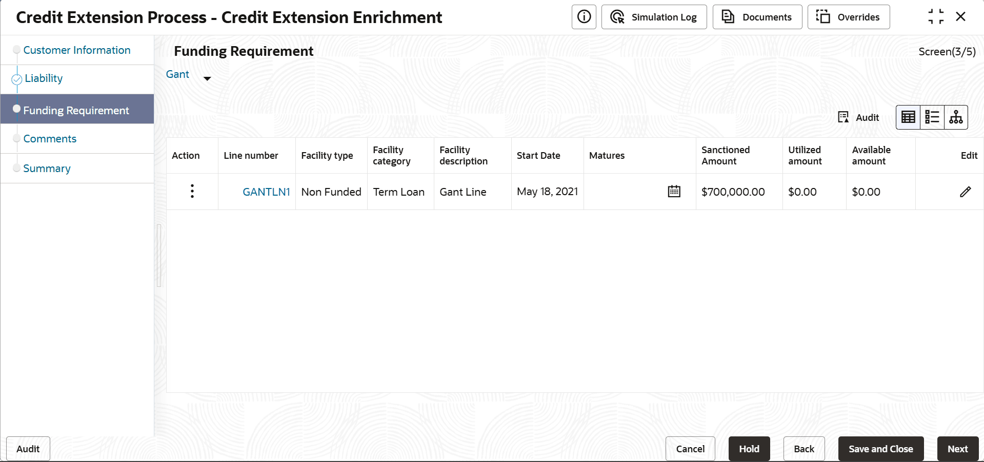

    The Funding Requirement screen displays.
    Figure 4-5 Funding requirement
    Funding requirement
  2. Click the action icon in the required facility record and select Edit.
    The Funding Requirement - Facility Details window is displayed.

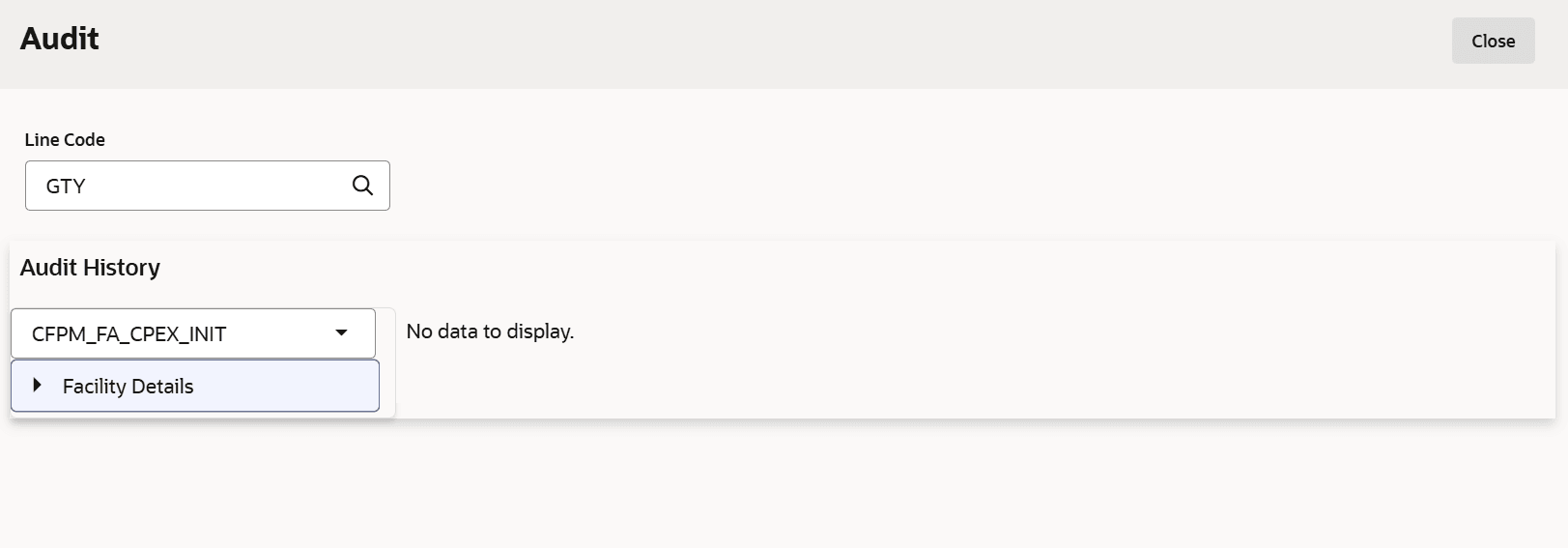

  3. Click Audit.
    The Audit screen displays.
