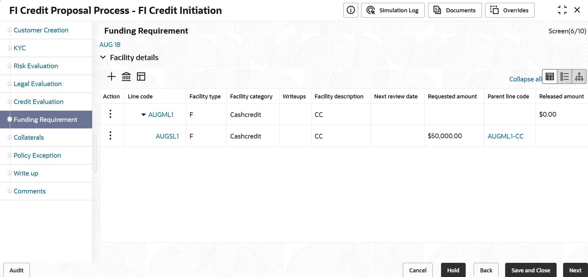

  1. Click Next in the previous data segment to proceed with the next data segment, after successfully capturing the data.
    The Funding Requirement screen displays.
    Figure 3-71 Credit initiation_Funding Requirement
    Description of Figure 3-71 follows
    Description of "Figure 3-71 Credit initiation_Funding Requirement"
  2. Click the action icon in the required facility record and select Edit.
    The Funding Requirement - Facility Details window is displayed.
