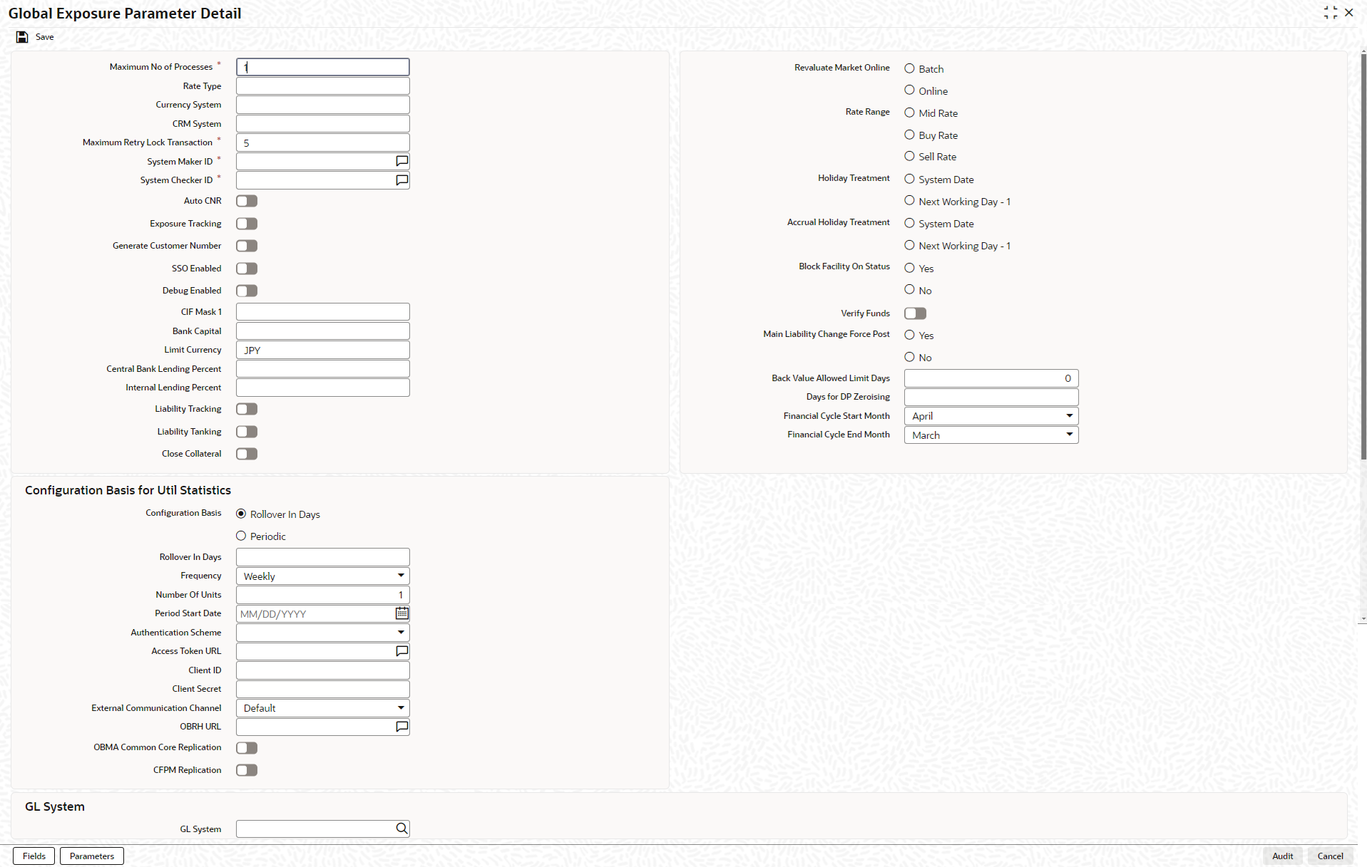

2.23 Global Exposure Parameter Details
This topic describes about the detailed information on global exposure parameter details.
The fields, which are marked with an asterisk, are mandatory.User can specify certain parameters related to the End Of Day operations in the Limits & Collaterals Parameter Details screen.
- On the Home screen, specify
GEDPARAM in the text box and click the
icon.The Global Exposure Parameter Detail screen displays.Figure 2-60 Global Exposure Parameter Detail
- On Global Exposure Parameter Detail screen, click
New and specify the fields.For more information on fields, refer to the field description table.
