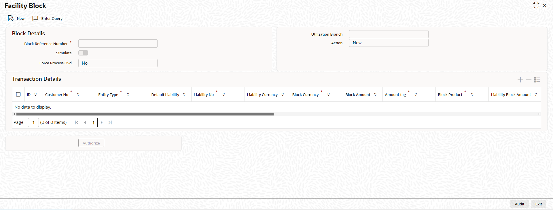

2.4 Facility Block
This topic describes about the information on blocking funds for the facility
Facility block maintenance can also be performed using GEDFBLCK or GEDBLCKS which is a common block maintenance screen for both collateral and facility.Facility Blocking
During block transaction, non-revolving facilities will act as revolving facilities.Note:
The fields, which are marked with an asterisk, are mandatory.- On the Home screen, specify
GEDFBLCK in the text box and click the
icon.The Facility Block screen is displayed. - On Facility Block screen, click
New and specify the fields.For more information on fields, refer to the field description table.
Table 2-117 Facility Block - Field Description
Field Description Block Reference Number Specify the unique number which is to be assigned for every block to be created. Simulate Switch to
to indicate that the details for the
transaction being entered should be used only for
simulation and not stored permanently within the system.

Force Process Ovd Displays whether transaction should ignore the overrides occurred in the process or not. Utilization Branch Branch code is displayed here. It indicates the transaction branch code. Action During new block, you can perform below mentioned operations for the entities (liability, facility, and collateral pool). The available options are: - New Block

Transaction Details Specify the fields under this section. ID Indicates the transaction ID. Customer No Click the
icon and select the customer number from the list.
